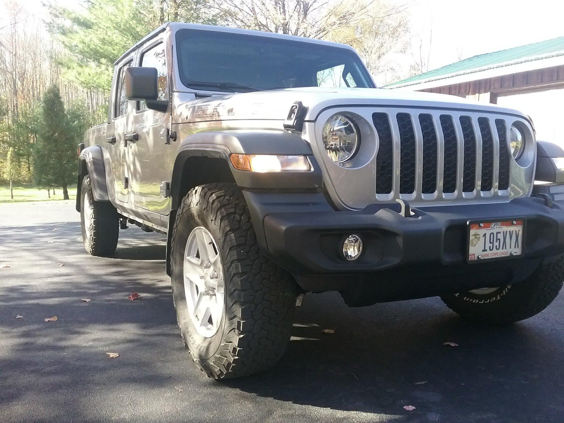

I never brought this up here about me buying wheels that would not fit. I felt like an ass when I took them in to have tires put on and was told. To the credit of my dealer, the guy knew by looking at them as soon as I handed them to him. They have been selling Jeeps for years and I'm the newbee with my fist Jeep. I assumed everyone here knew thus me not saying anything. The things that I did check was the wheel size, rim width and offset and they were the same as my original wheels.
Jeep Gladiator Almost Lost My Rear Wheel Today Resized_20191023_144307_841
