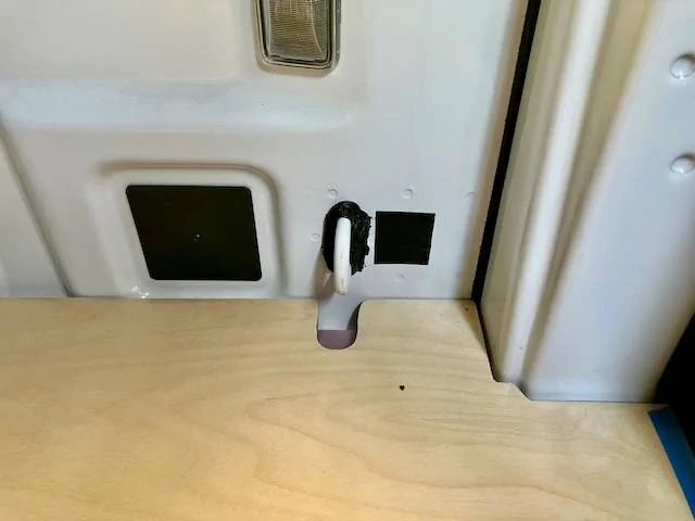

You could take a Forstner bit to the back of the plywood and drill out a small indention where each of the bolts come through the door and that would still let you put your plywood flat against the door frame and it would hide the bolts.
Given that I'm planning very thin plywood, I might as well cut a hole there ... but I'll use that technique in other places (e.g. rear seat delete storage platform) to create a flat surface even though there are bolts in quite a few places. It's easier with the thicker plywood there (12mm Baltic Birch). As a sidenote: a wood router is a wonderful tool that creates just as much work as it saves time ... I do a ton more complicated things now that I would have improvised otherwise, so I end up taking the same time, but have a nicer result ...

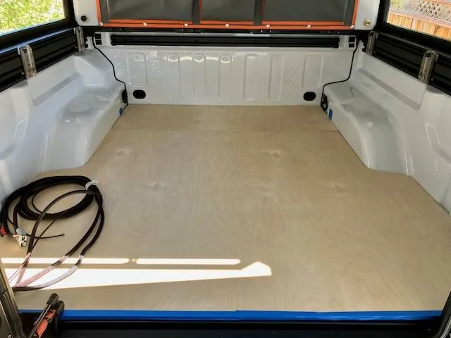

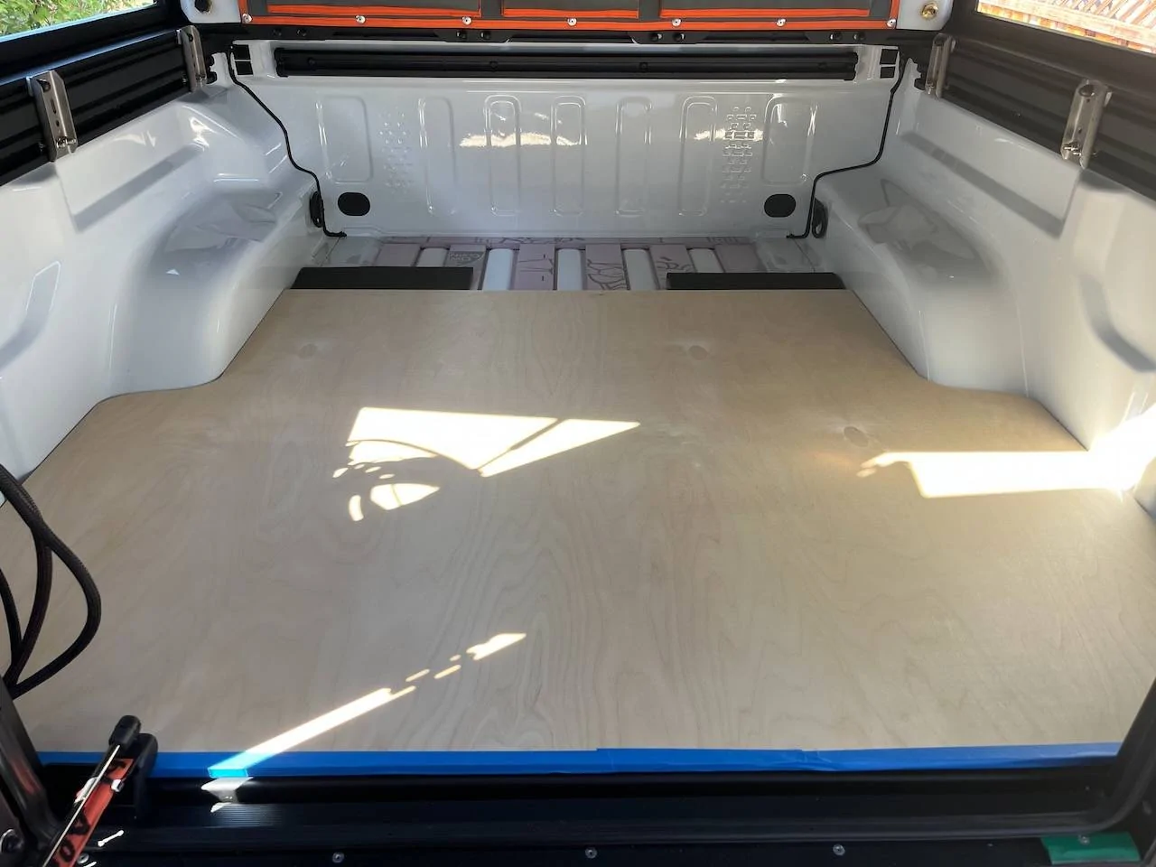

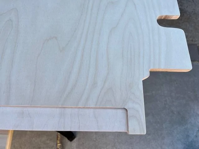

Oh, and that reminds me:
If someone needs the template for a fitted bed plate, ping me. We are doing the wood sealing right now, so the plates are out and easy to measure and document what we've done to fit them. Need to document the measurements anyways just in case I ever need to build another one ...
This could save a lot of time and a few times of taking the plate in and out ...
I'd love to have a copy of your template if you are sharing!
Message sent, please sanity check first. It does fit into OUR truck with OUR prep work (as can be kind of seen in the picture below, where you can see some of the pink foam board, as well as little bit of the EVA foam). So, be aware ...

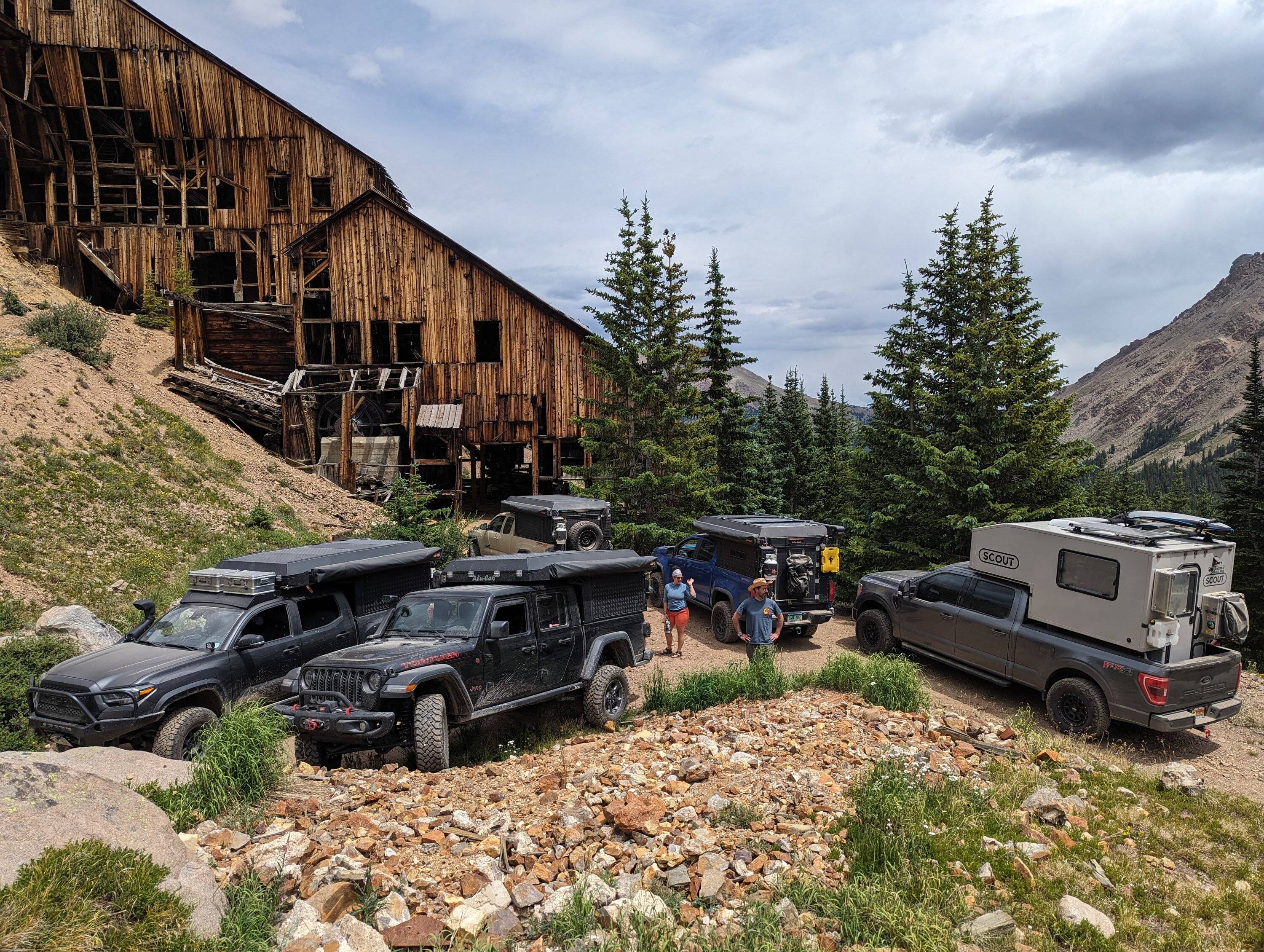

I just thought I would share some pics from our camping trip a few weekends ago. My shop, Juniper Overland, invited a bunch of their customers out to Loveland for a weekend trip. They took care of everything and it was a great weekend.
There were 7 trucks with Alu-Cabs/Cabins and 3 Scout Campers, along with some RTTs. We were the only Jeep among Tundras, Tacomas, & a Chevy ZR2. We wheeled on Saturday doing the Halfmoon trail.
On Sunday we had Ariana from Trails Offroad speak about their app.
What a great event put on by Juniper.
