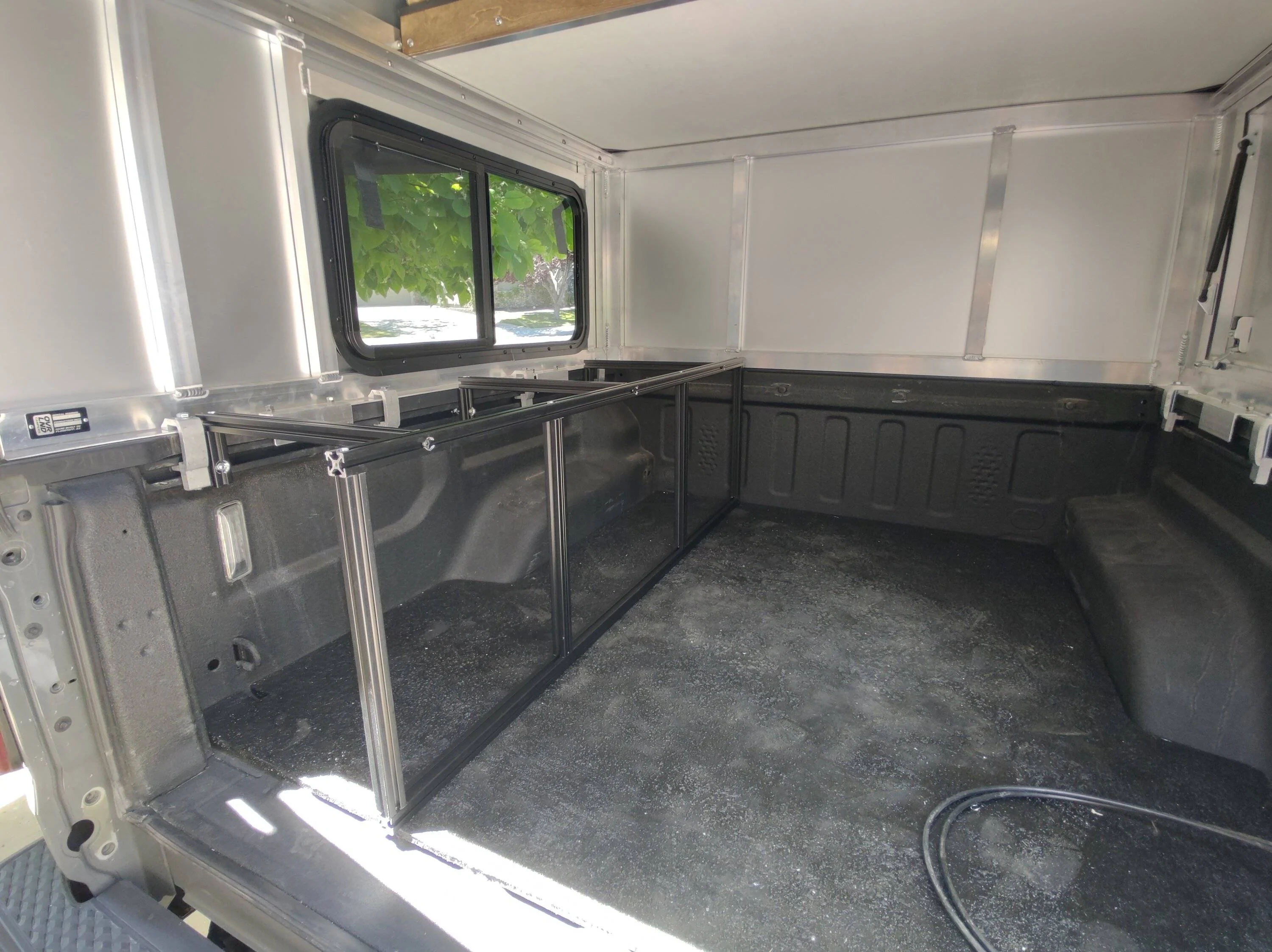

I'm looking into some thermal insulation and then putting a marine grade plywood sheet on top of that. Now I'm thinking about whether to fill the "lower" areas of the bed, they are about 12mm (1/2") lower than the "higher" areas (How do you call that? Corrugated?). Worth it? Overkill? At this point I think it might just be overkill. Maybe I'll put an extra layer of insulation foam into the "valley" and the plywood with a thinner insulation attached to it on top. I don't want it to become squishy since I want to attach the rest of the furniture to it, but I also don't want to overhink/overdue it.

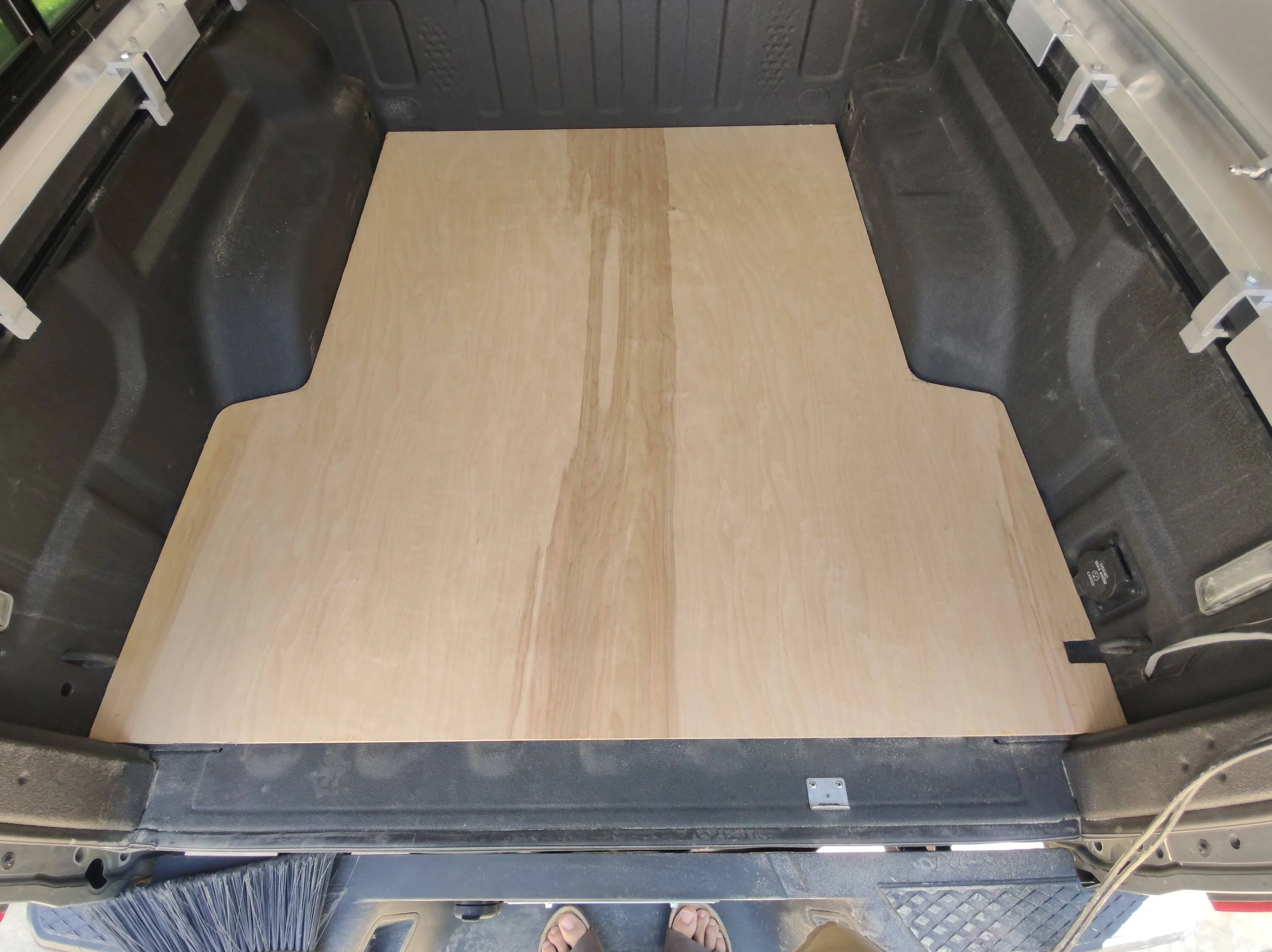

Not an ACC. But what I did. Then put herculiner on both sides. 15/32 Baltic birch. Hard to find not cheap. Going to end up with some sort of cushioning on the wood and a saddle blanket or indoor outdoor carpet.
Looks good to me! I was thinking either 12mm Baltic Birch or Marine Grade Ply (they are similar from what I understand, haven't used either so far, I'm more familiar with the plywood that is used to build flight cases for music and technical equipment in Europe).
I was planning to put some insulation underneath. Probably first fill the "corrugations" with some lightweight material, then add some simple adhesive foam insulation, probaly just 3/8 or so, then add the plywood and finish it with some kind of vinyl flooring. Bolt it all down from the sides. Build simple furniture on top and bolt to base and sides. I'm likely not using 8020 for weight reasons, even though it is so amazingly simple to work with.
