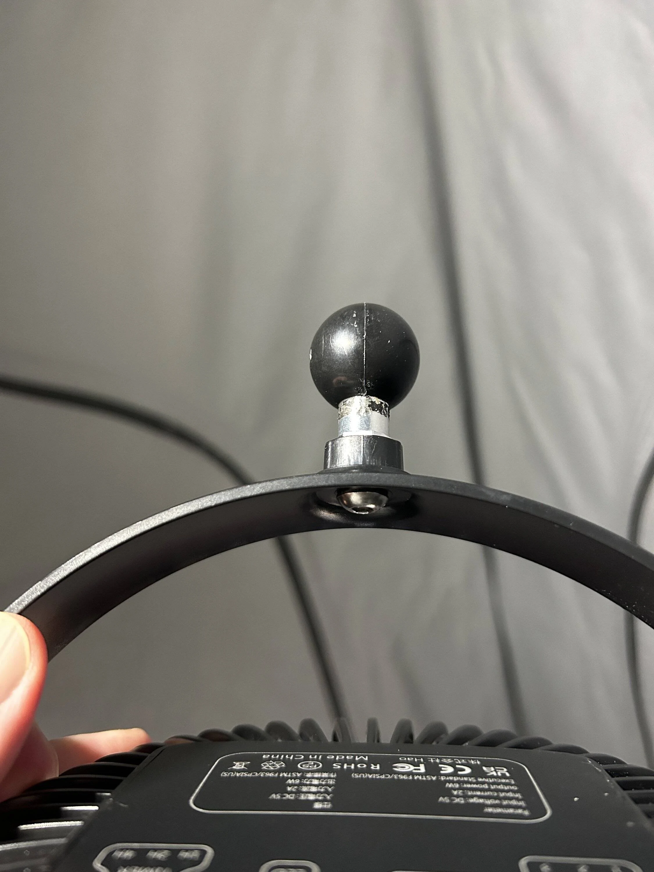

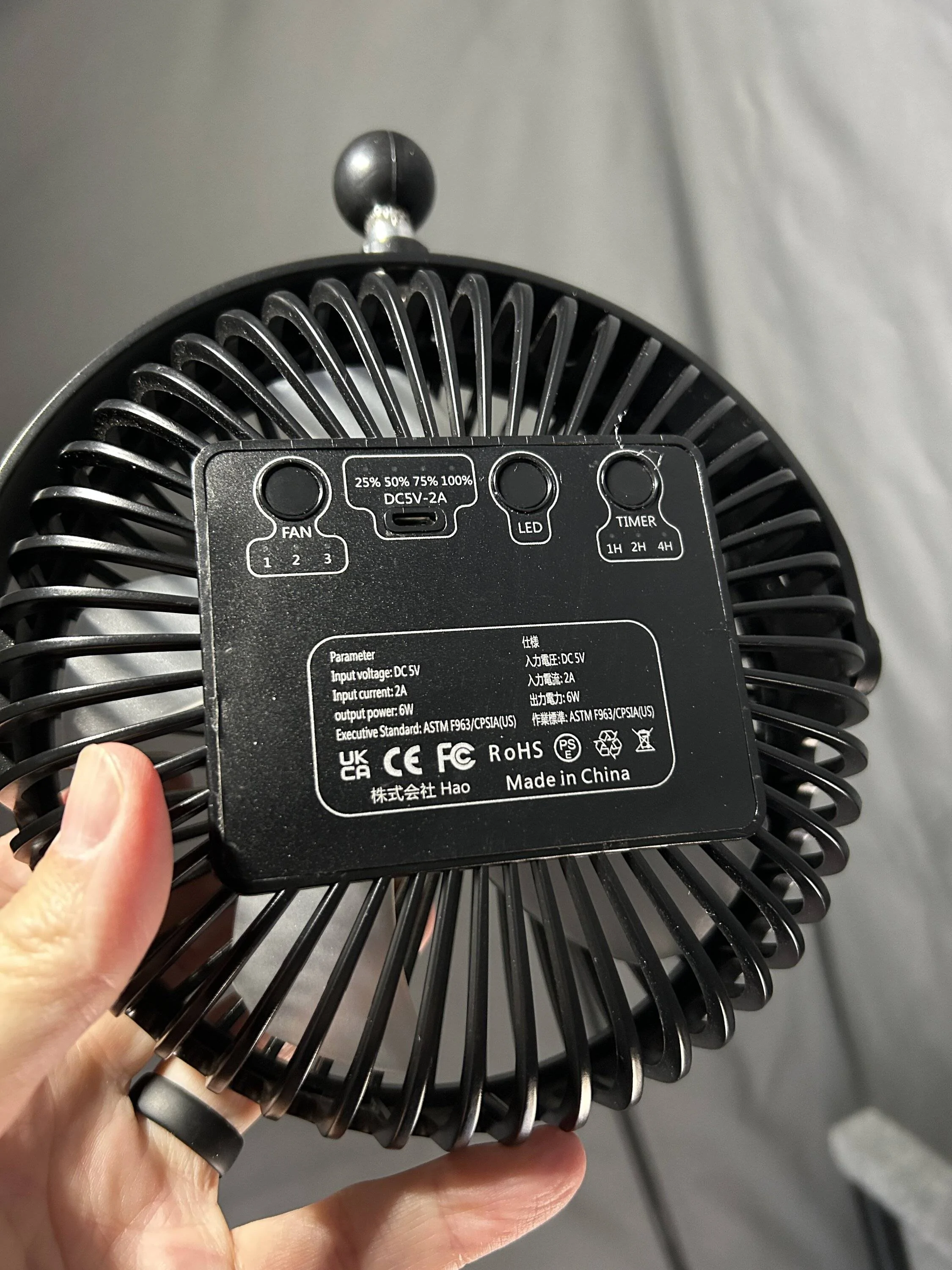

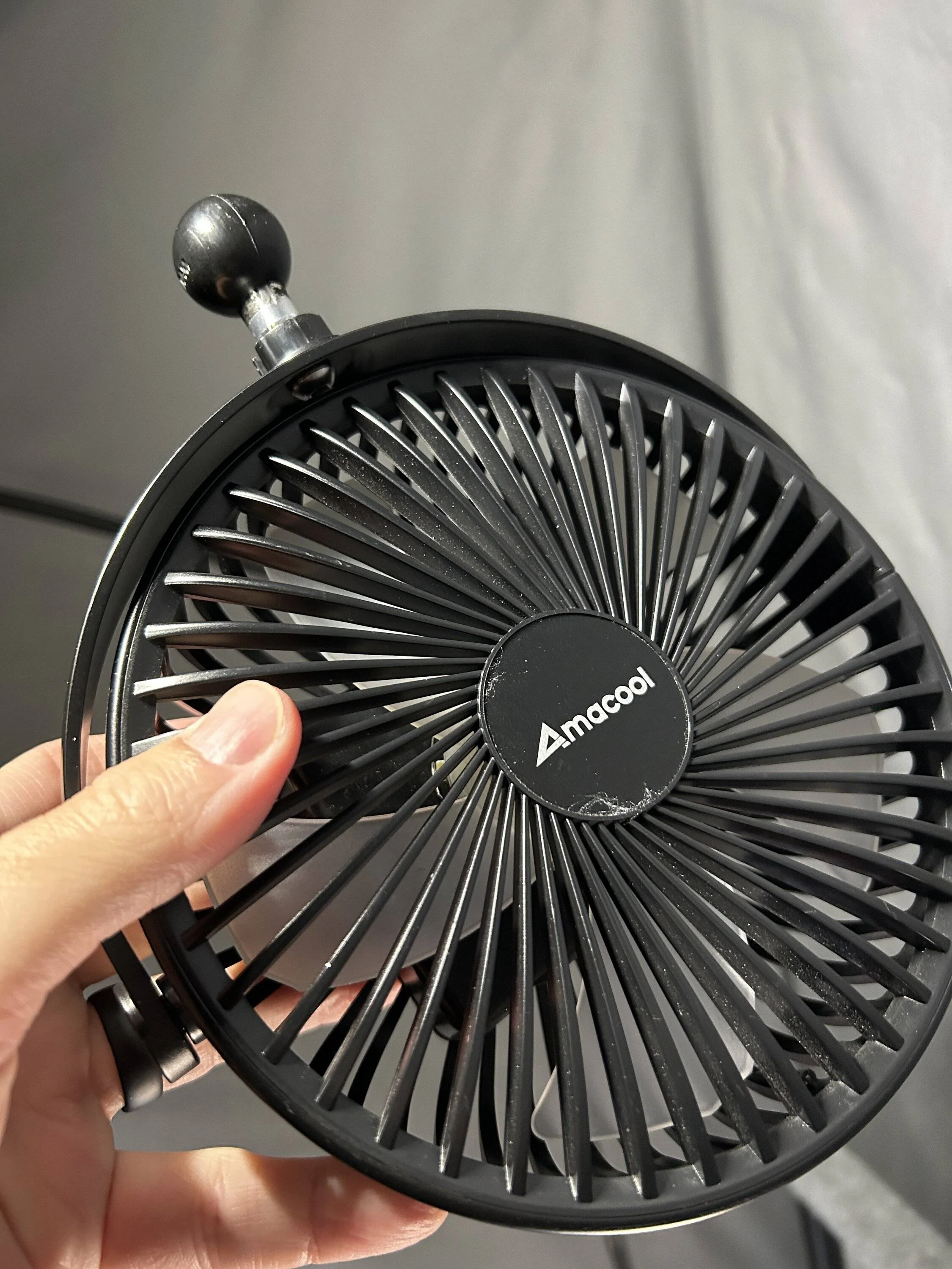

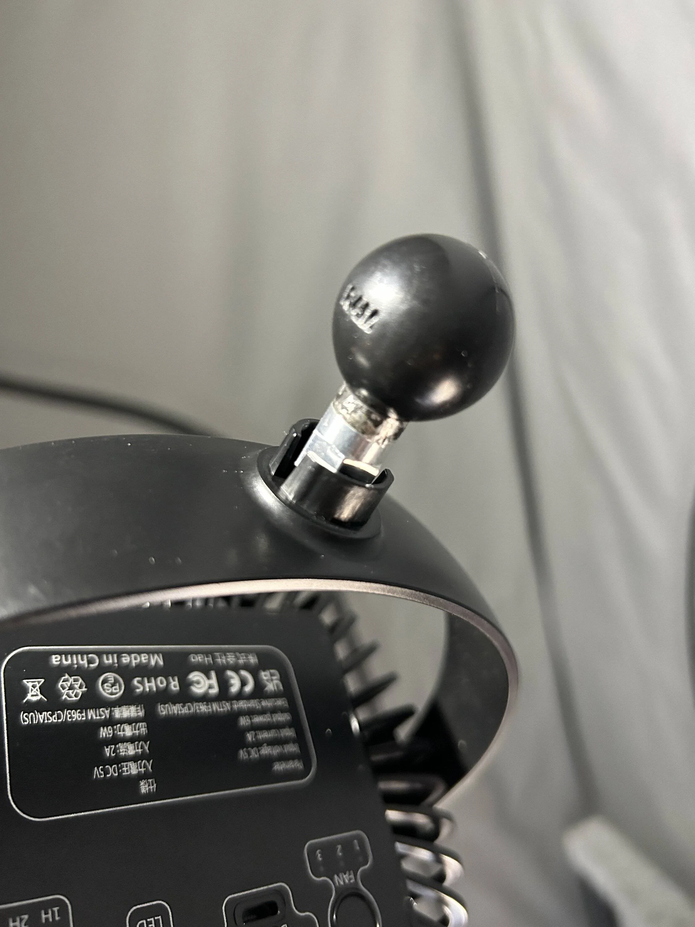

@813 Fabrication & Design would you mind linking to the fan you purchased? I see a few options and I'm concerned about what it will take to properly attach a mounting ball to the fan. Thanks!
Here are a few photos of my fan setup
10000mAh 7 inch Battery Operated Clip on Fan Rotatable USB Fan for Baby Stroller Outdoor Camping Tent Beach Treadmill Car Golf Cart https://a.co/d/5PHymHZ
The bracket fits on all of the National Luna mounts in the camper

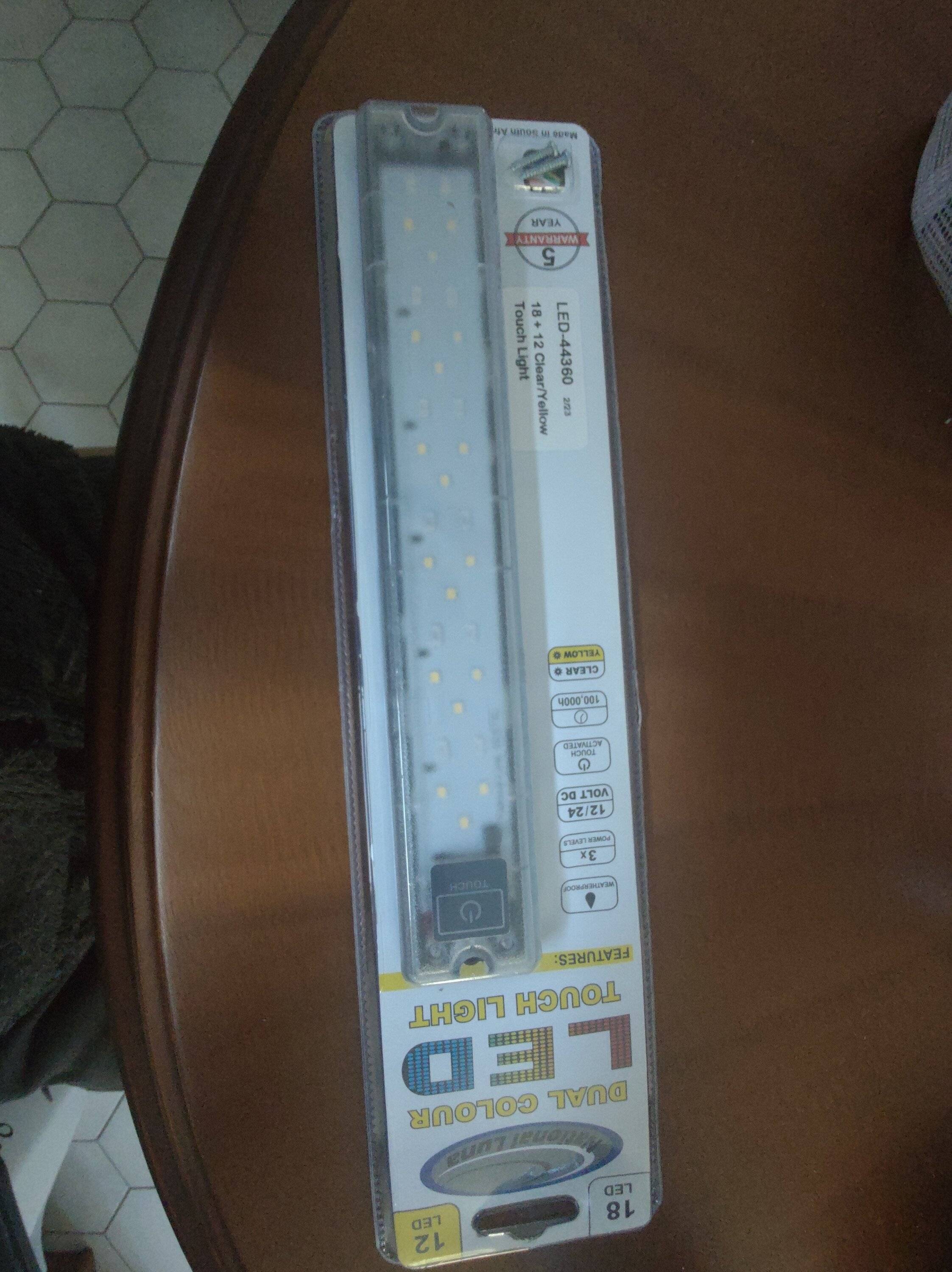

The factory lights in the Alu-Cab are National Luna, so every light in the camper ?
Except I don't run the ACCC. This is the light I have.
Thanks a bunch for the detailed photos... very helpful!
Oh, gotcha. The National Luna light sits on a bracket, stuck to it with double side tape. The mount I have attaches to that bracket, not the light

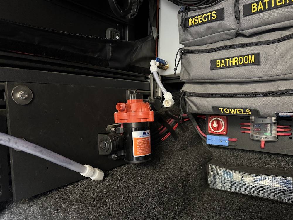

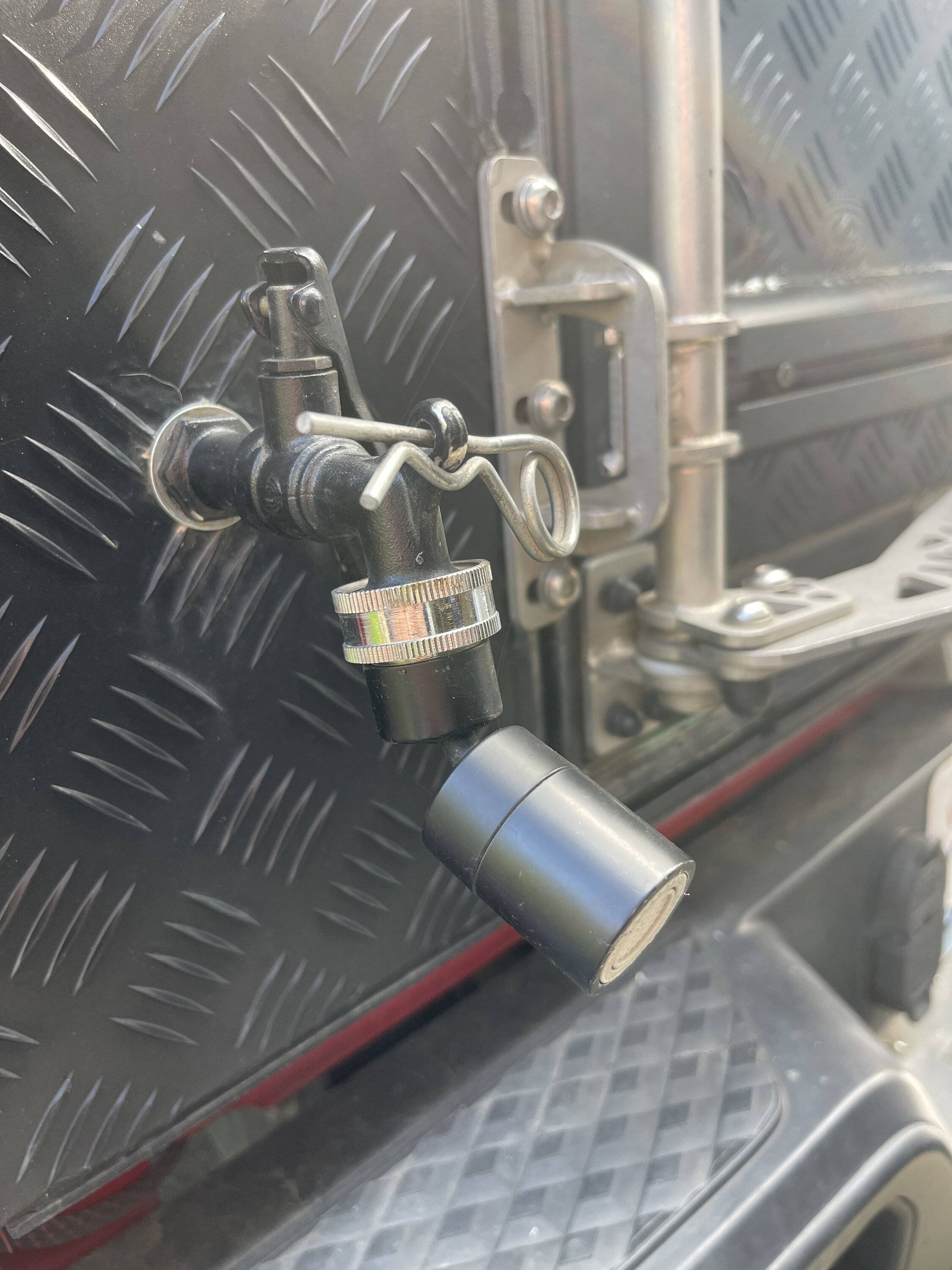

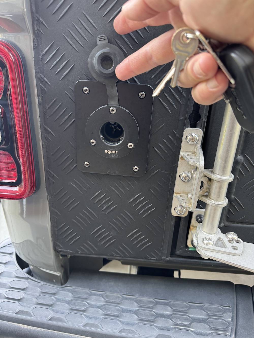

Here are a few install photos. I use an aquor house hydrant at the rear for a clean external appearance. Pump is mounted on a piece of starboard (basically colorized plastic cutting board material) and an inline shutoff at the tank. Pipes are currently disconnected as it's getting quite cold here.

I really like the clean install! Nice work! What kind of carpet/insulation did you use there if I may ask? Insulation is still a mostly unsolved problem in our build.
Thanks, appreciate it. Works great for us. The carpet is a product called bedrug, there are versions that cover just the floor of the bed as well as the bed sides. It doesn't officially advertise an r-value, but from experience it is way more comfortable on your feet than other options I've seen.
