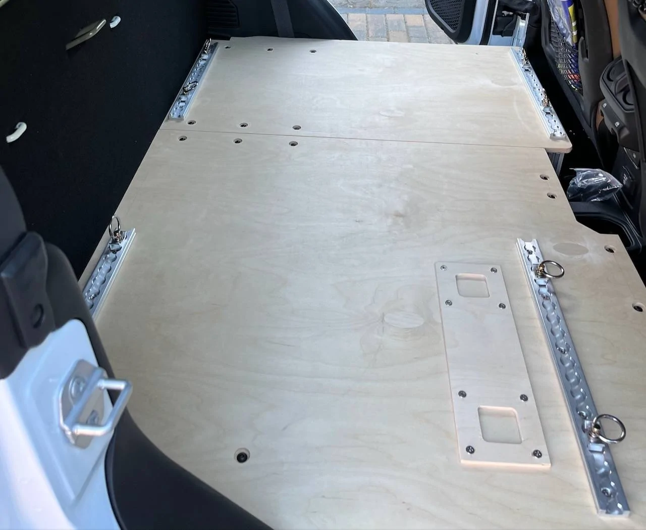

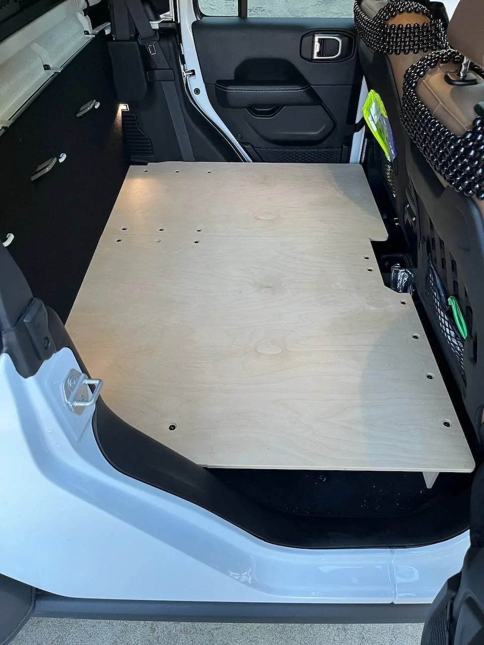

Background is, I'm looking at building a seat delete platform and doing something other than plywood for weight savings
I'm not sure it's worth the effort going to exotic (and expensive) materials. Our platform (both sides together) is around 16.5kg or around 36.4lbs.
We could have saved more weight by going with a low platform and no tracks, that would have made the minimum weight about 13.2kg (~29lbs)
This is the pure platform:
Jeep Gladiator Alu-Cab Canopy Camper Roll Call img_5787-jpeg

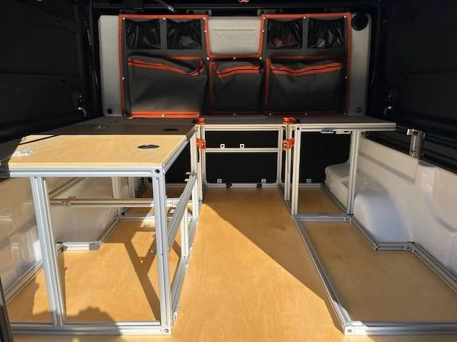

We added some stuff to make it work for us:
Jeep Gladiator Alu-Cab Canopy Camper Roll Call img_5836-jpeg
I'm not sure how much you can realistically save if you build a platform with at least some usable space underneath, since brackets and "legs" and fasteners make up a good amount of the total weight.
The wood only is just under 9kg or 20lbs for 12mm baltic birch or similar 1/2" marine grade plywood. So, again, how much do you think you can realistically save? And is that worth the additional effort in sourcing material and the potential other issues with that?
