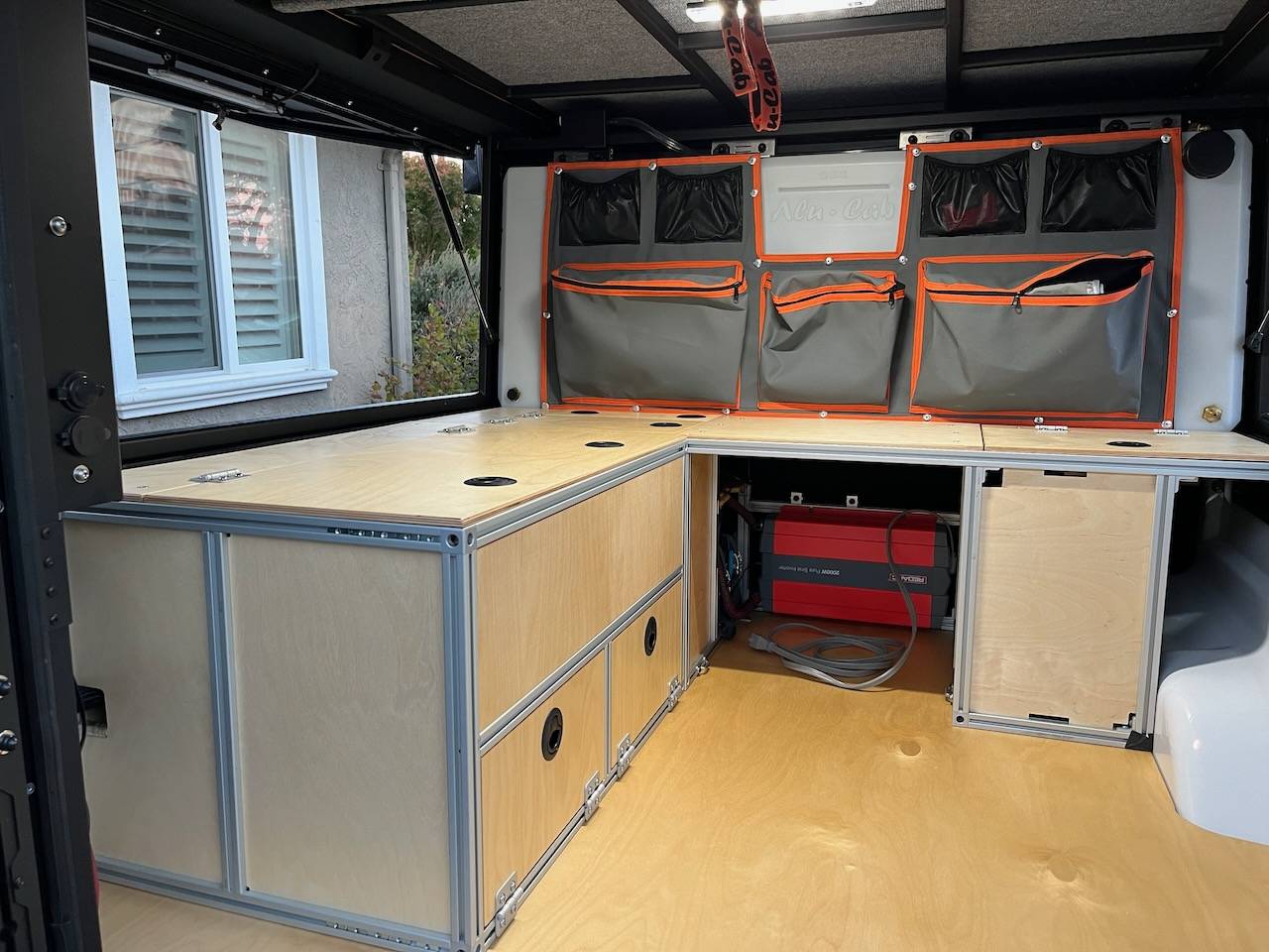

So, part one of the interior build is done.
Jeep Gladiator Alu-Cab Canopy Camper Roll Call IMG_5927
Jeep Gladiator Alu-Cab Canopy Camper Roll Call IMG_5994
Part two will be water hook-up and passenger side furniture unit. But first is some testing and then some time in Europe. So not much will happen on this in the next two to three months.

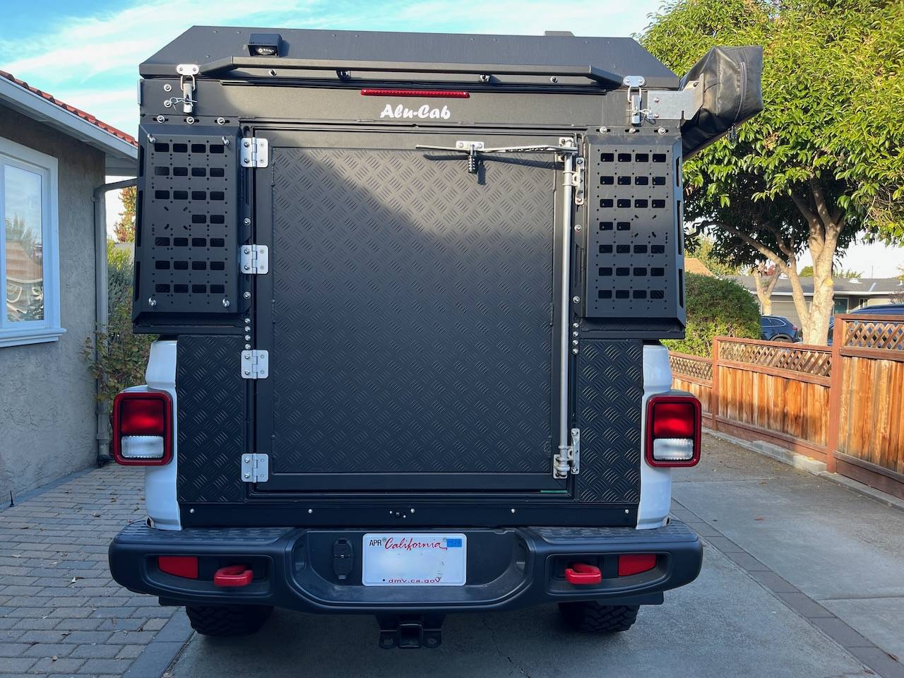

Installed the @813 Fabrication & Design Camera holder and filler plate:
Jeep Gladiator Alu-Cab Canopy Camper Roll Call IMG_6012
The Canopy Camper fit kit should actually come with this for the Gladiator. It's easy to install, I used the cable that I took out of the tail gate harness, it works great. After removing the guide lines in the camera settings there are also no confusing lines.
Great product, highly recommended to give the Canopy Camper a finished look.

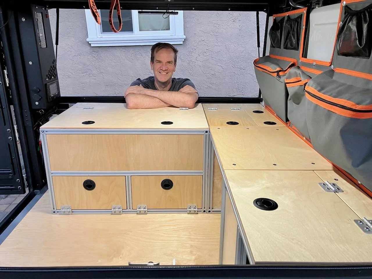

Just in case anyone is wondering about the weight of the furniture:
What can be seen in the picture is 36.5kg (~80lbs) plus the bedplate. Not including any content, like batteries, other electrics or so.
It's not super light, but a comparison to Goose Gear or even to putting the same packed volume in via Zarges cases or such isn't all that bad. Given the information I have on Goose Gear [1], my furniture setup will be lighter overall, even though it packs more volume. It's about 10 to 20% heavier than simple storage cases though, and if you really want to save weight, there are lots of ways to do so.
So, it isn't as bad as I feared it would be given the complexity of the furniture.

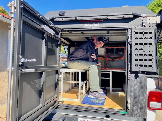

It certainly won't make it very comfortable if it is possible at all, that is true. It does work in our Land Cruiser with FiftyTen cabin, mainly because the bed platform does not have the extension like in the Alucab. Without that, it should be possible.
This is me on 450mm furniture:
Jeep Gladiator Alu-Cab Canopy Camper Roll Call IMG_5896
So, given that the toilet is about 70mm (~3 inches) lower, it seems possible in a pinch, but not comfortable.
