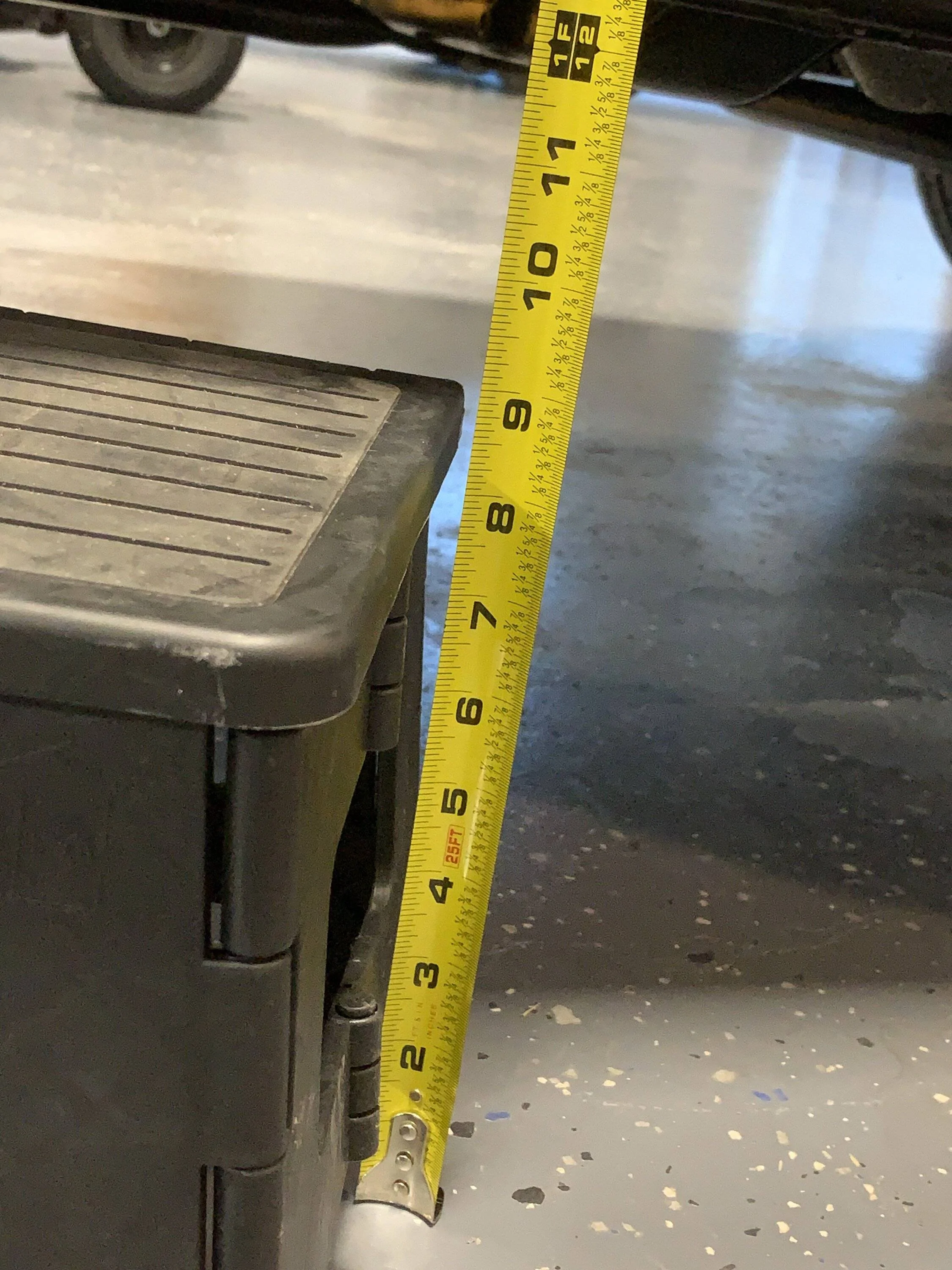

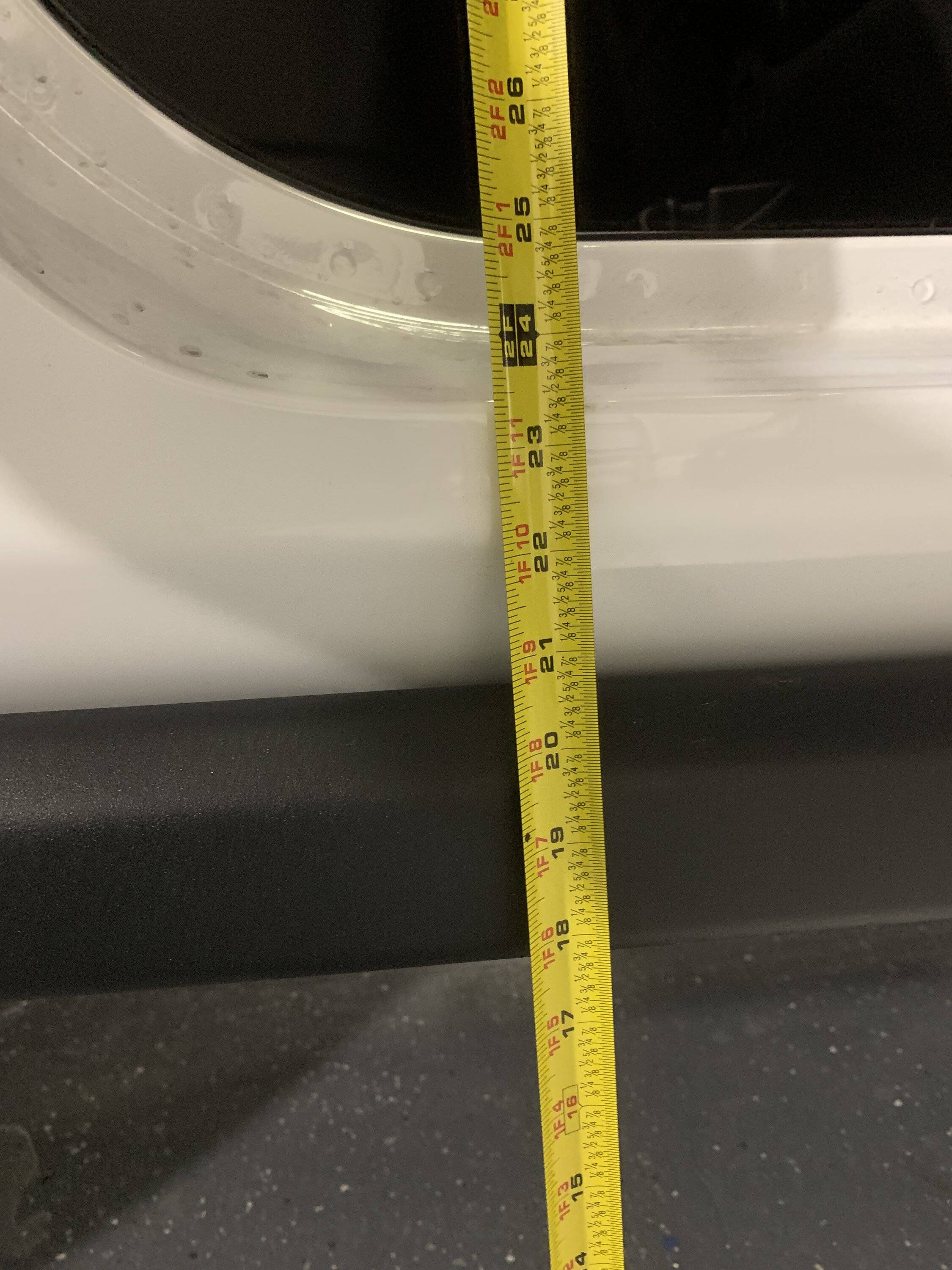

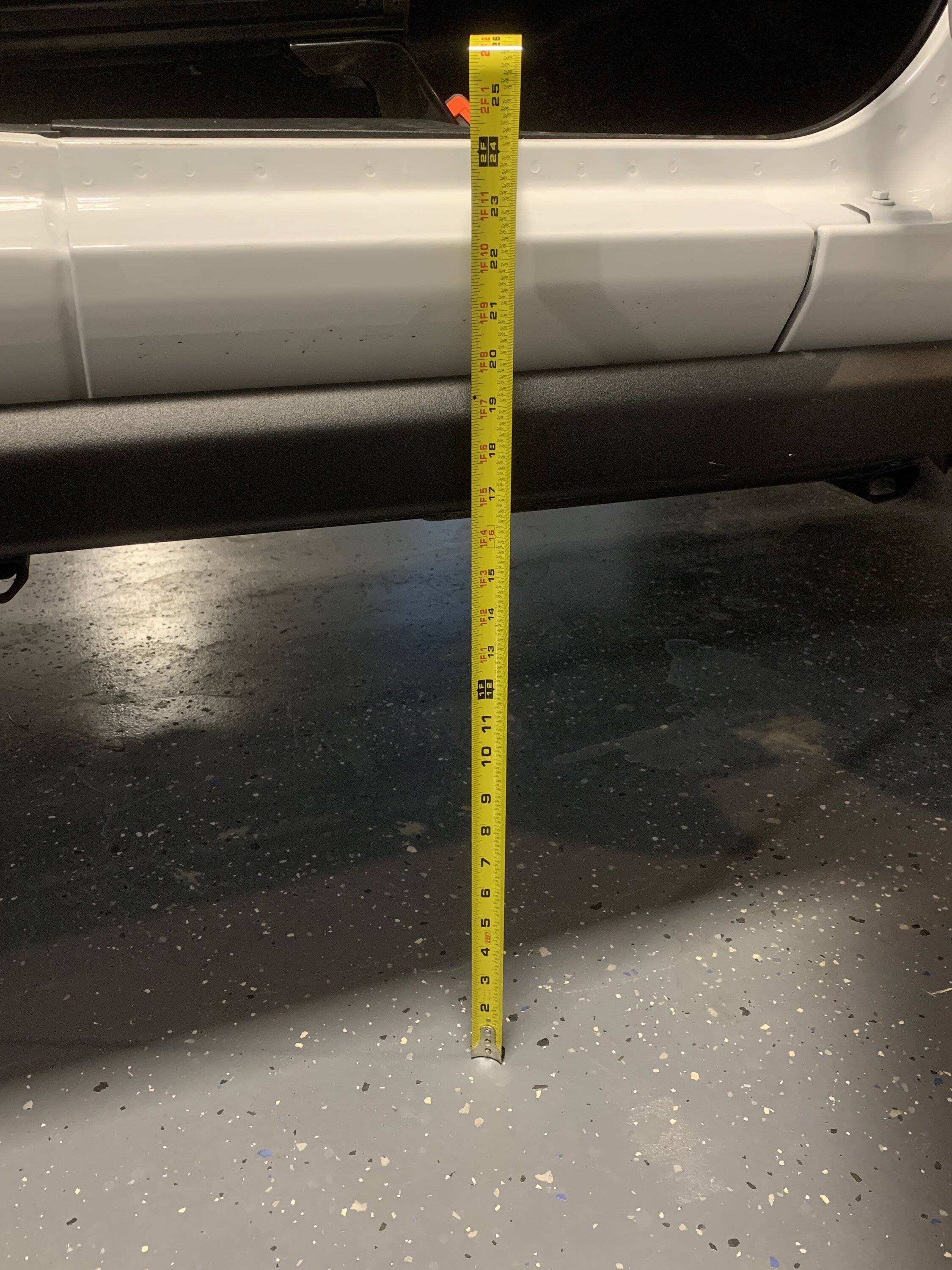

If I’m looking at the measurement correctly, the XL might still work. When I measure the hight of the front door sill, it measures right at 23 inches. The rear passenger door measures right at 24 inches. If it drops 13.25 inches from the door sill, that’s still 10 inches off the ground front, 11 inches rear. I currently place an 8.25 inch step from Harbor Freight on the ground for getting in.
I’ve attached photos to confirm my thoughts. What do you guys think?
First Photo- Front Door Sill
2nd Photo - Rear Door Sill
3rd Photo - Harbor Freight Step
