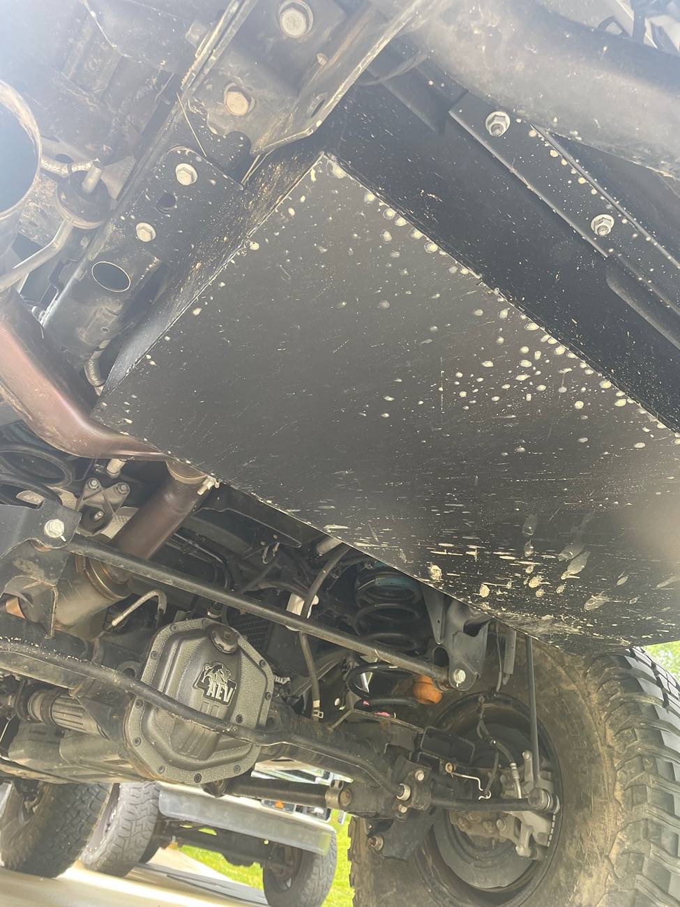

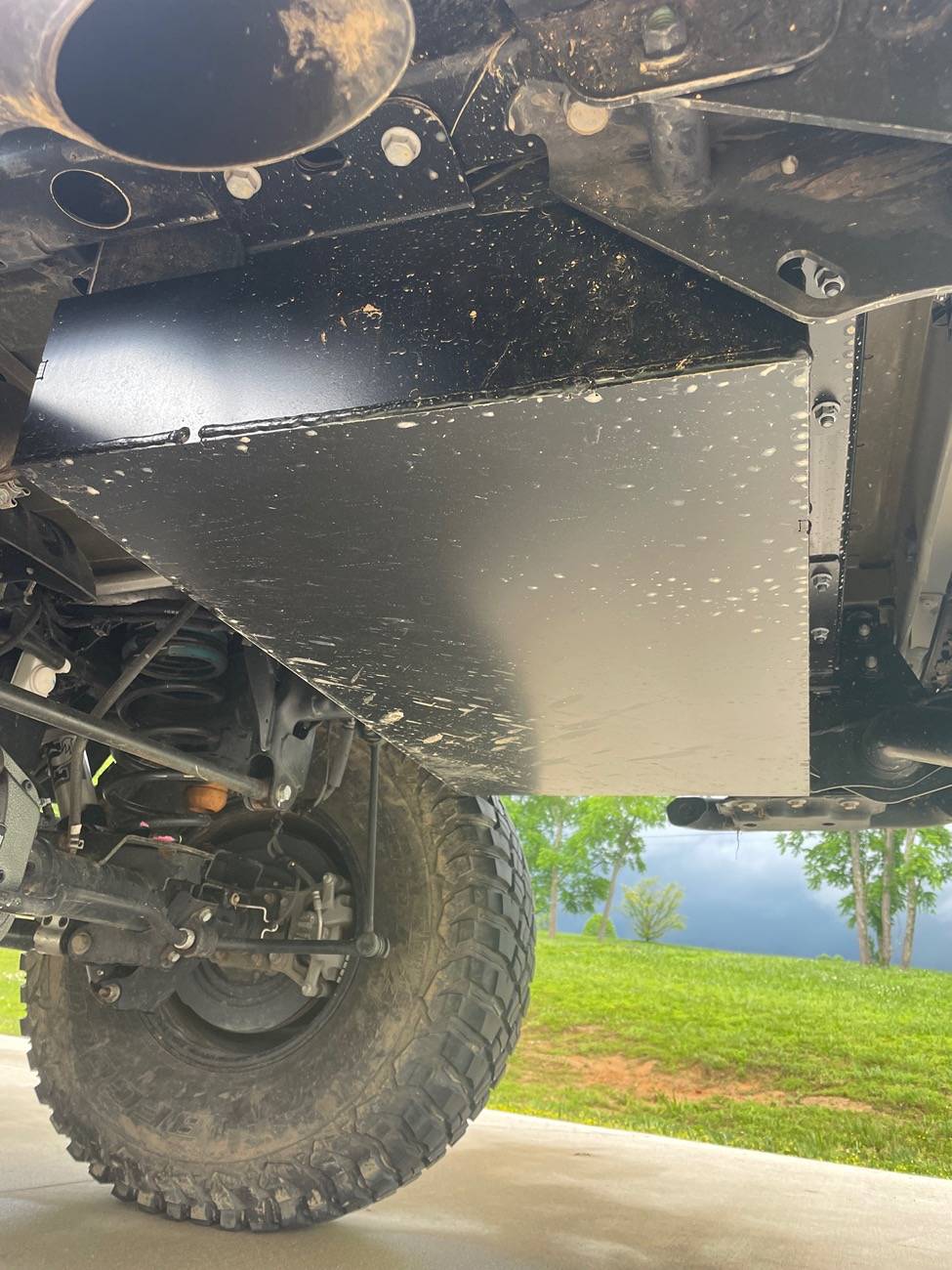

Curious about that 25 gal gas tank. Did it go in place of the spare tire? If so, what did you do with the spare? Throw or mount it in the bed? I have a 5.7 Hemi and a larger tank would sure be nice. Got some pictures of the tank?
Spare tire is sitting in my garage atm. I am running 39’s, have 40s waiting to go on and a 37” spare bc that was biggest that would fit just to get out of a jam. I do have onboard air and, patch kits, and sidewall repair kits at all times. Not sure what the best route is tbh?! Don’t want to take up bed space with a full size spare, and otoh, in 20+ years of jeeping, I’ve needed a spare tire once, and wasn’t even off road at the time.
Fits good. Does it stick down about as far as the 37 did when it was in that spot? One last question, is that in an addition to the stock tank? I am assuming it is but just checking. Oh, transfer pump or plumbed in to fuel lines?

I’ll take a pic when I get home, but I think the spare hung down further. Yes, ties in with oem tank and filler. Has a transfer pump. Takes about 12 minutes to fill stock tank from empty, and can be done while driving.

Awesome, thanks for answering. Sounds to be a good setup. Just unsure about the spare.
