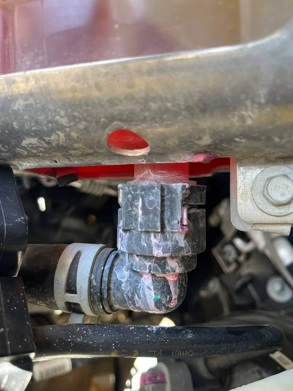

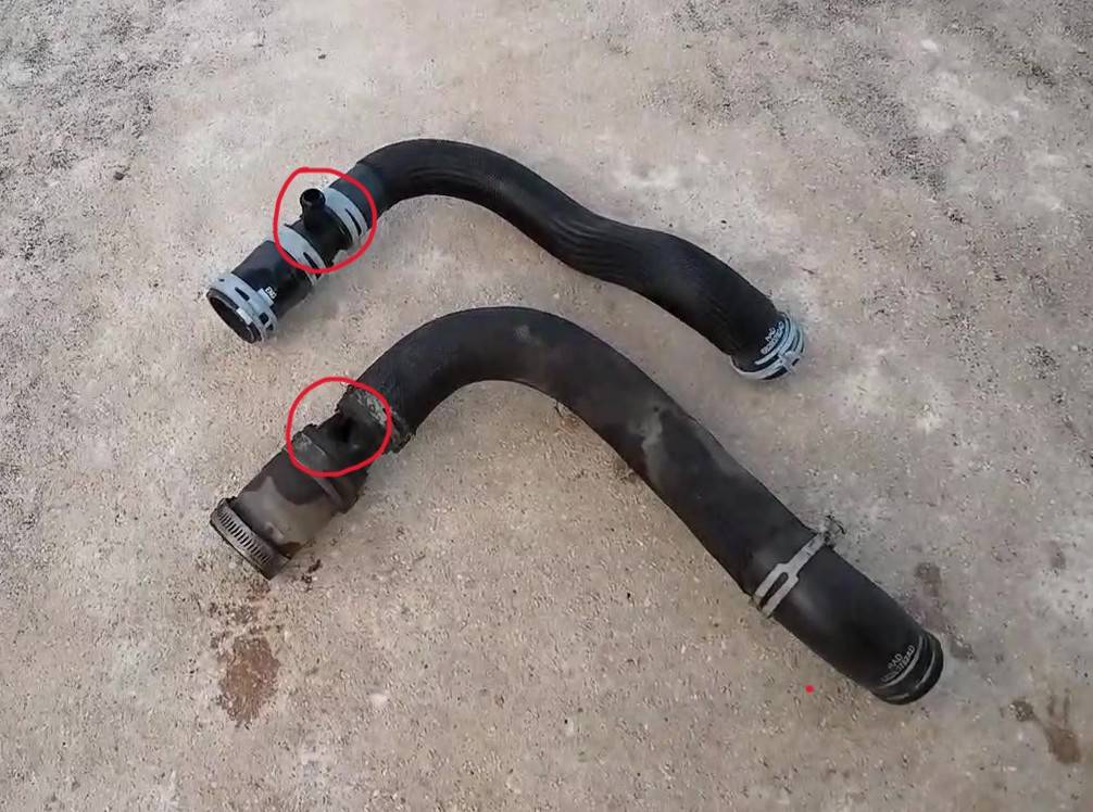

I have 188K on my JT. I've had two coolant leaks in that time. Let me preface by saying that my JT gets beat on by rock crawling and towing regularly. It puts in work.
1. At 144K I replaced the coolant reservoir. It was broken underneath where it was hard to see. I bought another reservoir and the problem was fixed.
2. At 177K, I had a coolant hose leak. I had to buy all three hoses. And it was at my friend's shop when they noticed the leak. As soon as I touched the hoses to remove them from the jeep, they crumbled in my hands. But.... that was at 177K. If you take it to the dealer and it's the hoses, don't be alarmed when they charge you for three hoses. The hoses are in three sections. And they were a dealer only part at the time. I think I paid around $150 for all three.
Just a couple things that it MIGHT be. Hope you get yours fixed.

This is where my leak was. It only took me a year to find it! It was the O ring that wore out.
You got lucky. Mine was completely broken at that spot. But... A new reservoir was only around $40 and it only took about 30 minutes to replace. And I was watching TV. Lol
