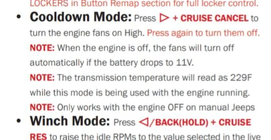

The Tazer allows you to turn the radiator fan on its highest speed, and only its highest speed, simply by pressing two buttons on the steering wheel. There is no setting to change or configure; it's available by default. I use this feature frequently, as it will drop my running coolant temp from 215° or higher to 185° in about two minutes. Then I turn it off again until I need it again.

Which two buttons? Both my Jeeps are ¨Tazed¨ and this is a great feature!

Interesting that it only works with the engine off on manual Jeeps. No biggie. My Gladiator tends to run a little warmer than my JL, anyway.
Great feature! Thanks! I knew it had this but did not know how to activate it.

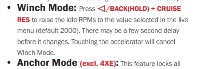

I know you can also increase RPM while winching, too. Gotta look that one up, too.
40,493
54,047
I use JSCAN for that - but the downside is that you have to have the bypass cable in place, the BT adapter, and your phone handy.
On the left side of the wheel, the arrow that points right. On the right, the cruise control cancel button. It works by tricking the vehicle into thinking the transmission temperature is spiking, so you'll see that shoot up, but it isn't actually happening. Go back to the indicator for coolant temp and you'll see it drop quickly.
