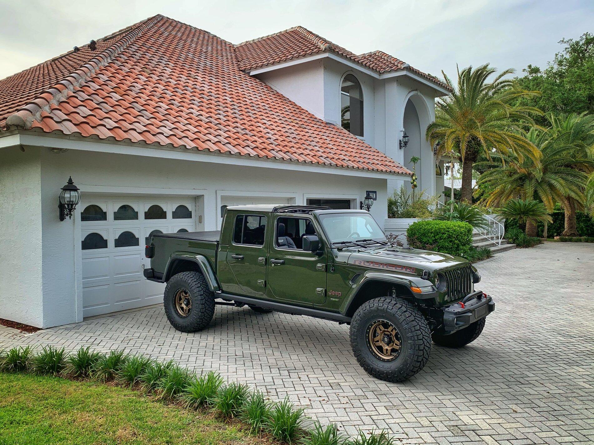

I just sold my 2020 Gladiator. In nov of 2019 I installed the RIPP which was one of the first ones out in the wild. I had a local performance shop do it. I put 35k miles on it. I did get decent power but at a cost. Had issues with original tune and blew smoke out exhaust when I accelerated. It drove me nuts. Also figured out the hard way that the transmission relearns and overrides tunes which sucks for shift intervals. Also did well to get 12mpg. Horrible. I took it back to my shop too many times until I just couldn’t stand it any more. I loved it up front until I just couldn’t anymore. I just got rid of it and ordered a new sarge green Rubi with ecodiesel which I had in a grand Cherokee a few years back. I lifted it immediately and put my 37s on. I absolutely love it. All the power I need and average 20mpg.
