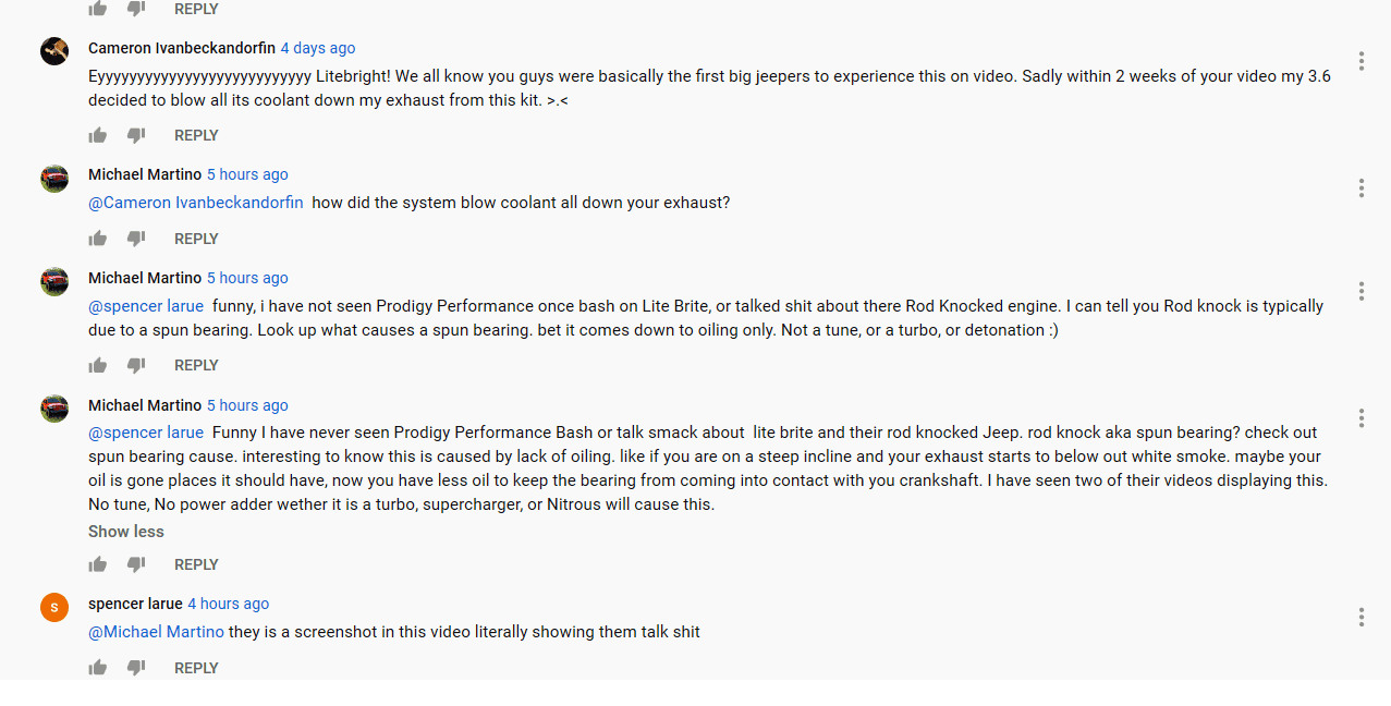

the issue was rod knock
Rod knock is caused by a severe failure of one or more crankshaft connecting rod bearings. Repairs require engine removal and complete disassembly at significant expense. The most common cause is lack of engine oil, this is usually the first part in an engine to fail when it runs out of oil
funny that has nothing to do with the tune or the product.. this is the type of crap people do not see between the lines.
those litebrite clowns Sid and Poundcake are completely full of crap.. I got to see some of the emails from prodigy to litebrite.. they claim they are broke and yada yada yada, but later on talk about their sponsors.. best top pays them 90K plus expenses to continue to travel, they received the side by side for free along with the trailer. Prodigy gave them the system at no charge but did not make a contract with litebrite, so they took advantage of that for ratings I am sure.. which is pretty crappy considering the 3 people that work at prodigy are awesome, Christ following, honest guys.

Pre-ignition if bad enough will beat the bottom end out of an engine.
Positive manifold pressure on an 11.5 :1 engine with low octane fuel and a bad tune, will definitely destroy a bottom end.
very true, I have some Videos of 3.6 pentastar engines with busted rod and the bearings in perfect working condition.. so if you had enough detonation to damage the bearings the rod would snap before it would do anything to the bearings..
Ya, I have done this myself to a small block.... Pre-ignition will absolutely spin a bearing.
As for the oil, that was pickup from the valve cover pcv and burned through the intake side, not pushed past the rings from the sump.. that isn't likely unless they already had bore problems, and would be unrelated to bearing issues. You would have to burn a hell of a lot of oil to actually lower the level by an appreciable amount. It is possible that they were steep enough that the pump pickup was sucking air (I don't know if the P-star has the pickup in the center, rear, or mid of the sump). Possible but unlikely.
I should add that people wheel these things pretty hard, if oil starvation was an issue it would probably be showing up a lot more often.

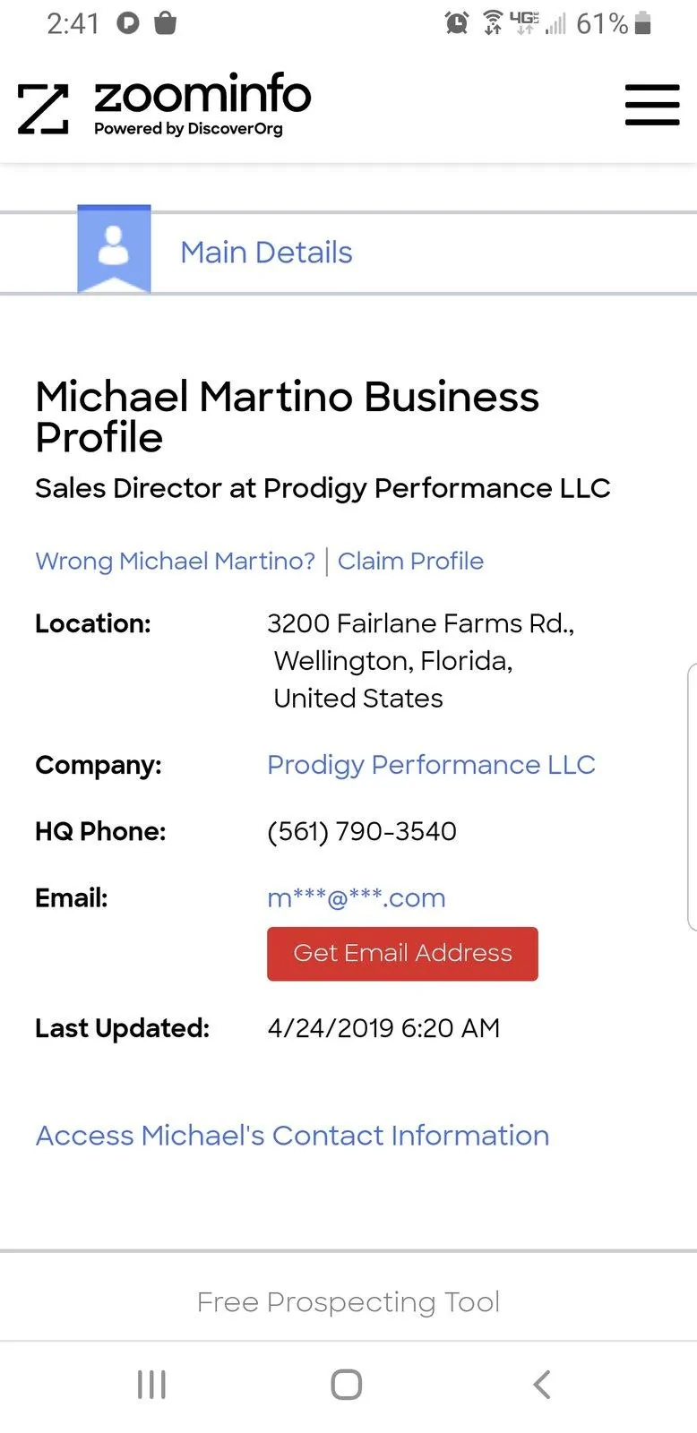

@TURBOCHARGED JL_JT , guess you wanted to set the record straight? like 11 of your 12 posts were on this thread in the last hour..... Not that I have a problem with that, just wondering whats your horse in this race? Do you work for Prodigy?
Oh I just checked, your 12th post was ALSO defending prodigy, weird!
here Another Video About Prodigy
Something rubs me the wrong way about a manufacturer posing to be a regular dude/chick. Just come out and open a sponsor account and set the record straight as you see it. The cloak and dagger thing just smells suspect.
When the person on a thread, posts for the first time on any thread, defending said thread, run...
Not to go full tinfoil hat, but his profile picture is the same as they use for advertising. His location is Florida, Seems suspicious. Very possible that he is a big fan/ loyal customer though. Would like to hear back from him on what's up. https://prodigyperformance.com/products/jeep-jt-gladiator-turbo-kit/
And if he does have the secrete to getting it to run well, then share the info! People want these products to work!
Yeah this is highly suspicious. A brand new account making all their posts in a year old thread defending a product. Makes me think it's actually somebody at Prodigy, and if so I just lost even more respect for the company.

Because as @Bowerss2 probably discovered correctly, @TURBOCHARGED JL_JT is the head of sales at Prodigy, NOT engineering.:CWL::asshat:
