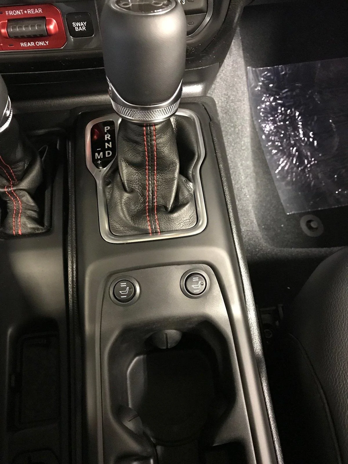

I installed aftermarket seat heaters between my seats and Bartact seat covers (taped the seat heater to the seat covers). Most difficult part was deciding where to mount the switches and running-placement of the wire harnesses. I powered the two seat heater circuits with AUX switch #4
The seat heater I purchased (two sets)
https://www.amazon.com/gp/product/B001L6HYQK/ref=ppx_yo_dt_b_asin_title_o04_s00?ie=UTF8&psc=1
I used this picture I found and used it as a model to mount the two switches for each front seat, had to extend the three wires to the switch wire harness about 12 inches. The switches are a 3-way toggle high-off-low and lighted when on. When in high the two heater to each seat are in parallel when in low they are in series.
Jeep Gladiator Anybody add heated seats after purchase? 598BC22D-C582-49AC-BB88-A3375A46B5A2

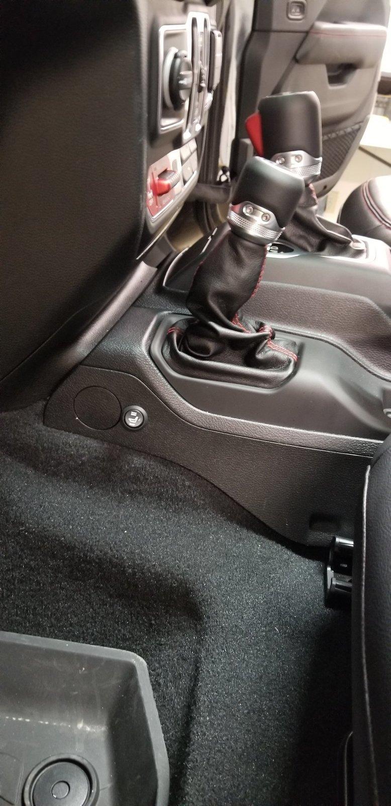

This would be an easier solution to mount the switches that I would consider if doing it again.
Jeep Gladiator Anybody add heated seats after purchase? 20180420_153905

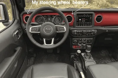

Edit: almost forgot
Jeep Gladiator Anybody add heated seats after purchase? 2018-jeep-wrangler-61_400x266
