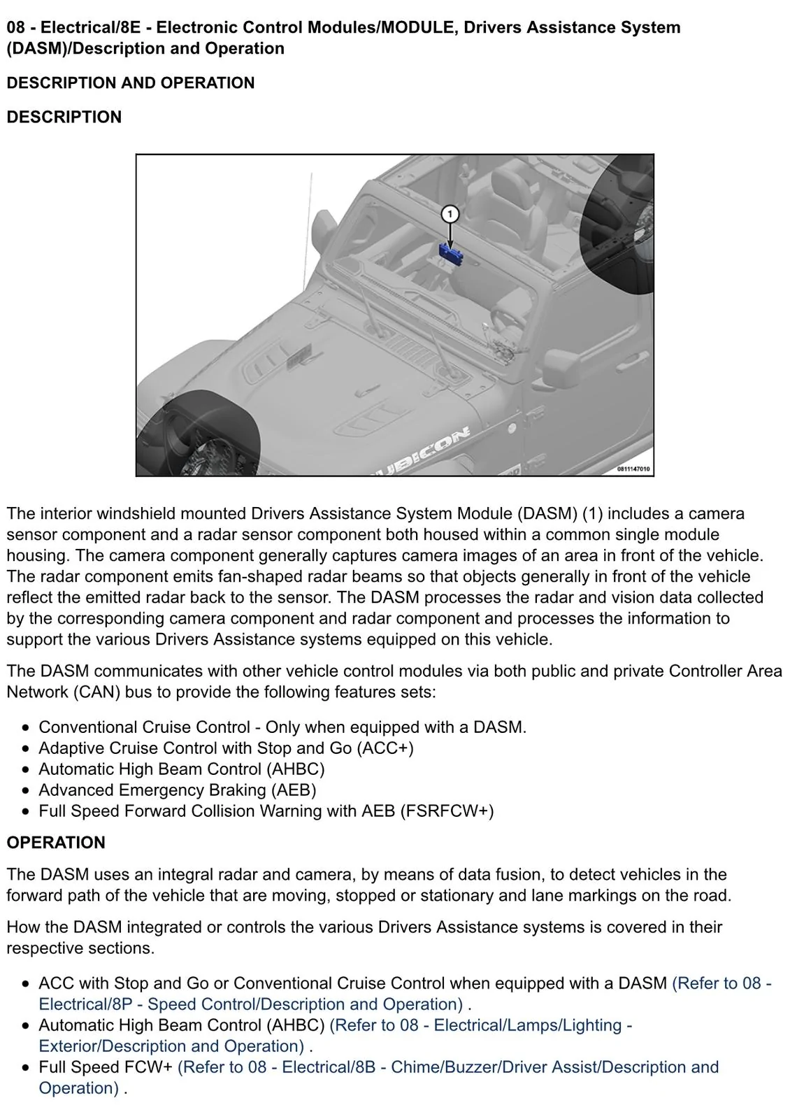

If you have the DASM on the windshield (ACC, FCW options), then you should be able to enable auto high beams, as there’s no hardware difference. Looks like it’s Lin & Misc: ASBMM present in AlfaOBD, but I’d have to compare a JT/JL Config that has AHB to one that doesn’t.
EDIT: I found the setting for auto high beams if you already have DASM (ACC and FCW options). In AlfaOBD, it is 2014 CBC Config I/O & Feat: Auto High Beam Module Location- IRCM

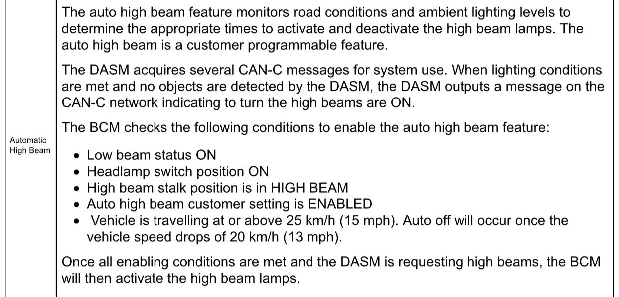

I’m not sure what others have tried, but these are the settings differentiated between a JT with and without AHB:
VehConfig 1: Auto High beam- YES
2014 CBC Config I/O & Feat: Auto High Beam Module Location- IRCM (you need AlfaOBD for this setting, because this location is not there in Jscan)
2014 CBC Config I/O & Feat: Auto High Beam On Threshold- 25 km/h
2014 CBC Config I/O & Feat: Auto High Beam Off Threshold- 20 km/h
CustSetMenu 1: Auto High Beam CSM Present- YES
Enable those settings, and you should have auto high beams. Assuming one already has ACC/FCW, there are no hardware differences on AHB equipped vs non-equipped. There is only one DASM (forward facing camera) module part number, and the same camera in that module used for ACC and FCW is also used for AHB-

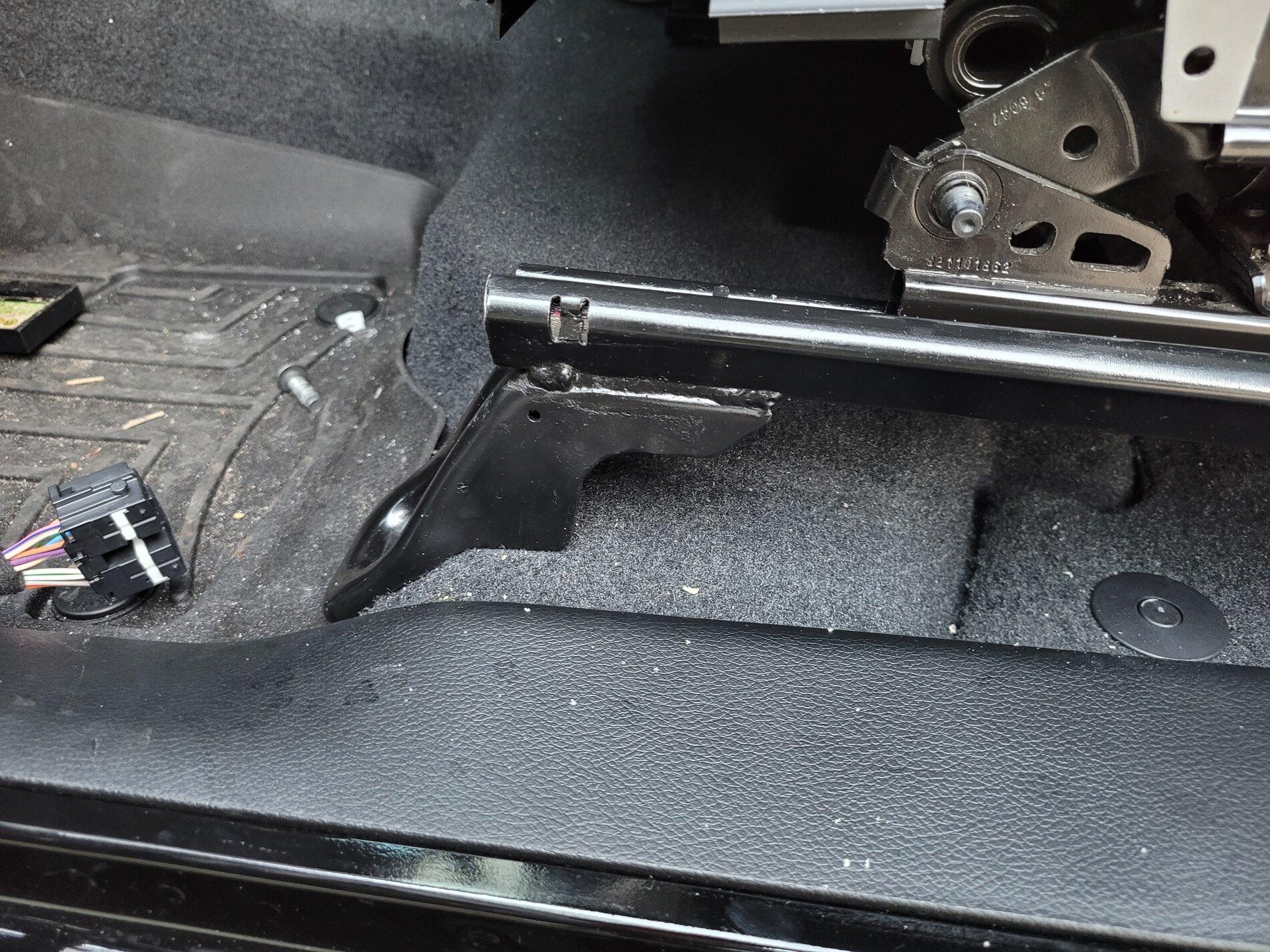

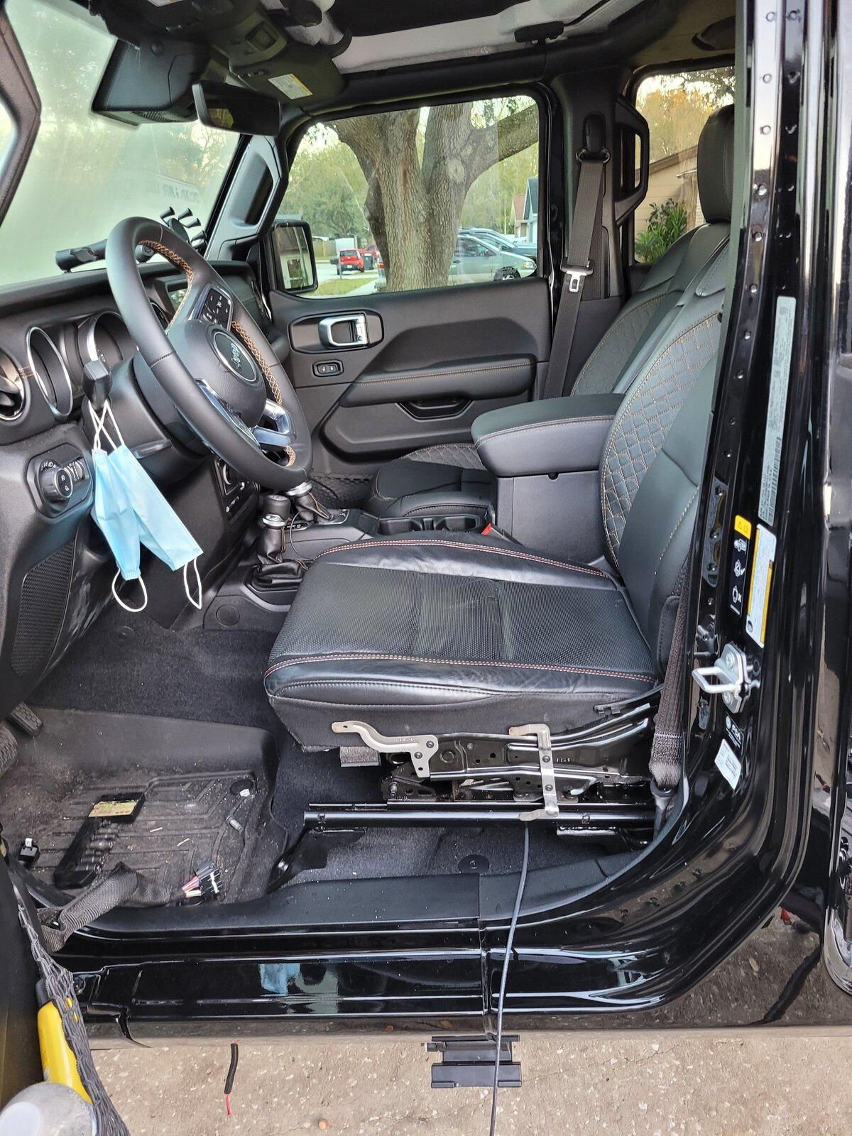

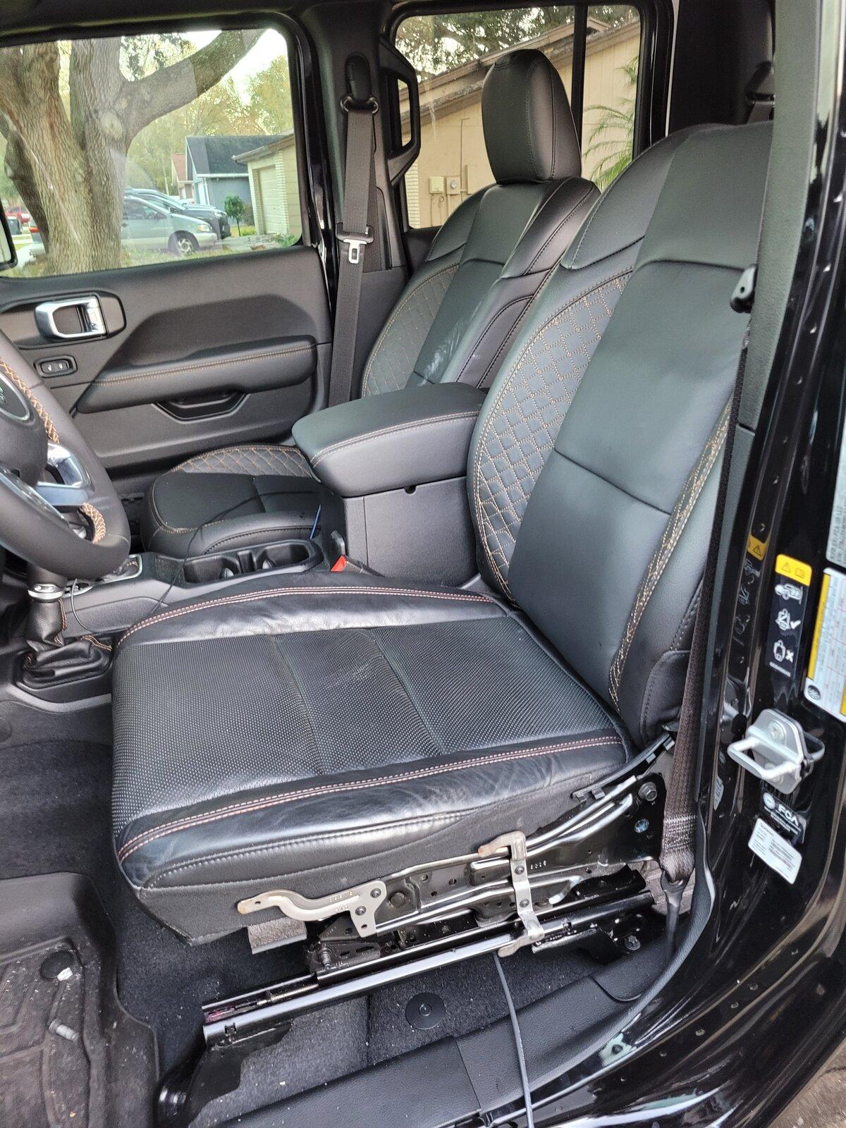

So, I got a seat from a 16 WK limited, I have modified the floor mounts from my original seat rails (you could almost swap the mounts side of the rail betwwn the seats, there is a slight difference in shape between the 2, so I opted to remove the mounting point from the factory seat and weld them to the WK seat rails). the back cushon and airbag was almost plug and play, headrest as well. Since I have a HIgh ALtitude model and want everything to match. I'm using my original leather and cushion moved the heated ventilated airbag from the WK seat cushion to my JT cushion.. Currently the upholster now has the bottom to replace center panel with perforated leather.
I have some 3rd party switch coming just to be able to turn on/off heaters and ventilation temporarily.
Here are a few pics of the seat and brackets currently..

@Jimmy07 and @ShadowsPapa I have made it to the point of mounting the seat and leather mostly ready to finish. Next up is trying to get some power routed to the drivers seat and I was hoping you guys could point me in the right direction. I'm happy to just get it working with some 3rd party switches for now!
