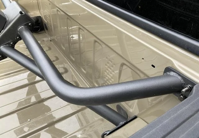

I posted this in another thread, but its unique enough that I thought i would start another in case others have seen or have used this hole themselves.
Far back corners of the bed, you can see daylight. I haven't gotten up into the truck to see if the bottom hole is threaded, but has anybody successfully mounted an eyelet back there for rigging stuff?
My 2 D rings in the back I had to take out when I installed some bed drawers (project not done yet, :CWL:) so I need another spot to winch from to pull deer up PLYWOOD onto my bed.
If you have photos/links of this hole being used, please post em. And don't go posting up sexual stuff, please, think of the children! :giggle::lipssealed::puke:
I don't have a photo handy but I used that hole to run my 10 gauge power cables to the back of the truck.
My factory Mopar 3-section hard tonneau cover mounts there

I just installed an Extang Truck Bed Cover. This is where a bracket is attached. Jeep made a change a few weeks before my Gladiator was assembled. The bottom hole was threaded. My 2020 Model and the 2021 Models have just a hole. So I had to get another bracket from Extang so I could install my cover. It is harder to install since it goes inside between the Cab and the Truck bed. The new bracket has Weld nuts so the original bracket can be attached and held in place.
