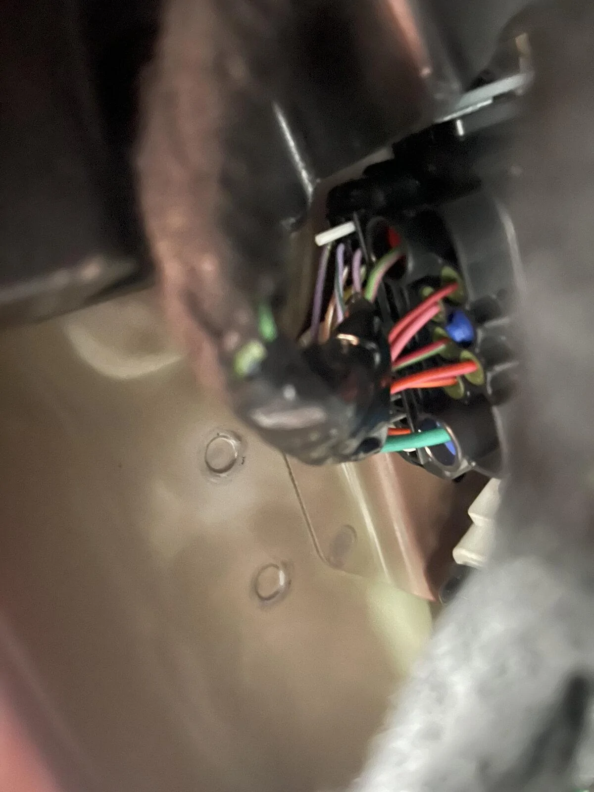

My Jeep was at 2 different dealerships for more then 5 weeks. They finally determined it was an issue in the harness near passenger front wheel
I'm going to check out that area tomorrow and hope that I can find something. Dual battery setup didn't cure it, happened to us yesterday again.

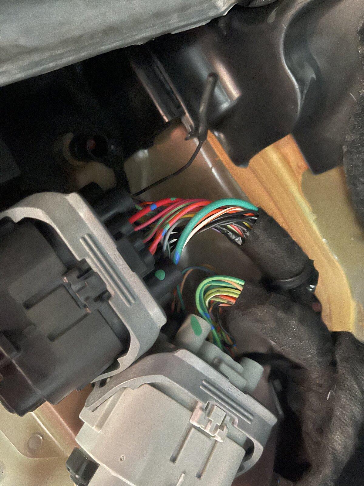

I had some self inflicted electrical issues recently and think of your jeep's electrical system like a computer network. You have all these sensors/modules that end up at three main hubs that jeep calls STAR connectors. I know two are behind your glovebox. All three STAR connectors have connections to each other. One STAR connector is for the high speed CAN bus (CAN-IHS) which controls more non-essential stuff such as the radio, HVAC, etc. That STAR connector has a connector to the CAN-BODY STAR connector which controls a bunch of other things. That STAR Connector then has connections to the CAN-C STAR connector that goes to things like the PCM.
If you really want to get down in the weeds you can download the wiring diagrams HERE and start looking at how things connect. I would start with the CAN-IHS-BUS-SYSTEM and CAN-C-BUS-SYSTEM ones. Those give a general idea of what modules connect to where. Then you could start taking information from all the codes and warning messages and see where those things connect. Look for the common point where everything meets and you should have a decent idea where to start looking.
For what it's worth, you can look at my thread HERE. While the issues are not the same, you can see that a single broken wire from the CAN-C STAR connector to the PCM caused all my issues. With the intermittency of your problems I would imagine where ever that common point for all those modules converge has some short in it.
Hey Mike, I'm digging into your post & issues now in hopes of finding a clue to my issue. It's my wifes 2020 Sport S with less than 5K miles on it. I put a stereo and alarm in it (at less than 1K miles) and am wondering if the installer (me for the stereo, shop for the alarm) might have pinched a wire in the dash (me with stereo replacement) or the passenger kick panel (alarm electronics).
She is afraid to drive this due to when this issue pops up, you lose everything. If you were on a highway, you would be in deep shit.
I may reach out to you with questions as I'm reviewing and trying to find a solution.

That’s exactly how mine acted. 5 weeks and 2 dealerships to get fixed. Was an issue in harness behind front passenger wheel. Apparently wiggled apart and there are apparently pins in there and one started to come out. Was told there are several grounds in connector
