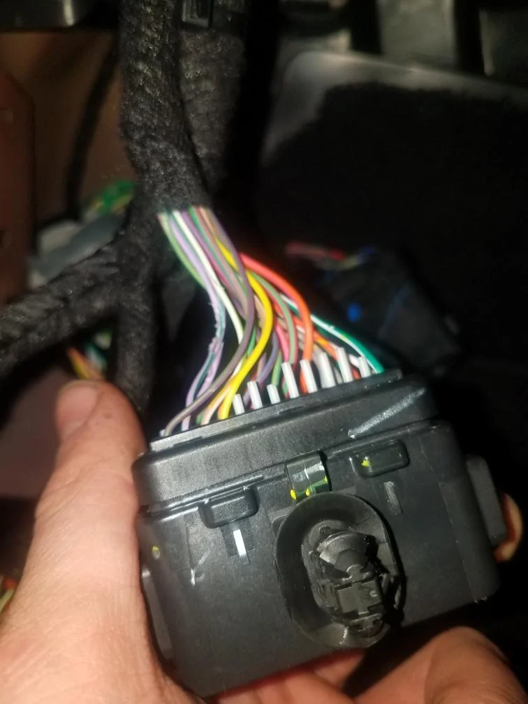

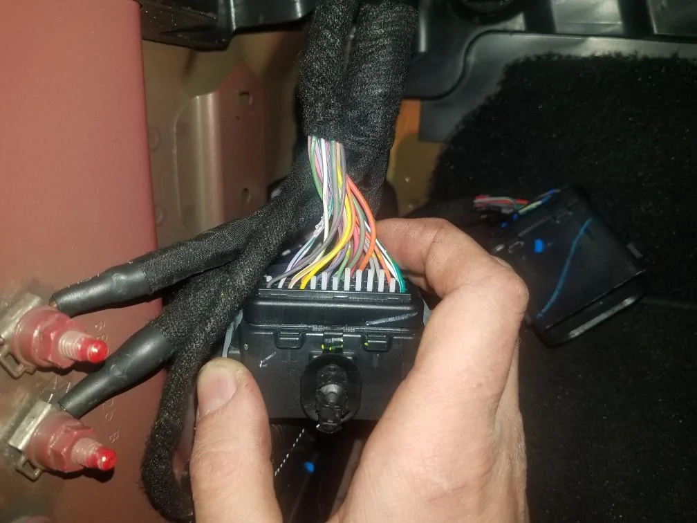

Dealer found two exposed wires in the area where the door harness connects on driver side

Here are the photos they sent
Jeep Gladiator Anyone have electrical issues? My Jeep started acting crazy today 1F31633E-7BEF-48FF-B664-7CC93CE6AFD4
Wow! Talk about looking for a needle in a haystack. At least they found it. Hopefully they’ll get you back on the road soon. Do they know what caused it?

Wow! Looks like possible rubbing? But there really isn’t anything else there to do so. Must be a weird install issue at the factory?

They tried to say a critter got inside and chewed on them. I drove down and looked at it and the manager was like I’m sorry I should have looked at this myself before I said that. Both agreed no critter did it. Looks like the wires are just frayed. I’m not sure how it got like that, manufacturing issues
I hope that solves the problem, keep us posted. Seems plausible the way everything is interconnected, but that's a bad design if a couple door plug wires can affect the entire vehicle. Let's hope it's a solution
