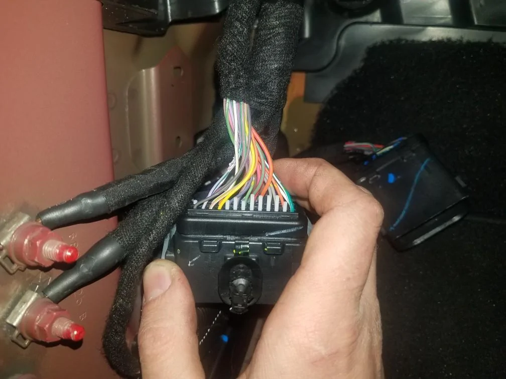

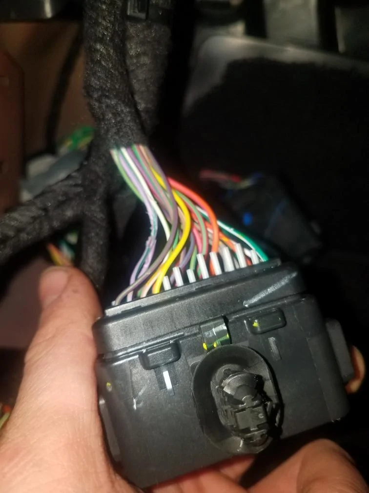

Update...Dropped my rig off at the dealer. They noted the C2 plug on the steering column was missing pins. They are replacing the connector and feel that it will fix the issue. I will have the rig back tomorrow. I will provide an update in a few days to see if it is all good.

my jeep broke again. Dealerships around here must suck. Had it 2 weeks. Said they replaced aux battery and fuse panel. I was told there were exposed wires and they had to replace a harness. I just looked and all they did was tape all the wires with electrical tape

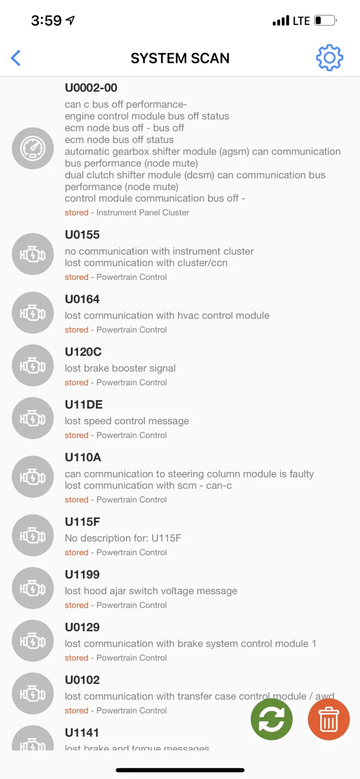

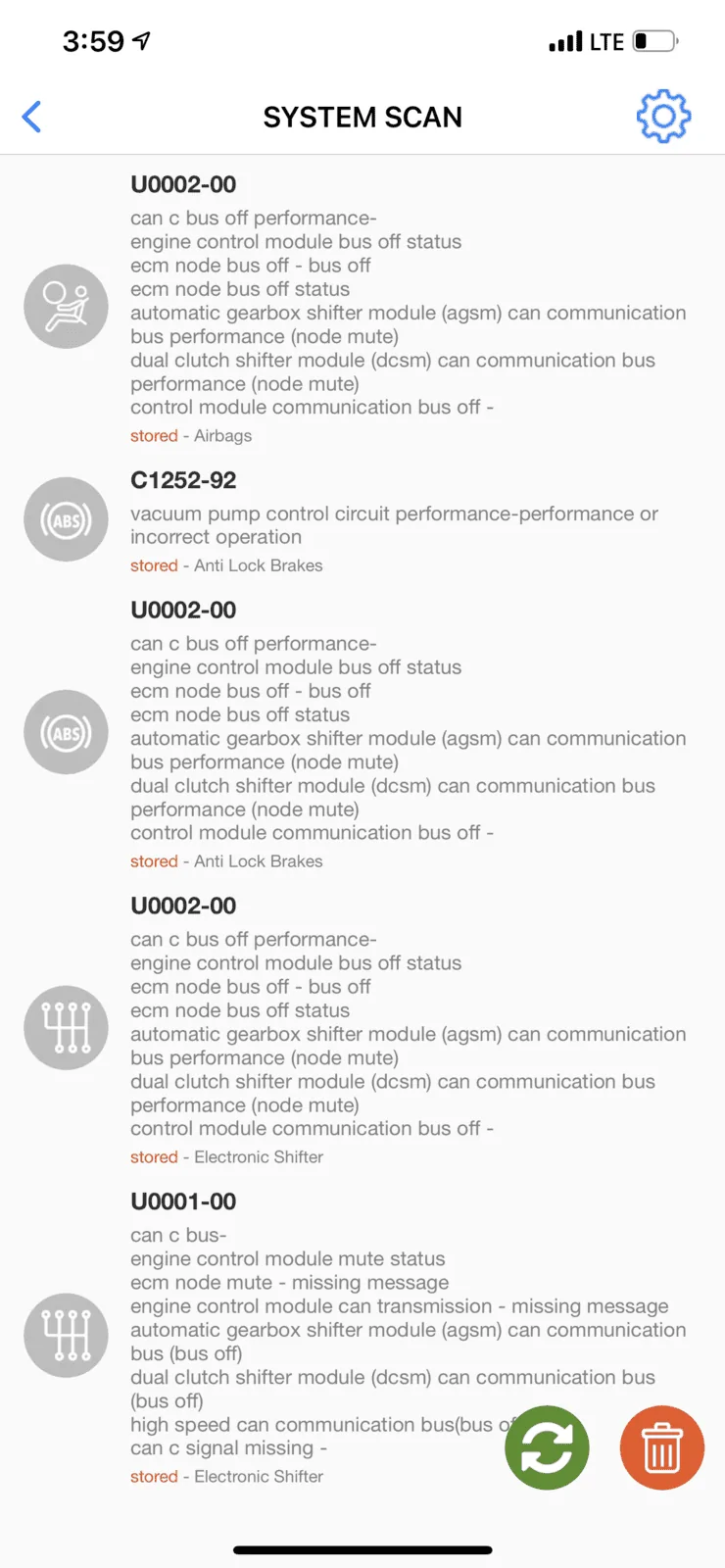

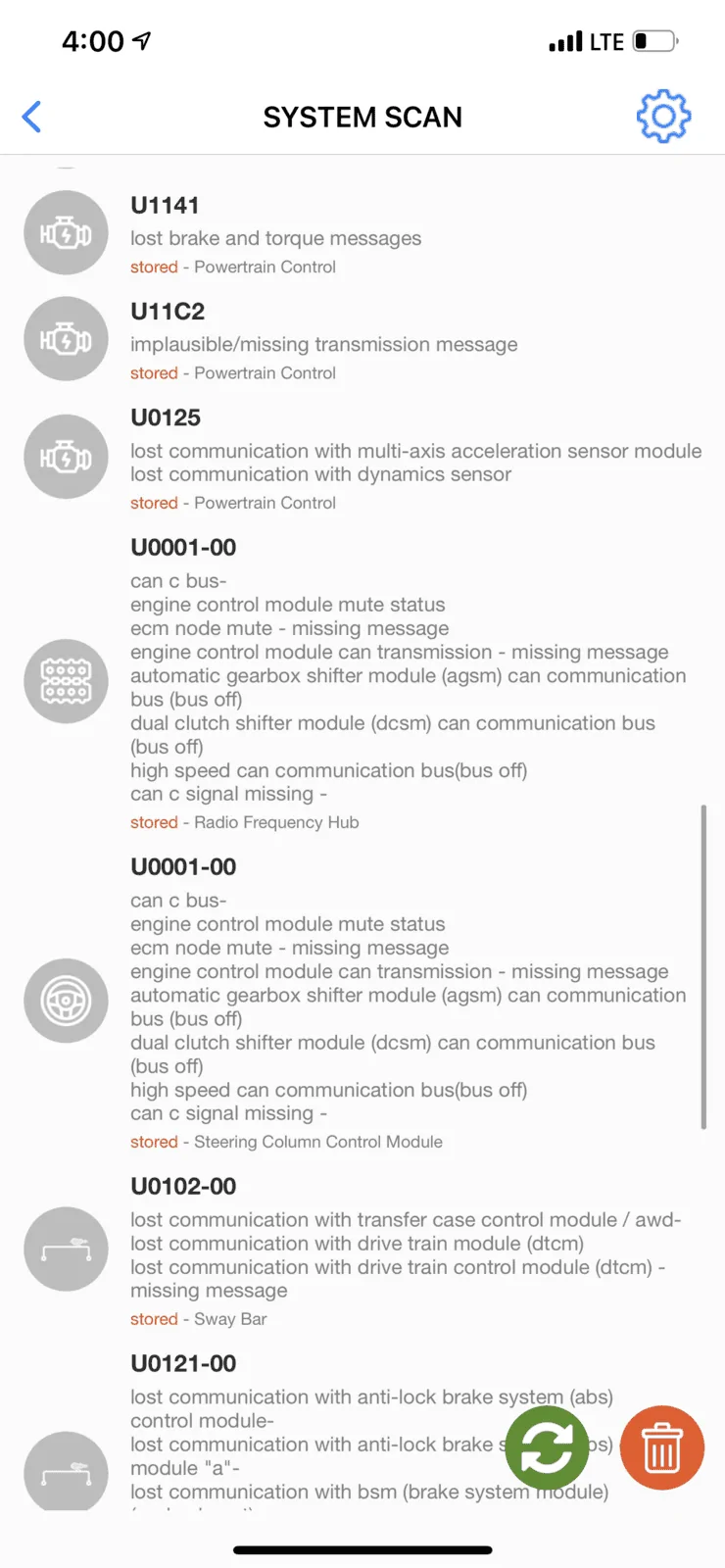

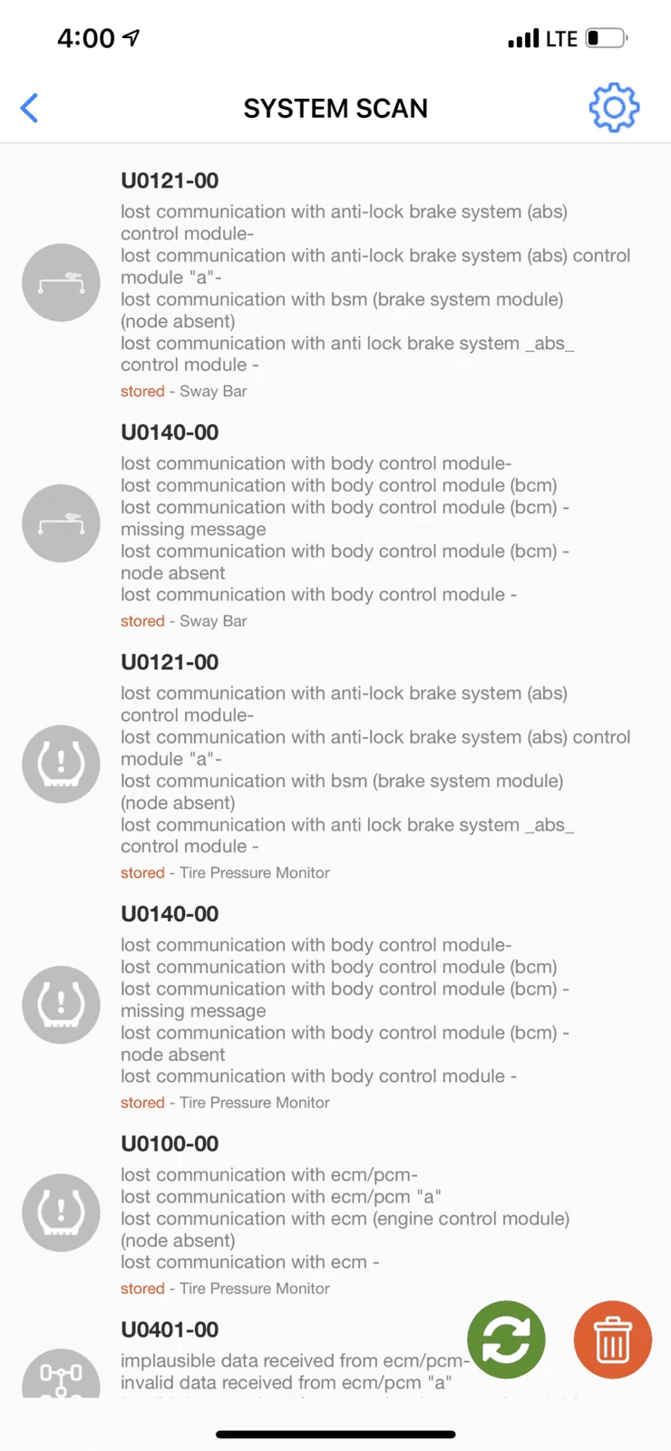

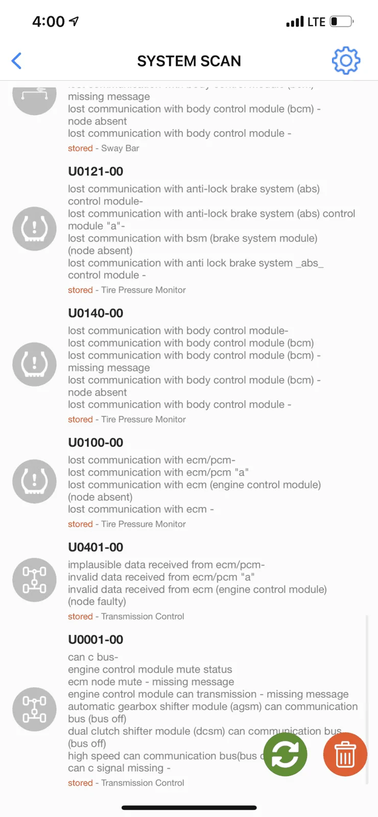

I called jeep cares and opened a case. It’s weird how my symptoms come and go. If I take my security bypass cables and plug my icar pro in and scan with jscan to check codes there are a bunch. I don’t clear them but check engine light goes away

I haver had zero issues since ess/aux bypass
I’m not sure if my issue is the aux battery. Dealer had it 2 weeks. Said they replaced aux battery and fuse strip next to fuse box. Truck still goes crazy, I loose power steering and transmission. Everything that deals with can bus goes out. I’ve almost crashed. They said they found exposed wires and sent me photos. They were suppose to put new harness and I checked and all they did was cut wires and use electrical tape

Photos they sent
