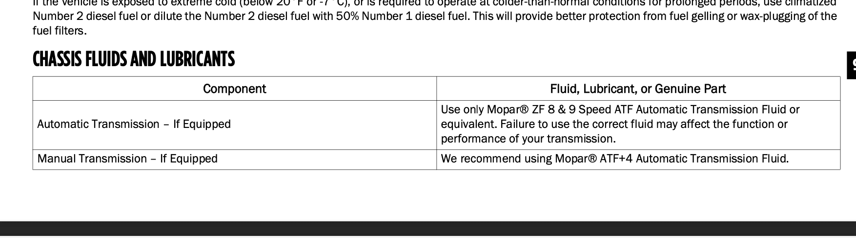

ZF and thus MOPAR 8hp fluid is green.

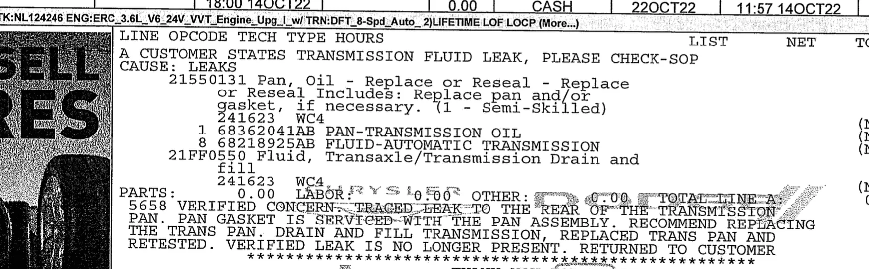

Jeep Gladiator Anyone have trans leaks? Screenshot 2023-02-13 at 06.49.46
Not sure if anyone knows the part numbers by chance? looks like they used 68218925AB??

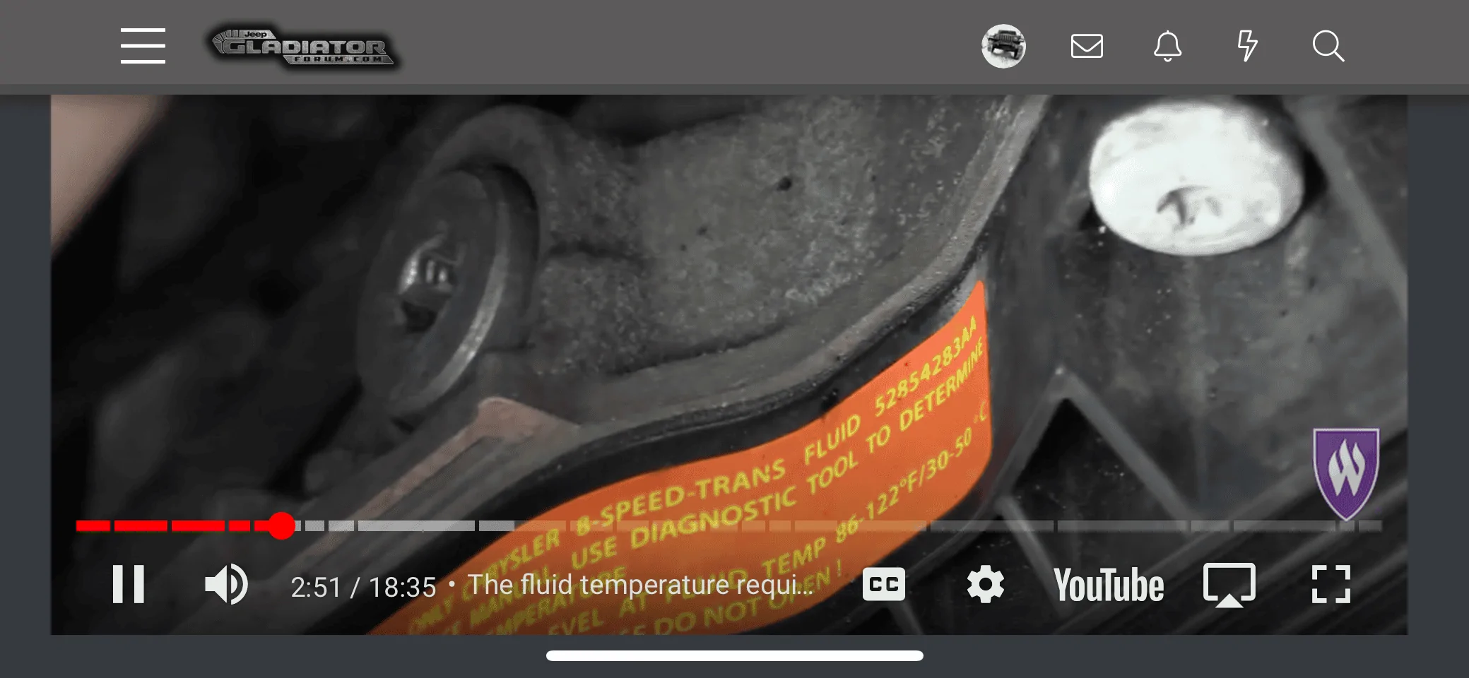

It is very possible to overfill this transmission which may have caused a leak which you are seeing if the oil level check was done with a cold transmission rather than waiting for it to heat up. The difference between “oil level” check while cold or within the temperature range is a fair bit of oil volume. I don’t know exactly, I haven’t experimented with that, would be super easy to do. But if the tech filled it up after the new pan while cold then capped it off and signed off on it, then when that transmission got to running temp which is way higher than the temp when checking level, that EXTRA volume of oil has to go somewhere and if it’s showing to come from up higher on the transmission (out a breather???) then I’d say that’s the problem.
So if, on the weekend, you “level” your frame, turn on the engine and crawl under and pull the fill plug and oil comes out….It’s over filled!! STOP and plug it. Watch the video I posted above and do exactly as described for checking the level. You will have to run the transmission through the gears just as shown in the video, get it to proper checking oil level temperature, pull the plug and let it drain out till it’s a dribble then cap it. Spray brake cleaner around the mess and residue and monitor it.
Or….if as stated above, frame is level, truck is cold and you just started the engine and crawled under and pulled the plug and have oil pour out…..cap it immediately and take it to the dealership and tell them they overfilled it and you want it documented and corrected.
