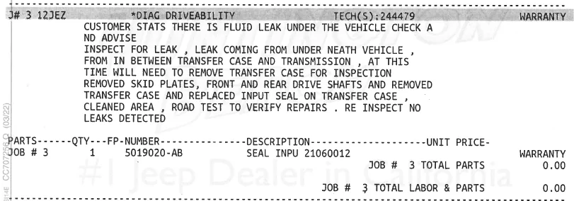

@chorky , I had this issue last year. The input shaft seal is serviceable, no need to replace the whole T-case. Here is a copy of the work order from my dealer.
awesome! This is good news thank you. I thought it was pretty insane for ppl to say it is not.

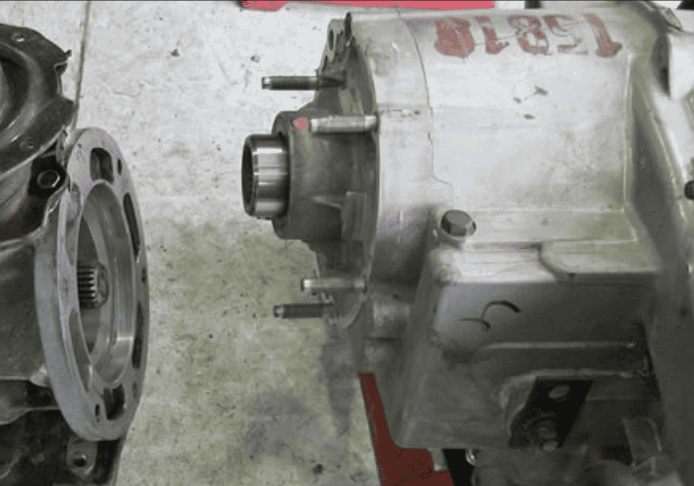

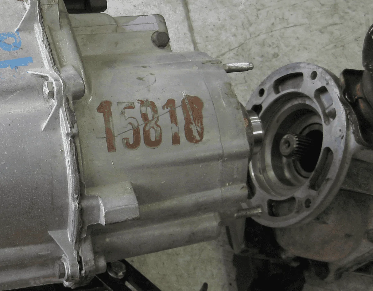

It makes no sense at all to not have it replaceable. Just no sense. They've been like any other seal for as long as I can recall, likely longer.
You can see the seal here in this pic - then the input shaft of the transfer case slides over the output shaft of the transmission and the hub of the t-case slides into the seal in the back of the transmission. So that transfer case input runs against the transfer case seal AND the transmission seal. There should be NO fluid at all between the two.
(this is a picture of a NOS (New, Old Stock) transfer case I bought and put in my car)
Jeep Gladiator Anyone have trans leaks? 1698854158130
Here's the transmission output seal -
Jeep Gladiator Anyone have trans leaks? 1698854244776
