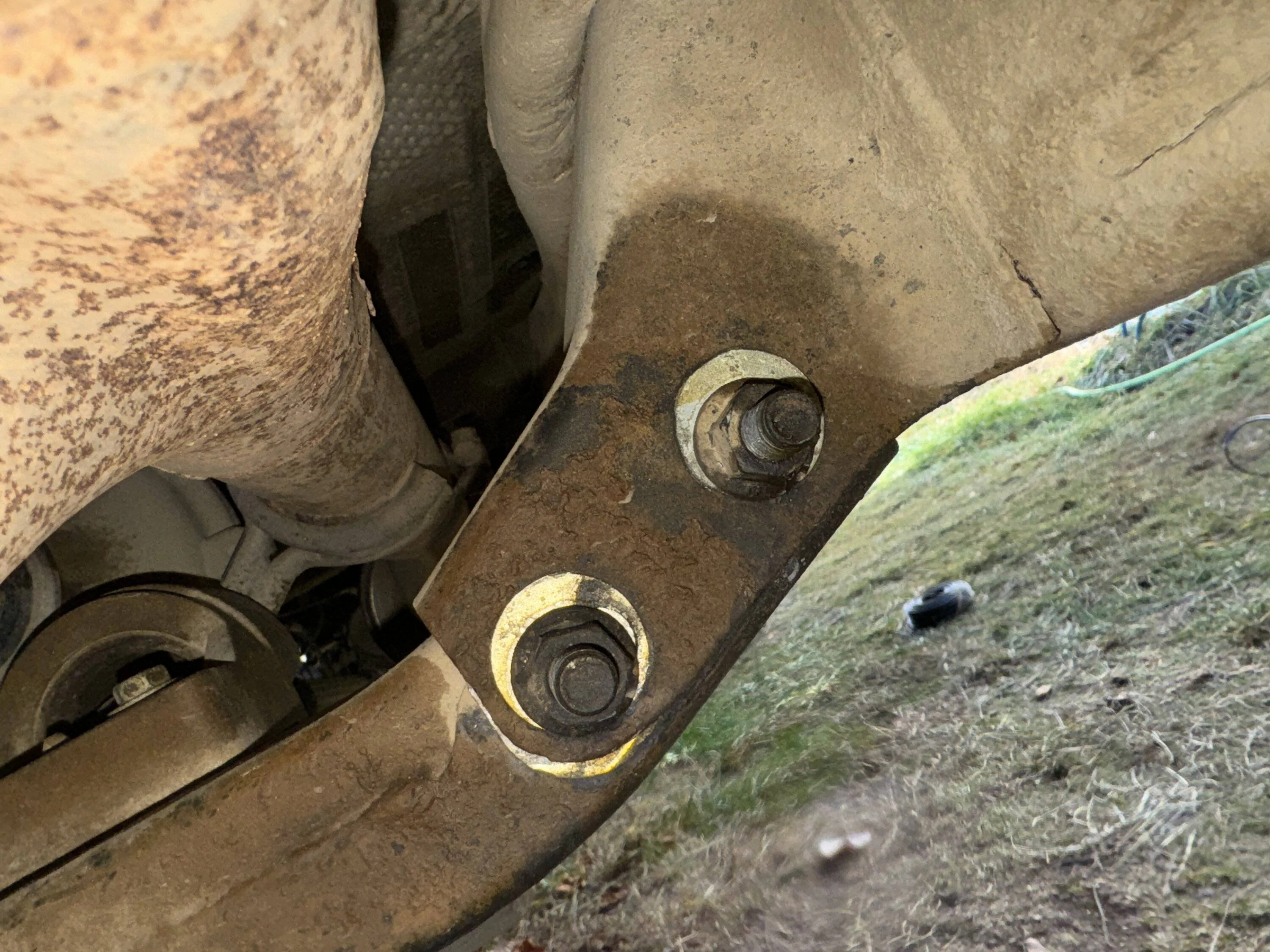

Can't remember if I did so before, so posting some pics for reference and recalling later on since I was under the JT today.
This is the work of the shop's "Senior" technician. Senior huh? Makes me wonder what the newbies do.
Bolts in backwards. That's nice. Cool to see the hole in the frame. Also cool to see the misalignment.

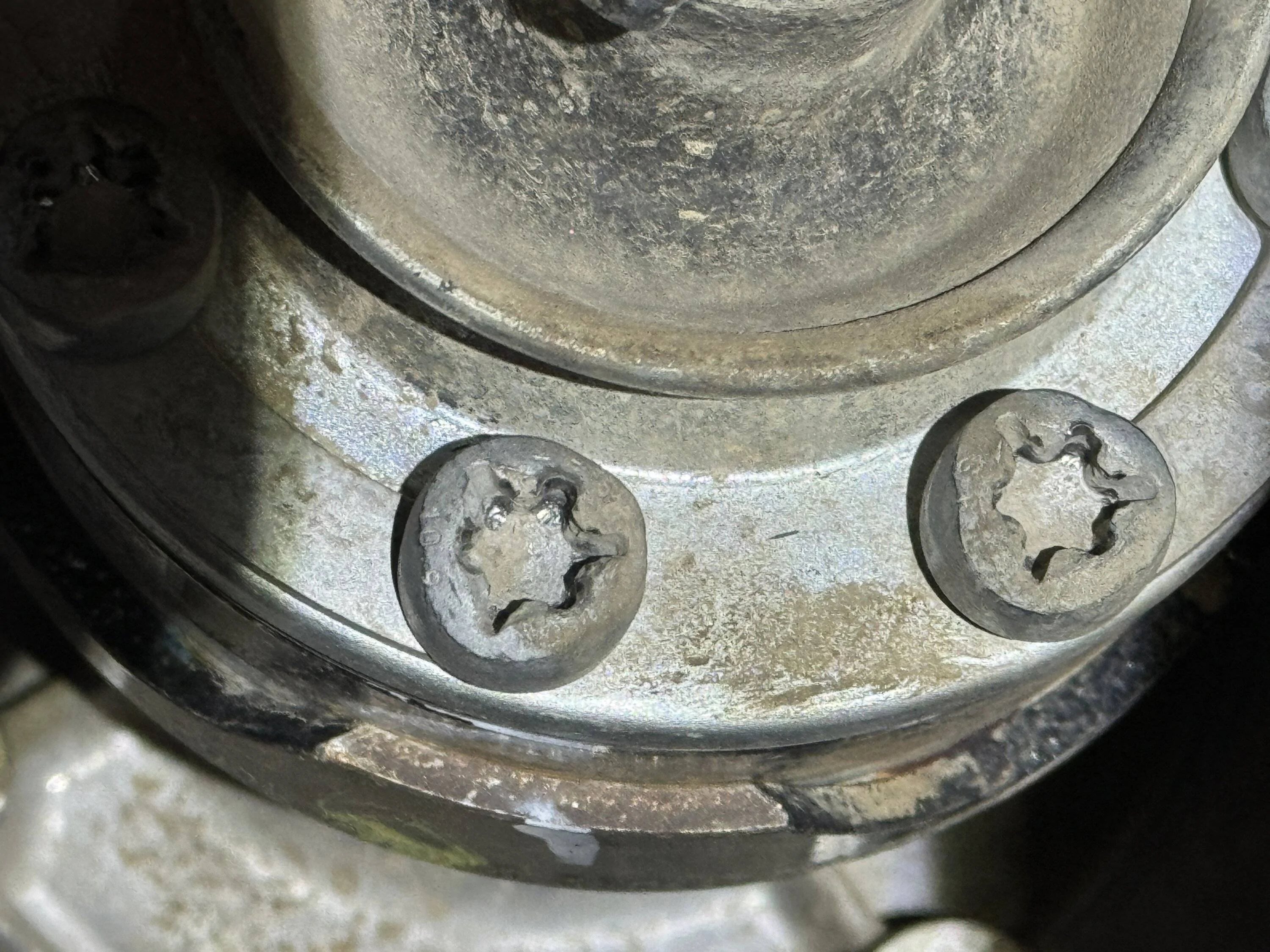

Oh here's those super weird and awkward driveshaft bolts. Anyone know what this is?

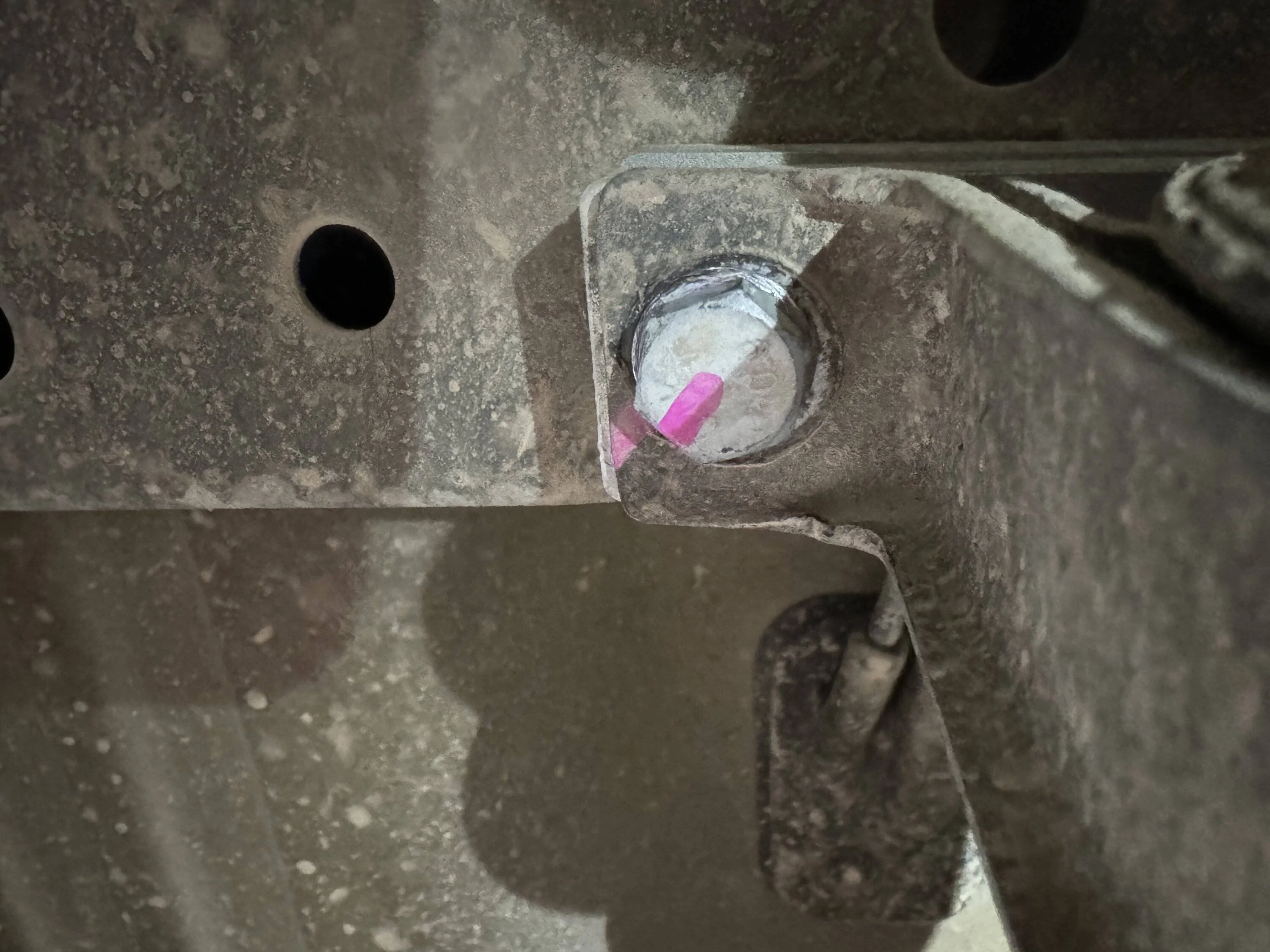

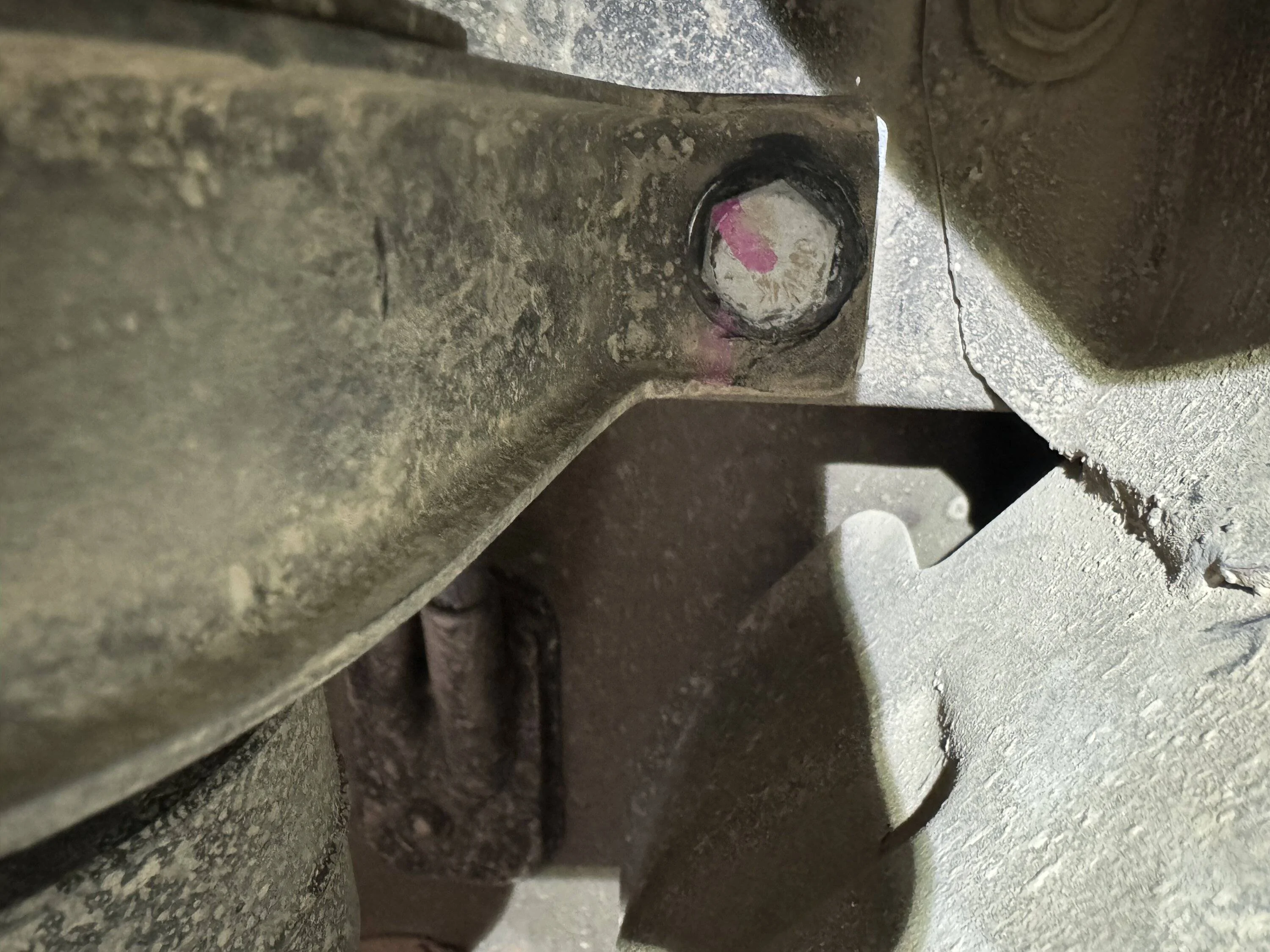

Here the tech missed, rather probably lost, the washer for the carrier bearing bolt.
Jeep Gladiator Anyone have trans leaks? IMG_3241

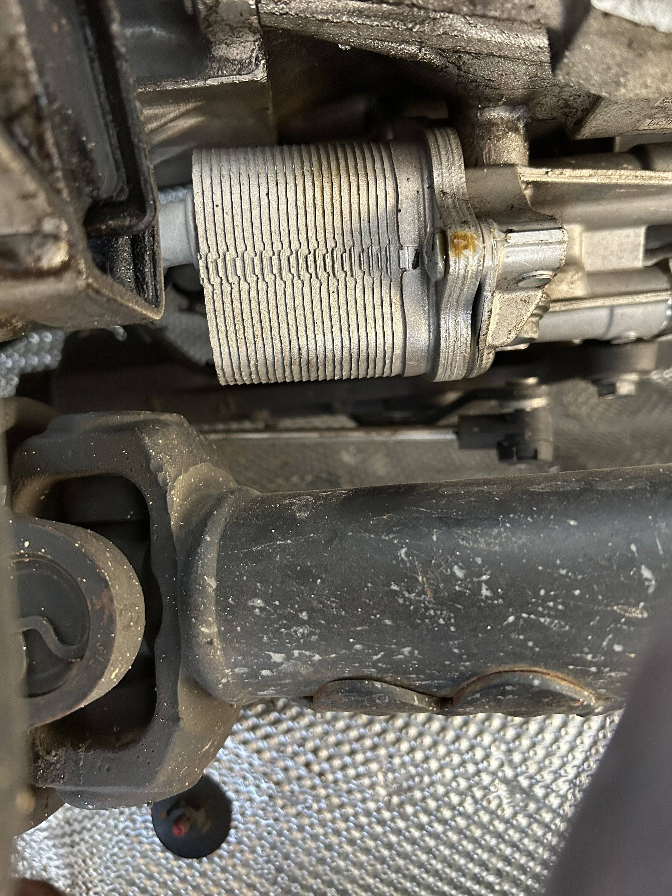

This is what it should look like.
