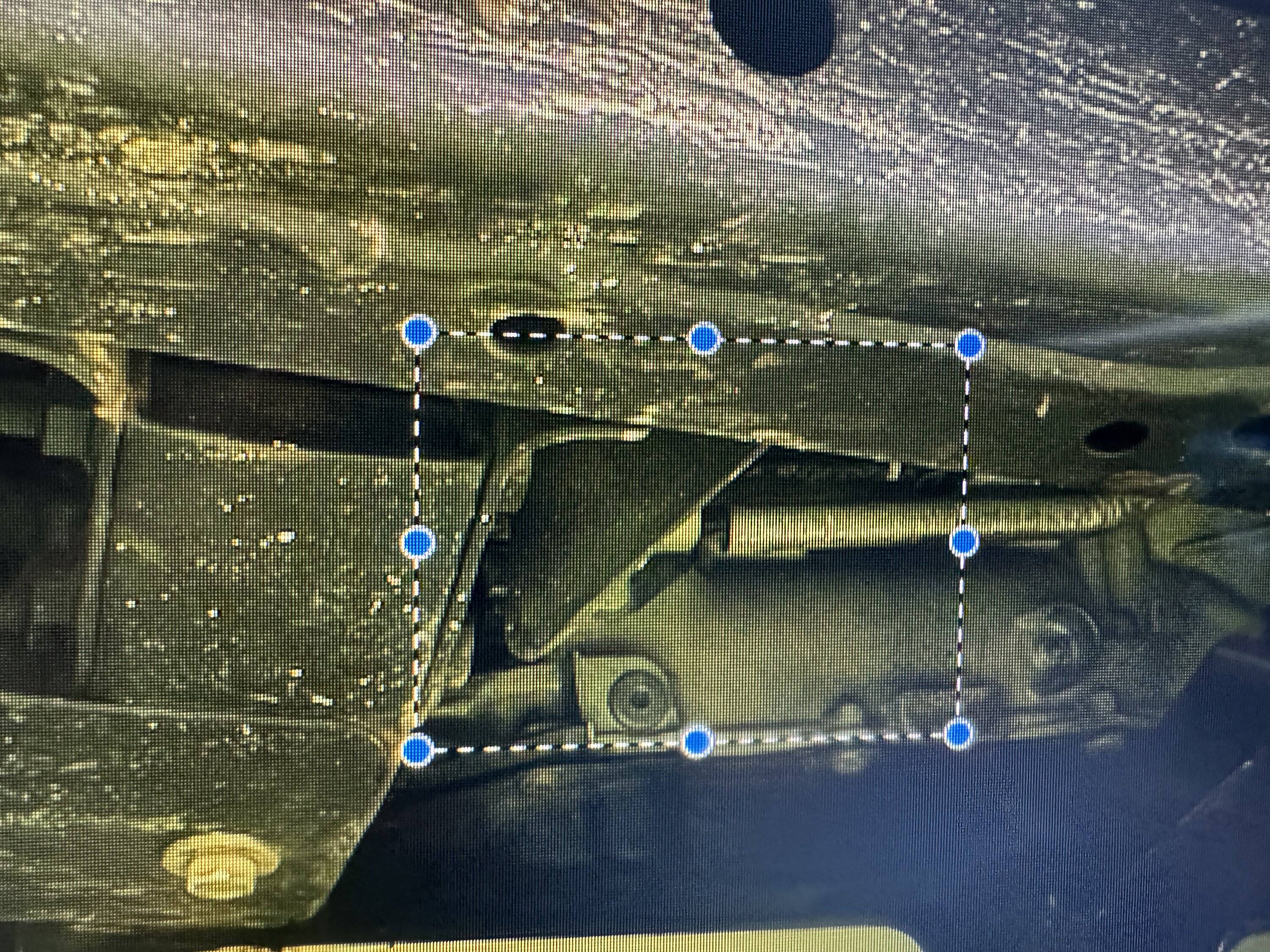

Shoulda posted this here. I will try and delete the other thread.
Anyone have an idea what goes or used to go here. Passenger side inside frame forward of tran/transfer main support.
it is possible it is something I removed when installing the skid plates but I kinda doubt it. I dont see anything dangling indicating something is gone but its dark and hard to see.

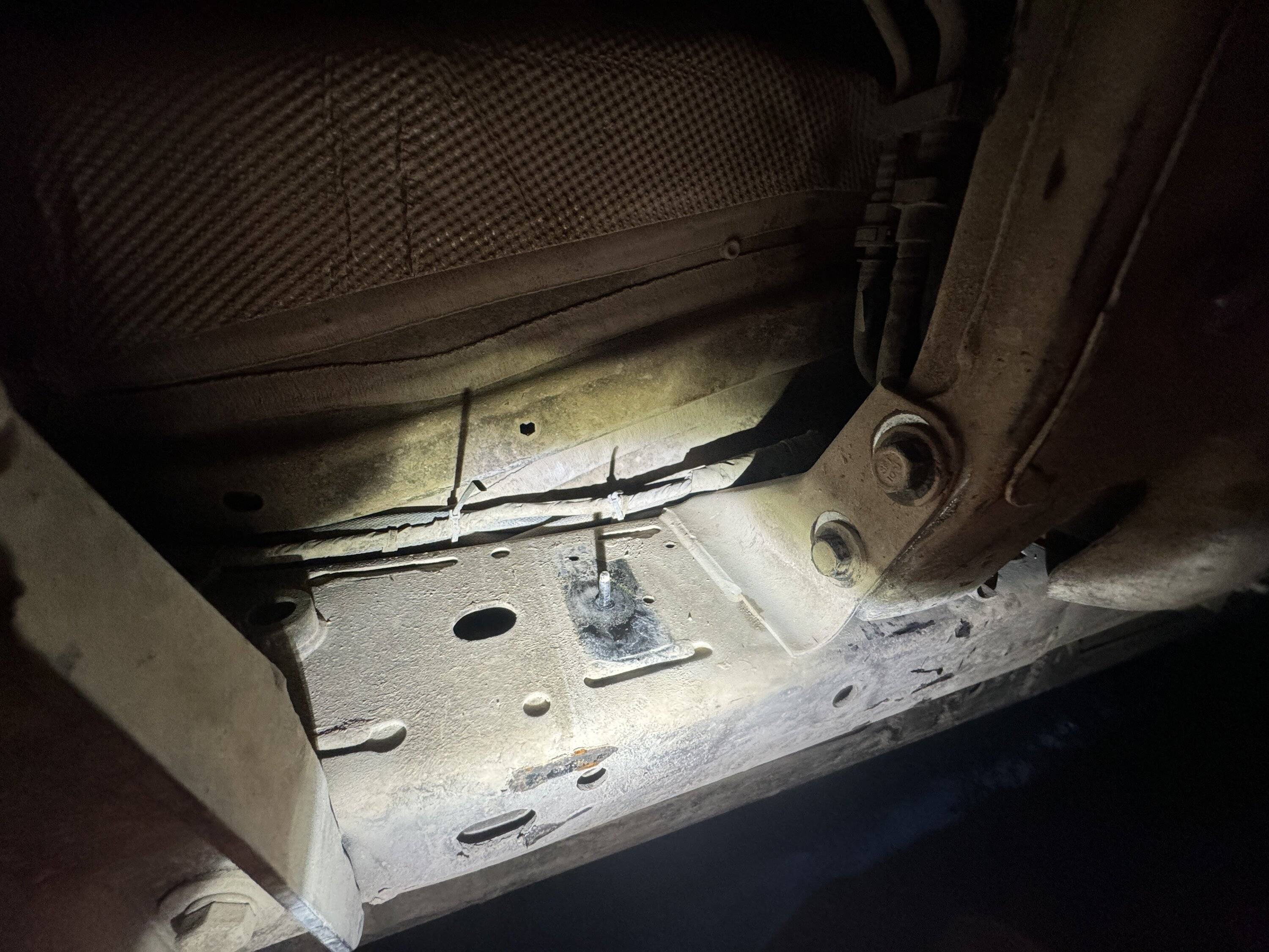

I see a part of what should be here. Definately not something I removed during install of skid plates. But the question stands what is it holding up?
Jeep Gladiator Anyone have trans leaks? IMG_2975
i think its a bracket to protect the fuel lines. Awesome. Im suposed to go on a trip this weekend too. Hey Benny @AllMoparParts.com could you shoot me a part number and price? Im more than willing to bet the tech just tossed it and its gone forever. Dont really want to drive too far with exposed fuel lines.
This repair process has been a nightmire. Any more warranty work and I am gonna consider selling the JT. It should not be this hard….. also, trans support bolts were installed backwards and misaligned on the drivers side.

I believe 68357604AC is the shield your looking for

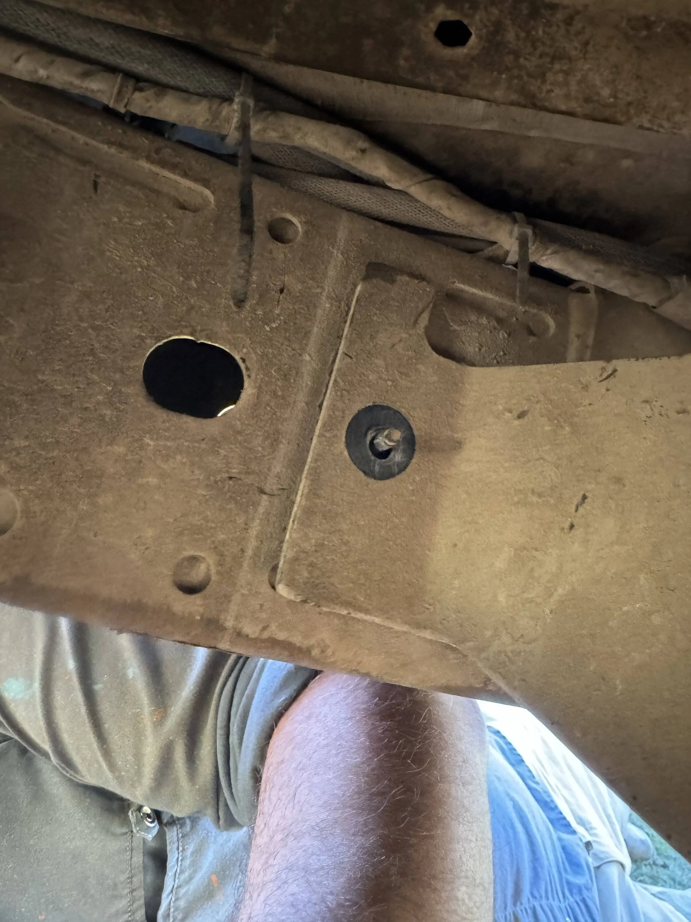

I am so tired of this shop, rather just people and their poor work quality in general, and that goes for most places these days it seems. Its exhausting.
So picked up the gas line protector last week since I was in town. They gave me two bolts. I was pretty sure at that moment i need a bolt and nut but was in a hurry and didnt want to stay there any longer than necessary.
Well long story short sure enough they couldn't even provide me with the correct parts they removed to put this thing back on.
Anyone know what size thread this is so I can just maybe get a stainless nut and washer at my local hardware store tomorrow?

Bump. Anyone know the thread size/pitch?
