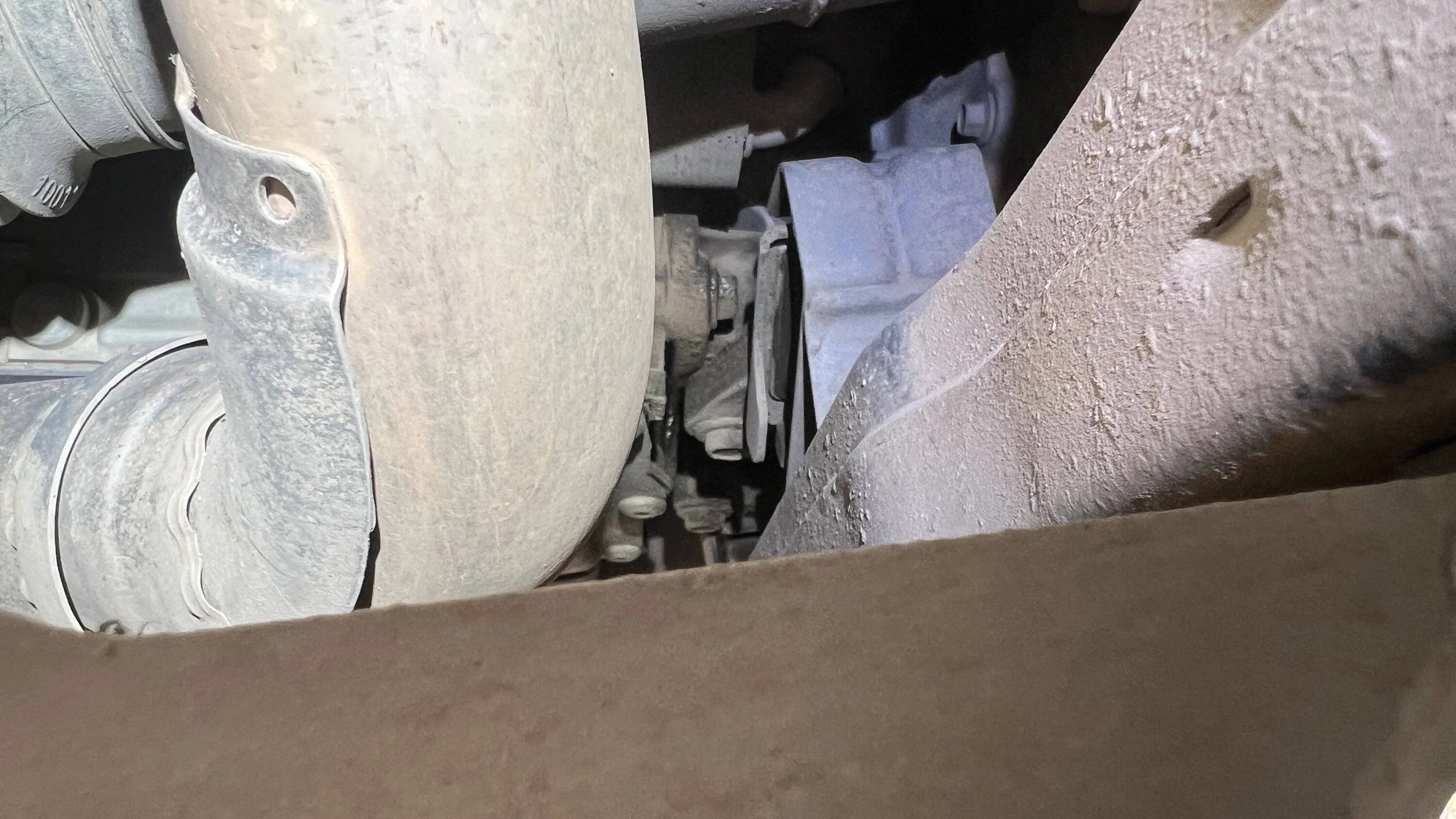

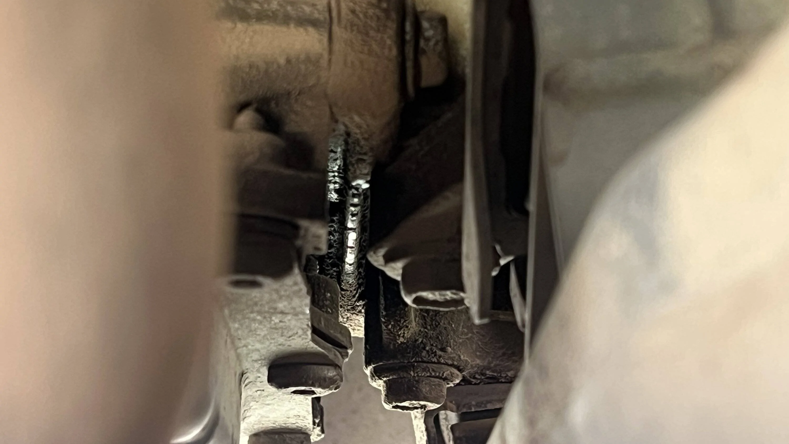

I really dont think this is a trans fluid leak. The color of the fluid is pretty distinctly pink/red in color. So if the trans fluid is green then it has to be the transfer case
There is a heater unit about the size of a baseball up against the transmission that has coolant running through it and which heats the transmission. It is possible to have a seam leak or a failed hose clamp or something there and dripping down.
Have you noticed your coolant level drop at all in the bottle when cold?

You could also level the frame, pull the fill plug to the transfer case and stick your finger in the fill hole of the transfer case and see if it’s way below the bottom of the hole, yes??
so that is a coolant line….. on the drivers side? I did check that and there are no signs of fluid anywhere other than the bottom mating surface of the trans and transfer like in the pic. I dont see any sign of fluid anywhere else.
Yeah i did ask the dealer to check the fluid last time and they said it’s ok so it must be a small leak. I might check it this weekend as well. Its not easy for me to get under there soi try and limit how often i do that
If it’s red, then it could be the TC shaft seal issue. I believe that issue was caused by improper matings during assembly of the trans and TC, not a seal issue. Basically, they ruined the seal when mating the two units together by damaging the seal with the output shaft of the transmission.
This is what I have suspected from day one of making this thread just based on other discussions in other threads. I am awaiting a response of jeep cares to my inbox before proceeding to call the dealer. No doubt it will result in needing a new transfer case if the seal is not serviceable. Such a poor poor poor poor poor design..... to make things not serviceable. I would be surprised if it is a coolant leak and I'mnot sure how it could be anyway unless those coolant lines have a way of exiting the rear internals of the transmission - but I will keep an eye on my coolant levels just in case.

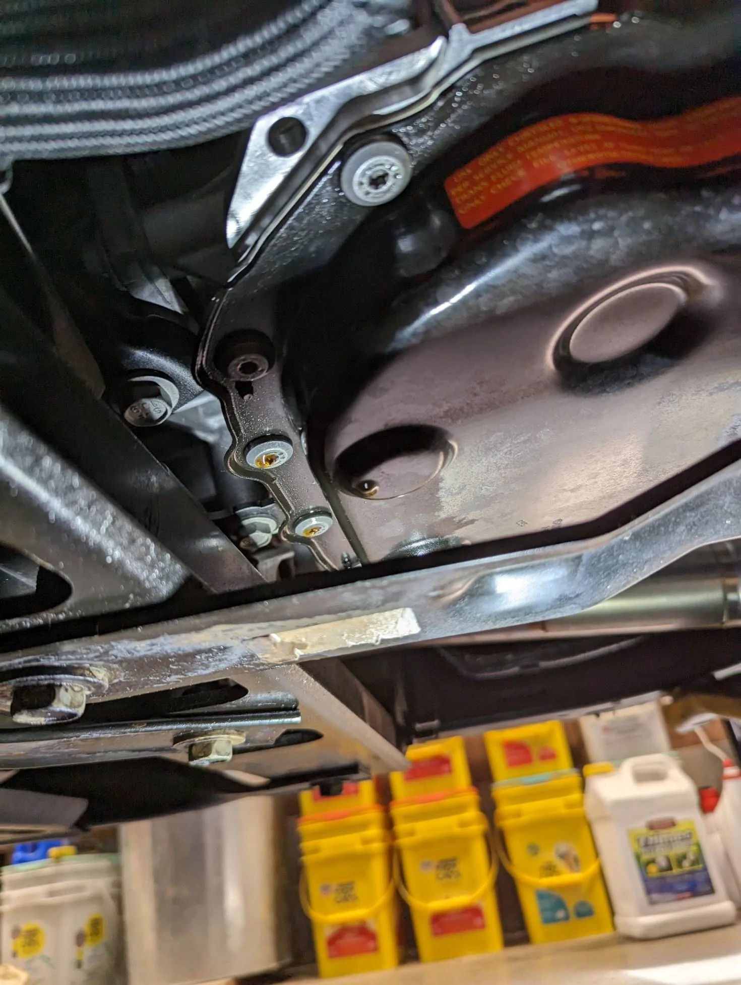

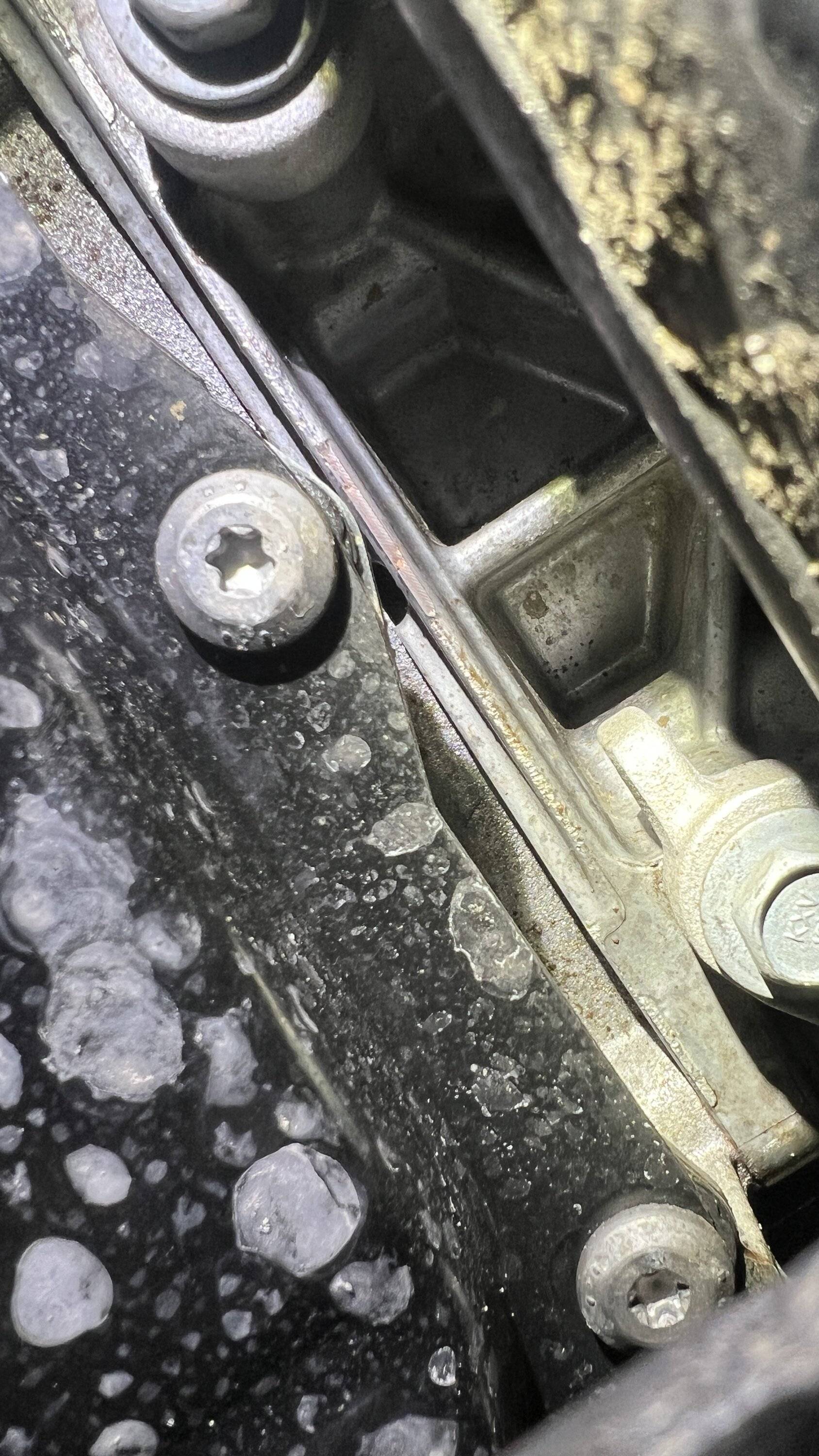

Did you try retorquing the pan bolts? I had to retorque mine at 6000 miles for the same thing. Now at 46000 miles and still dry.
It went in a few weeks ago and they replaced the pan gasket. It's leaking again although not as badly. I have observed that it doesn't seem to leak much at all when running on battery, seems to be mostly when the engine runs but that makes little sense as the pan is never pressurized at all ever and the engine or motor powering it shouldn't matter.
It's basically the same transmission from the electrics on back
I'll check torque for kicks, though - in the 4xe forums this is a very common complaint.......
I'll have to find the torque specs some place - I have little info on that part of these.

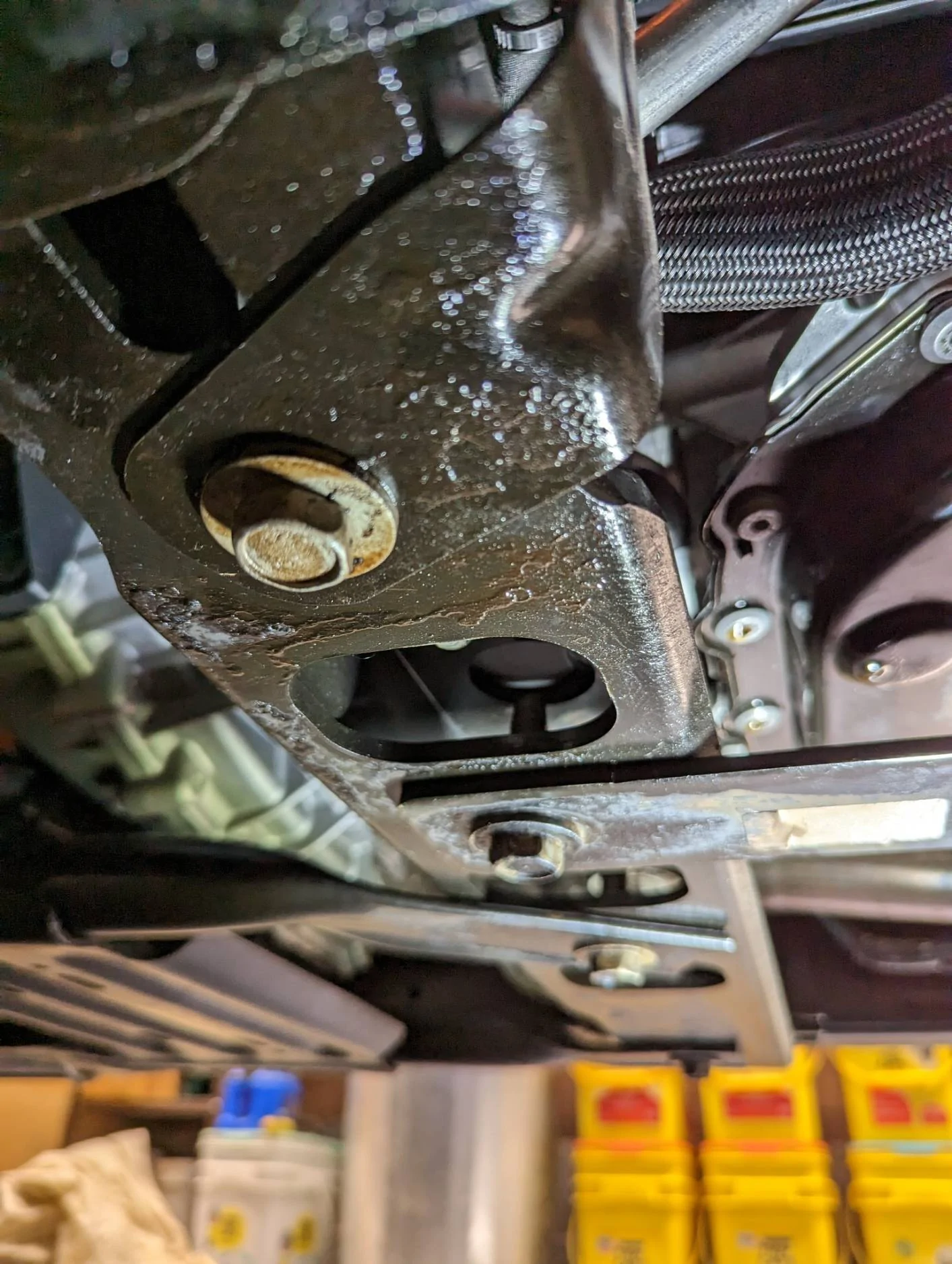

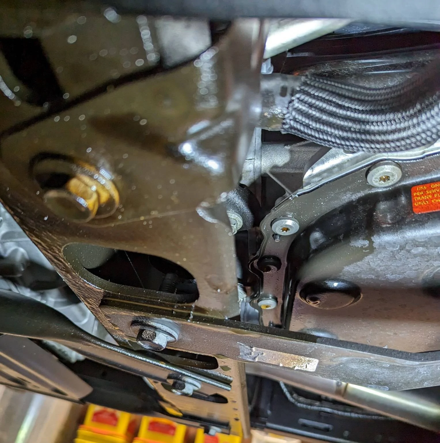

Heres a few pics of mine. It has the same slow seep. But clearly a leak. The question is how much importance do i place on getting it done. The dealer can overnight parts at a $20 cost to me. Or order them for free and who knows how long it will take. Not sure why there is a difference like that
i am still uncertain as to if the seal even can be replaced as others here have stated the entire transfer case must be replaced. Anyone have intel on this?
