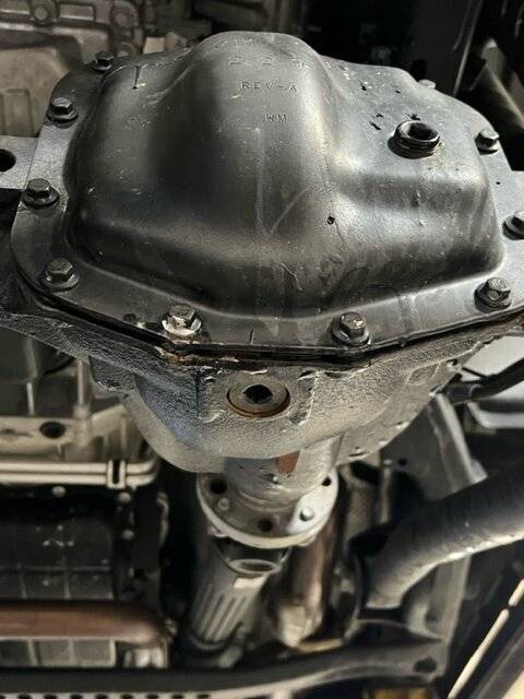

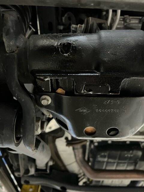

anyone else experience leaks from these 2020 Gladiator axle / differential "seal points"?
DarkMatr
todd
Dec 23, 2022
SA, CA
2020 Jeep Gladiator
2020 Gladiator
Leaking Front Differential / Axle leaking from round ~ nickel sized weld/seal area left of center. (note: there are 3 of these circular seal areas i could observe on the Axle. apparently these are "seal points" that are closed when the differential is made. they look like very sloppy slag type work.)
anyone else experience leaks from these axle "seal points"?
Dealer is trying to say its because of "impact" but there's no evidence of impact in the area. alignment does seem off by about a eighth to a quarter steering wheel turn. vehicle wanders left and right a bit at highway speeds and has done so since new. vehicle has ~12000 miles. Serviced at local dealer always. Dealer did not tell us about Steering TSB re wandering and death wobble..
Jeep Gladiator anyone else experience leaks from these 2020 Gladiator axle / differential "seal points"? image3
Jeep Gladiator anyone else experience leaks from these 2020 Gladiator axle / differential "seal points"? image0
Jeep Gladiator anyone else experience leaks from these 2020 Gladiator axle / differential "seal points"? image1
Jeep Gladiator anyone else experience leaks from these 2020 Gladiator axle / differential "seal points"? image7
40,463
53,911
2020 Gladiator
Dealer is trying to say its because of "impact" but there's no evidence of impact in the area. alignment does seem off by about a quarter steering wheel turn. vehicle wanders left and right a bit at highway speeds. vehicle has ~12000 miles. Serviced at local dealer always. Dealer did not tell us about Steering TSB re wandering and death wobble..

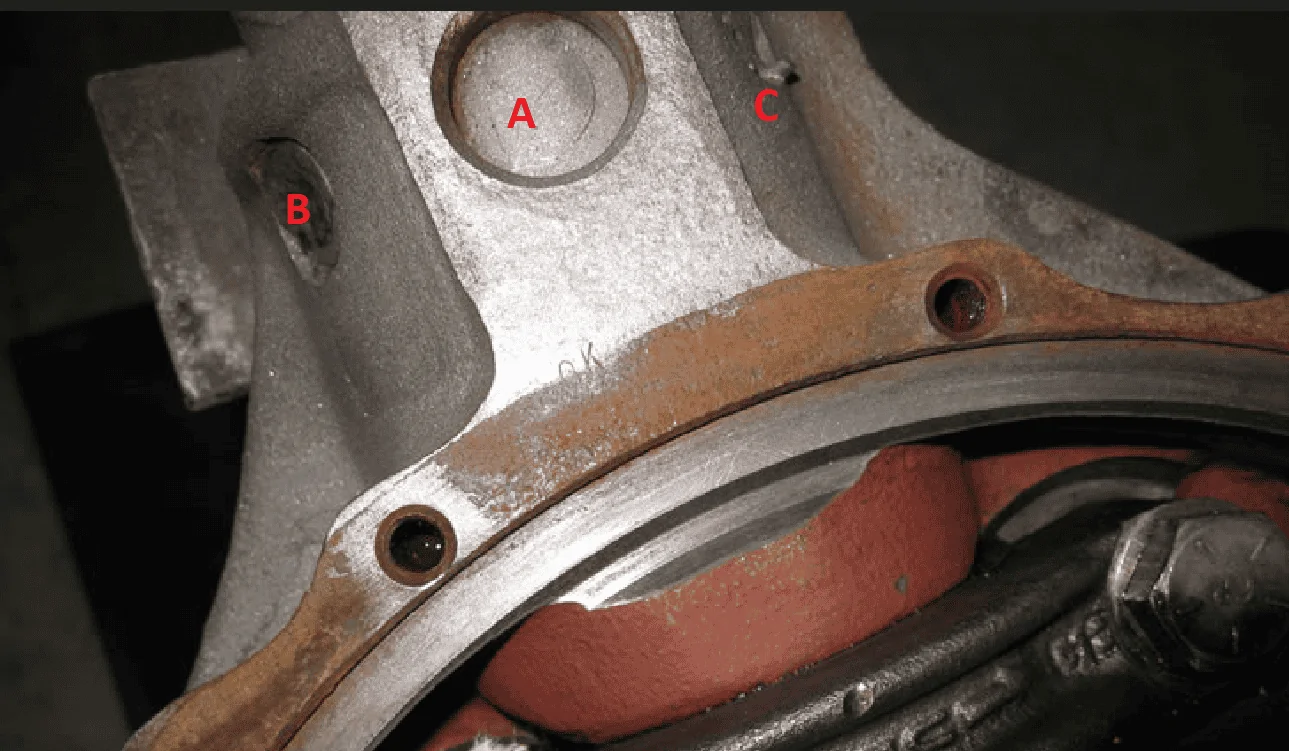

In this example of a 1970 axle I was rebuilding -
A is where the differential case spreader gets a grip to spread the case when inserting the carrier.
B and C are where the tube is welded to the center casting.
There should be no weld in A
There should be welds in B and C in this example but it's not where it seals.

Hi- i edited slightly and added pictures...please reference original post for pictures of the "seal point" that is leaking on the front axle behind the steering dampener. vehicle mostly drives straight, does wander though, such that the wife and kids don't like driving it on the highway. looks like the axles aren't made with much finish quality control. also note the slight leak at the bottom of the differential cover. anyone else have leaking from the front axle and differential cover like this?

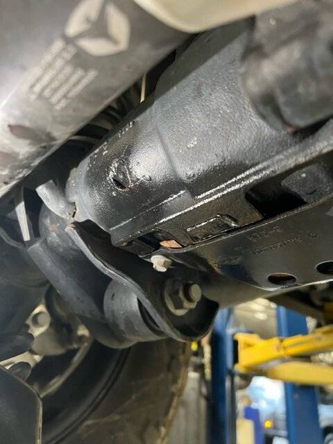

Looks like it is leaking at the plug welds where they insert the outer tube into the main body and weld up. That should be a drivetrain warranty item. You need to find another dealer if you are getting pushback on that.

Seeing the pics, that's where the leak appears to come from.
It would mean either the welds burned through the tube or there's physical damage.
The dealer should follow normal procedures for troubleshooting any leak - clean the heck out of it first, drive it a bit and recheck it.
If it's a burn-through they can scope for that as well.
That's the only ways you'll have a leak there.

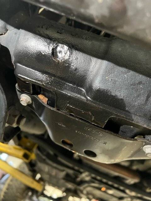

The first 3 photos look like it's leaking by the FAD, which I would think might be warranty. The last pic, however, shows some impact damage to the bottom of the diff cover, housing, and one of the cover bolts.
