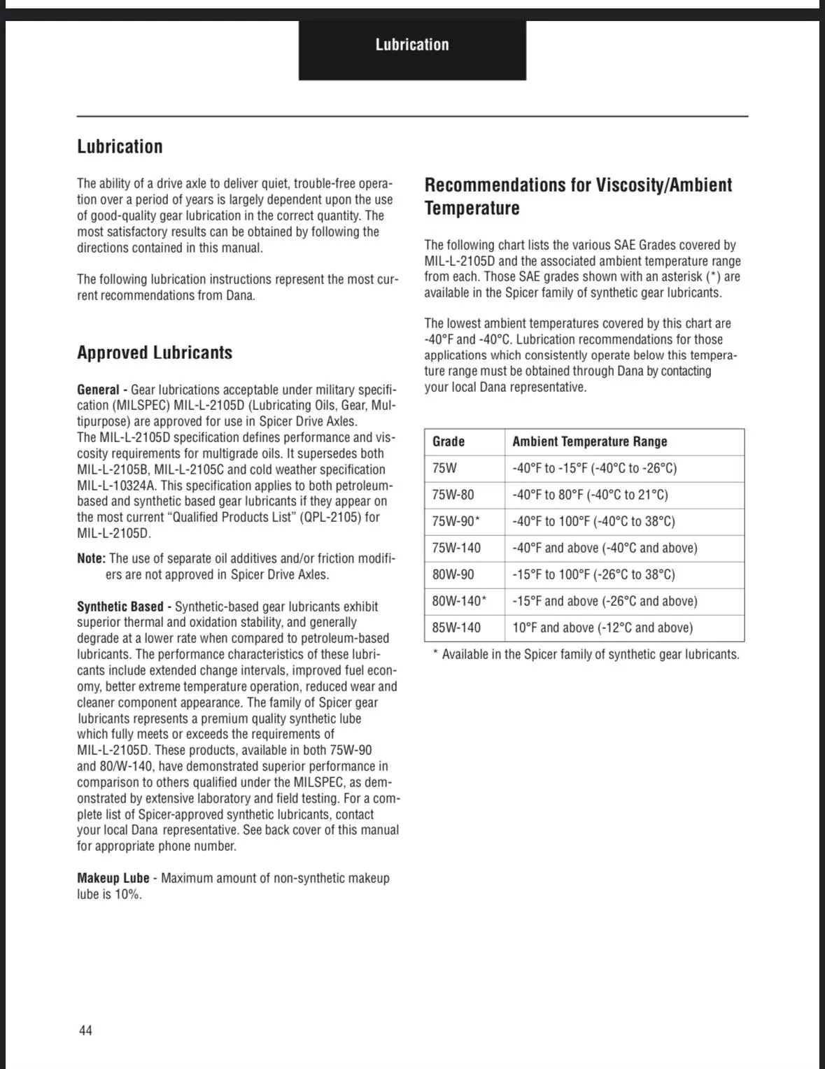

I am a newbie, but I decided to do my diffs myself. I’ve been researching for weeks, most of the good stuff comes back to here.
I wanted to share one thing I saw, and get opinions, as I am in sari Arizona, where we experienced a month of temps over 110f.
This is in a Spicer spec sheet on the
Jeep Gladiator Differential/Axle Fluid IMG_4428
Dana axels…
It looks like if we are in temps over 100F regularly, we should use the XXw-140, it’s for a different axel I think, but it seems that this is generic or standard.
The doc is
“Service Manual
AXSM0055 April 2011”
just curious what you all think?
