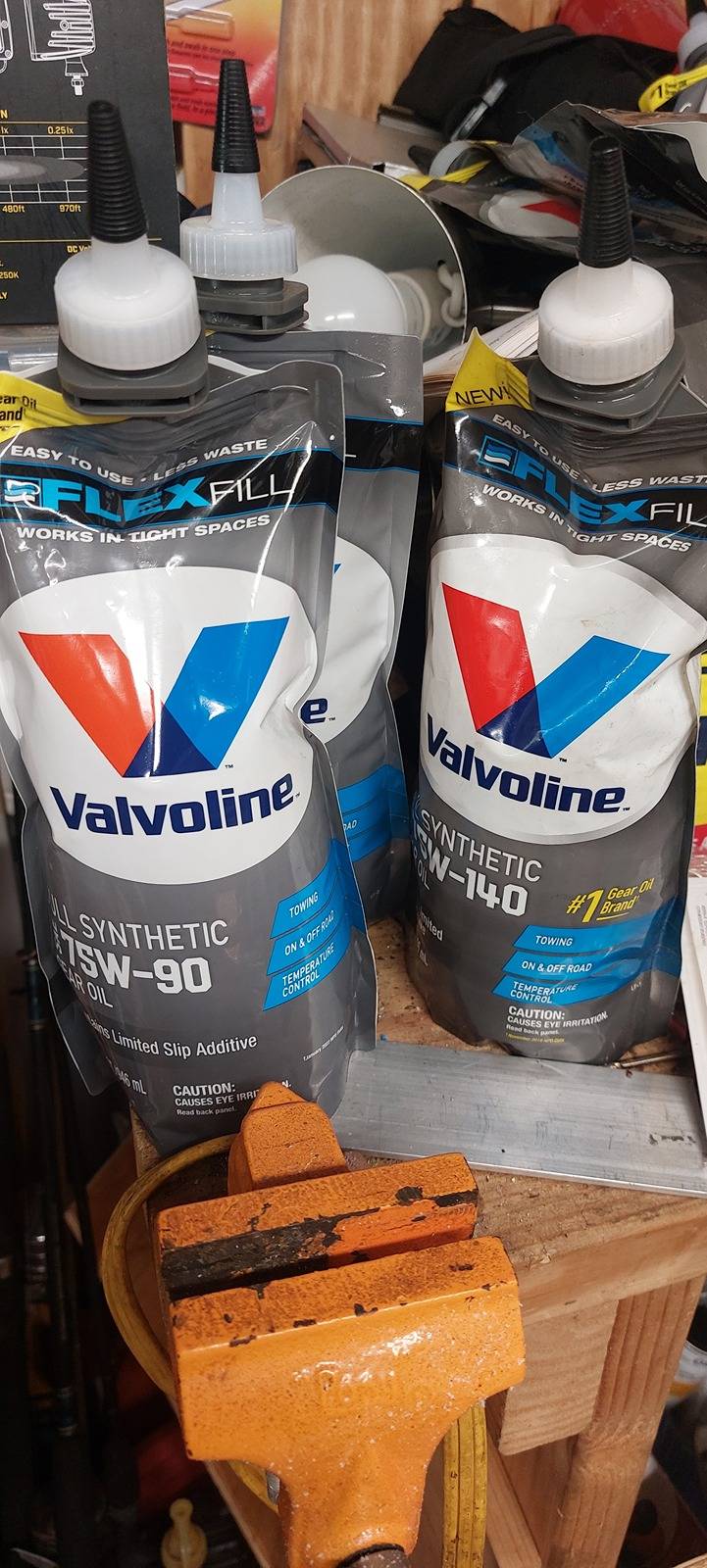

The bladder is easy to use, then refill with the gallon containers of gear oil. My only "first choice" is synthetic of best priced brand. But I have 10 axles that use the stuff.
Another tip is to save the empty bladders, (clean out then filled with ATF) it makes filling T-case up a lot easier too.

How do you clean them out?
Unscrew top flush with choice solvent drain n dry re-use. In my case since I was going to flush a transfer case a few times I just filled with ATF and used them for that. for Reuse for gear oil, nothing but refill and use. Dang sure easy compared to dragging a gallon of whatever fluid your refilling then trying to pumped into dang fill plug hole. Needing 3 hands one to hold tube in hole, one to pump other to keep it container from turning over or moving around.

For a LSD rear, if the valvoline squeeze pack 75w140 already has the friction modifier should i add the Mopar additive? would it hurt if i ran the same 75w140 in the front to save money on a gal?
Hootbro
Apr 13, 2019
58
10,329
20,361
2025 Gladiator Sport
I would add the modifier anyways. It is a mixed bag on whether or not it is needed with Valvoline. A bit extra modifier is not going to hurt anything.
would it hurt if i ran the same 75w140 in the front to save money on a gal? Sponsored
Yes, you can use 75W-140 in the front also. It is what DANA ships with in their aftermarket sold Advantek assemblies.
