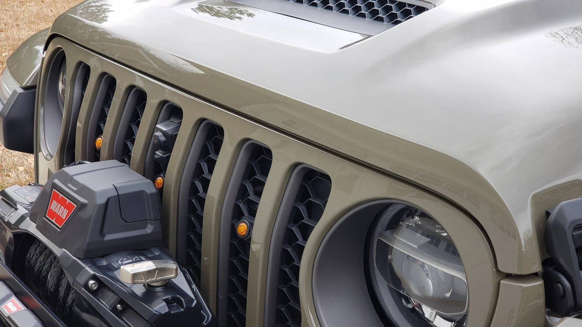

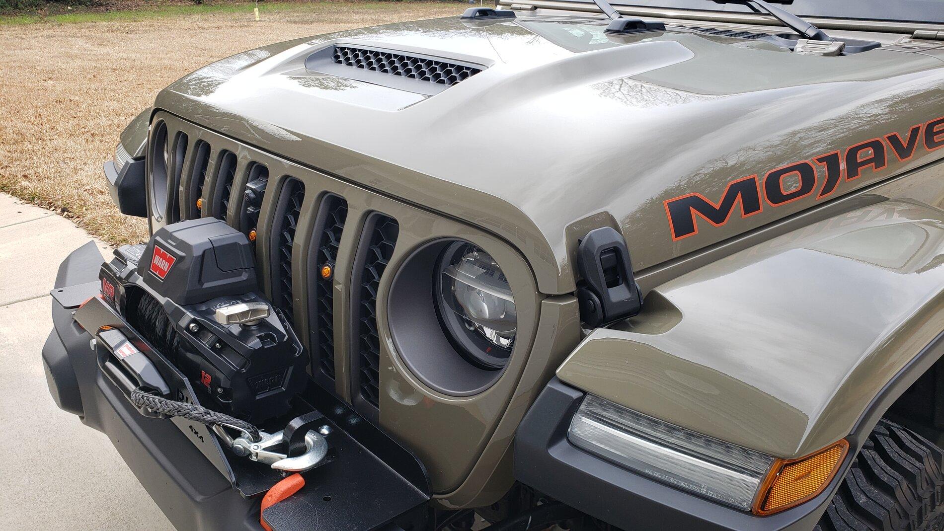

Here are pictures of them installed with the front camera and winch. I won't be doing the electrical Saturday as I will be out in the dirt and mud all day.
Shot from Front:
Jeep Gladiator Anyone install Quadratec pre-runner lighting? 20210107_114603
From the right side
From above and right.
Jeep Gladiator Anyone install Quadratec pre-runner lighting? 20210107_114553
The controller hump on the Winch can be relocated, so I'll have to make that a future project soon.

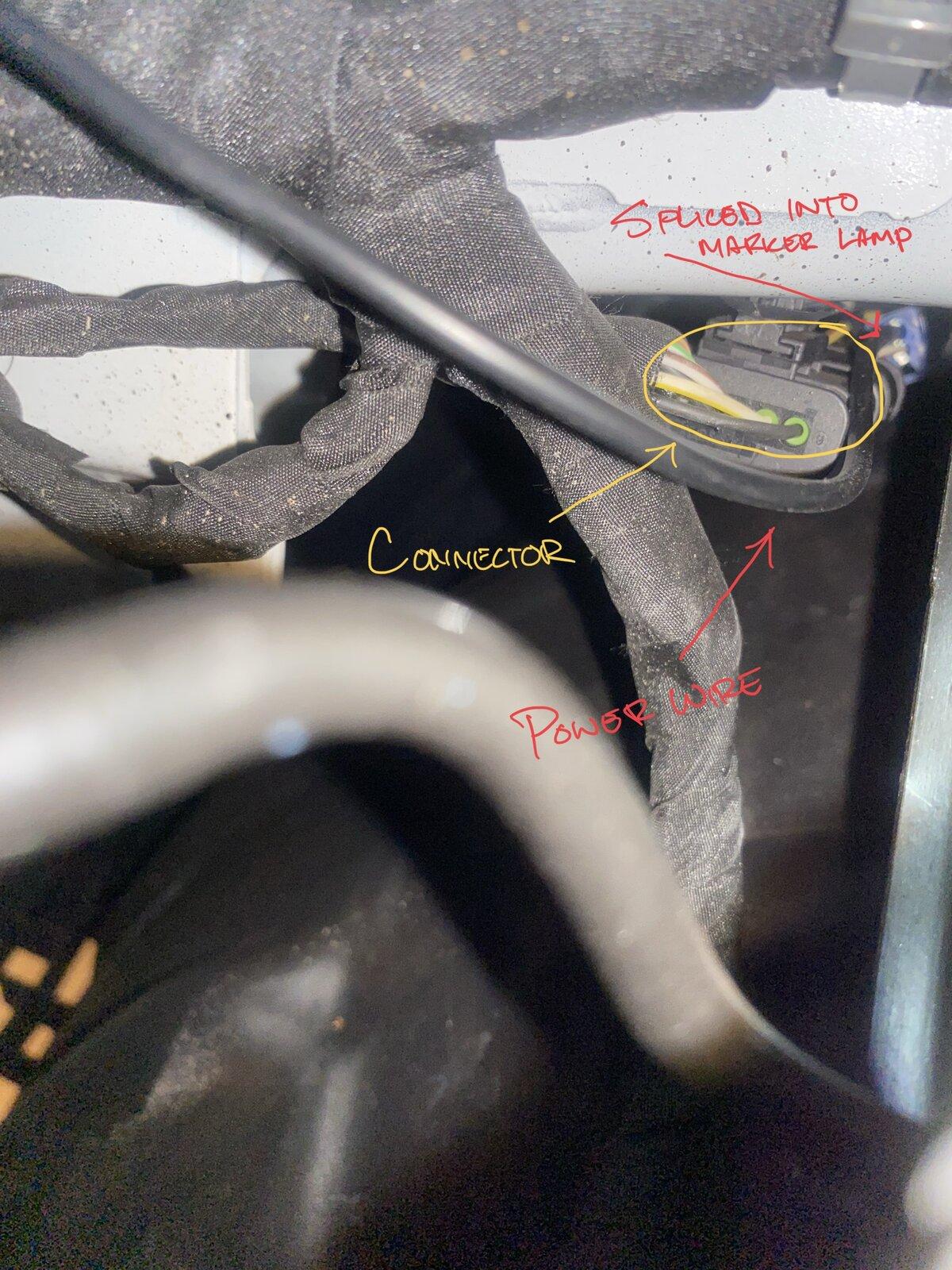

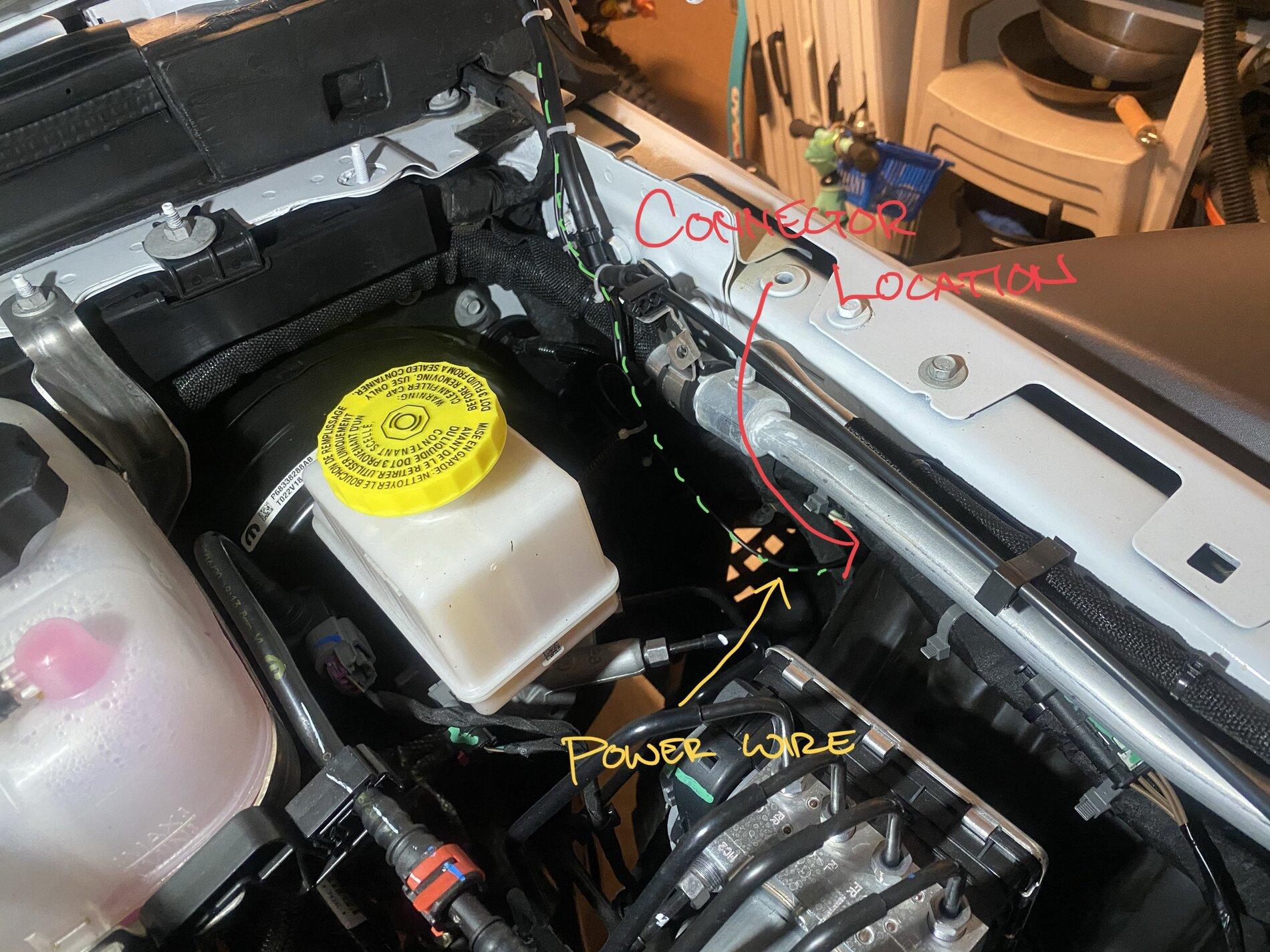

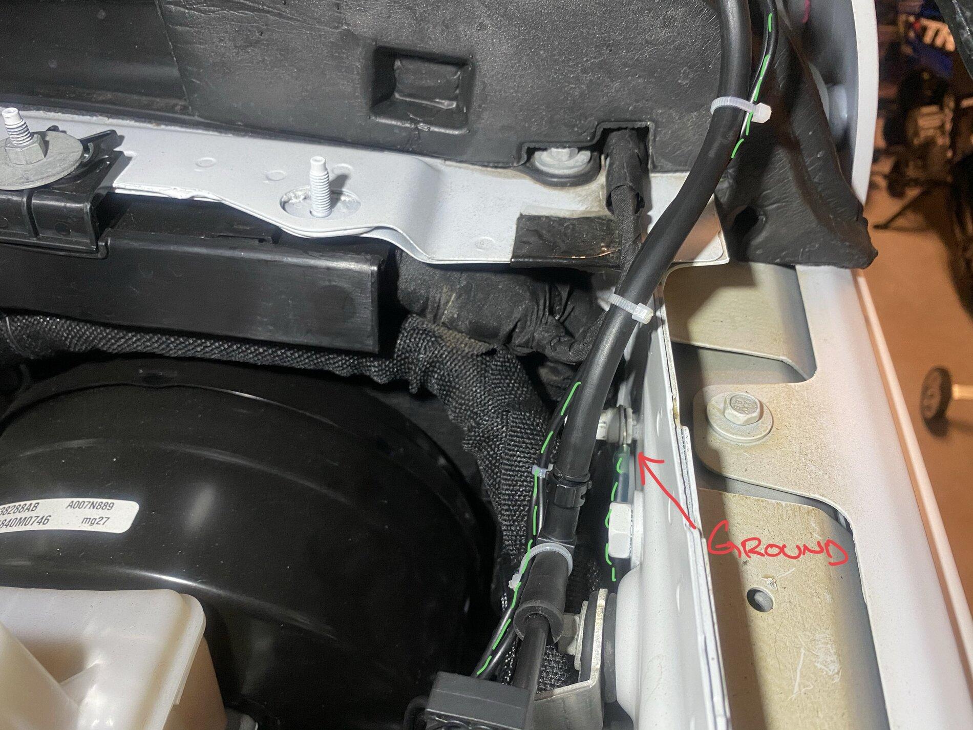

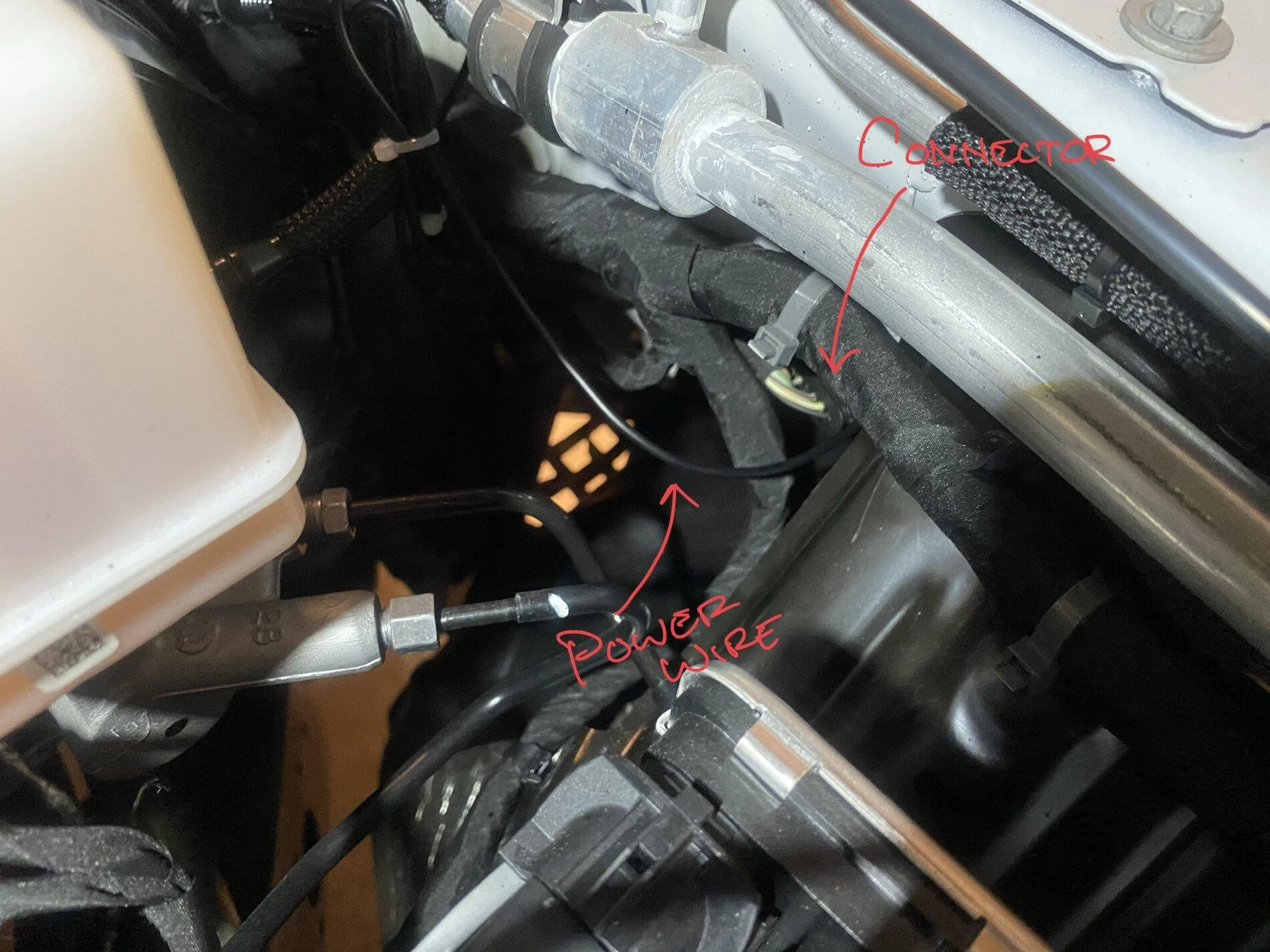

The Quadratec kit is plug & play if you are installing into the Grill...
I made my own & spliced into the white wire w/brown stripe after the Harness connector (it’s the positive lead that feeds the LH/Marker lamp)
