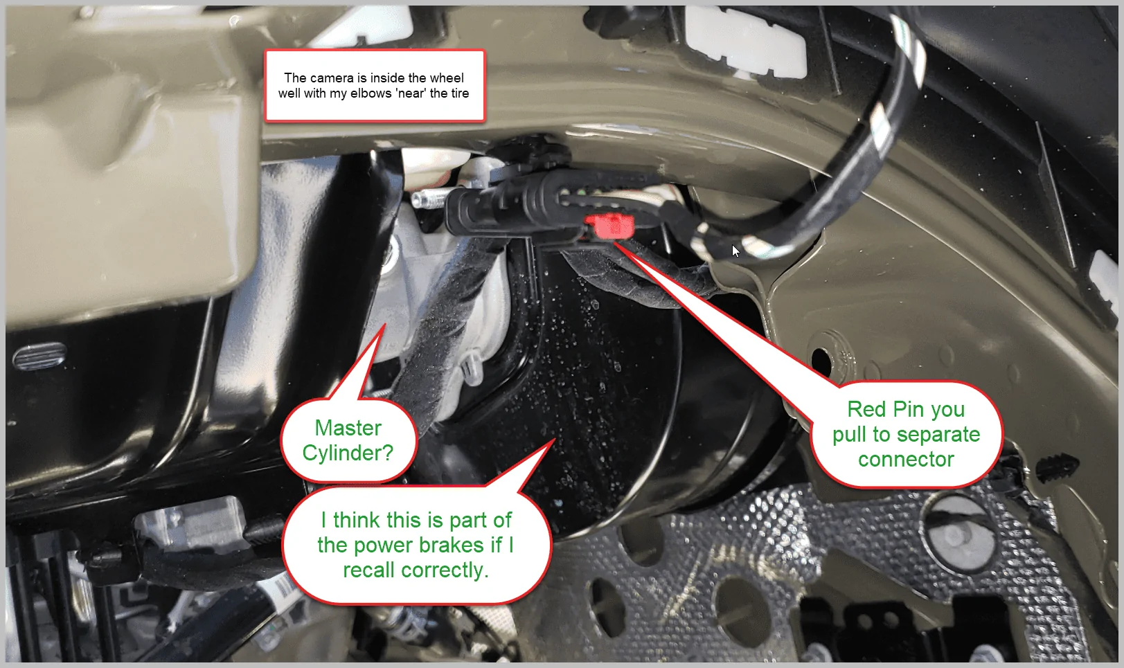

I posted a thread in this Forum on my Install...

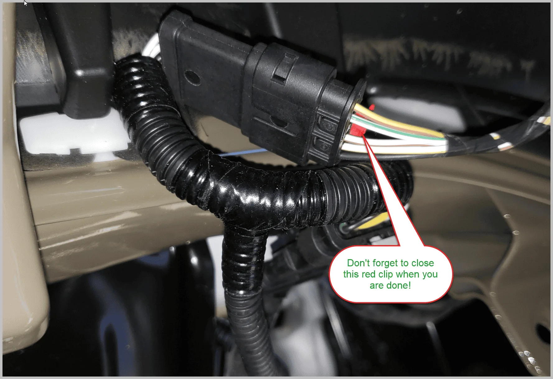

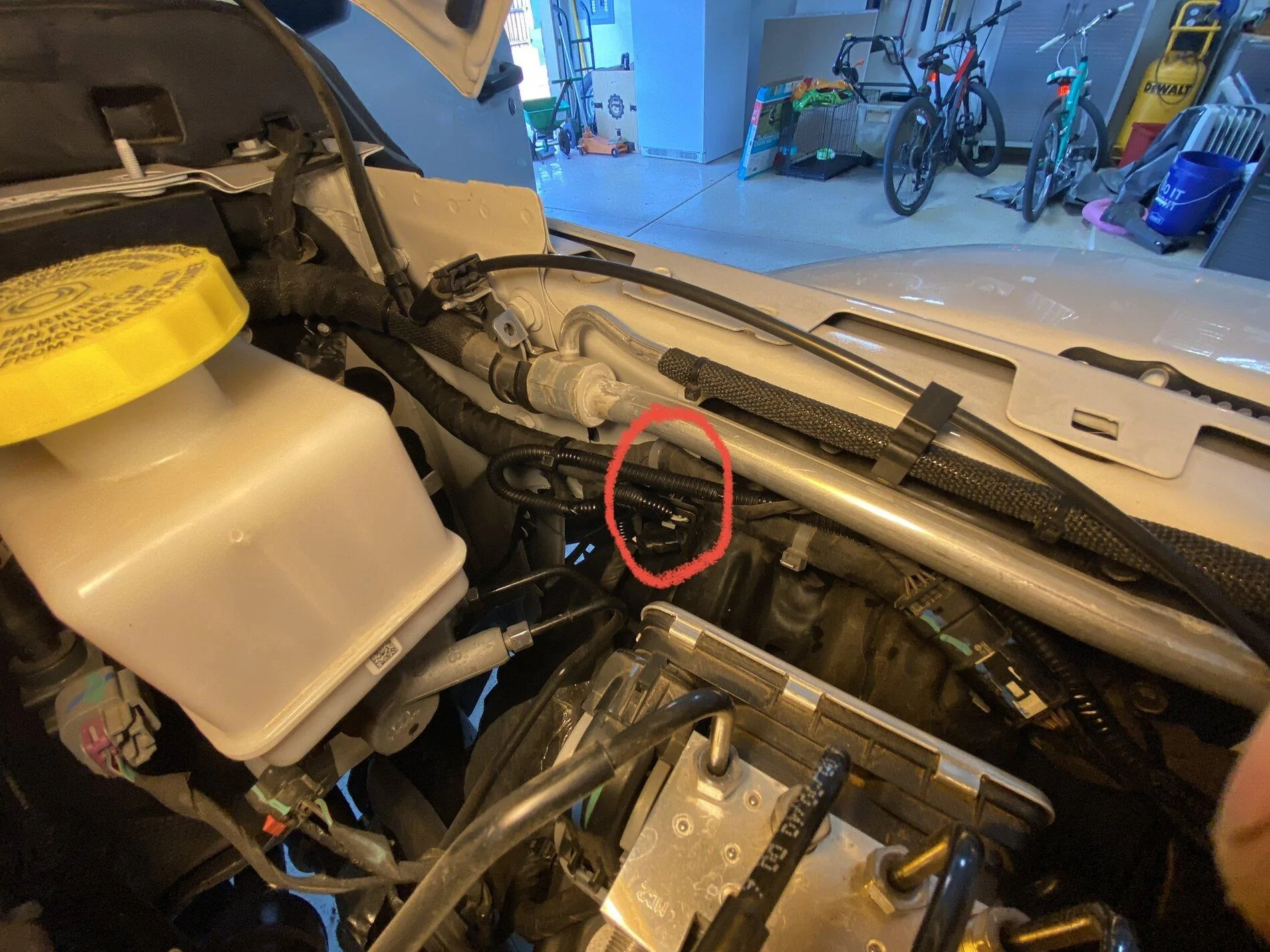

The connector for the Left side Marker light harness is tucked under the Rear upper side of the left fender (best i could describe it)
I attached a few photos i took at night (sorry for the blurr /phone case sucks!)
https://www.jeepgladiatorforum.com/forum/threads/mojave-diy-prerunner-lights.38986/

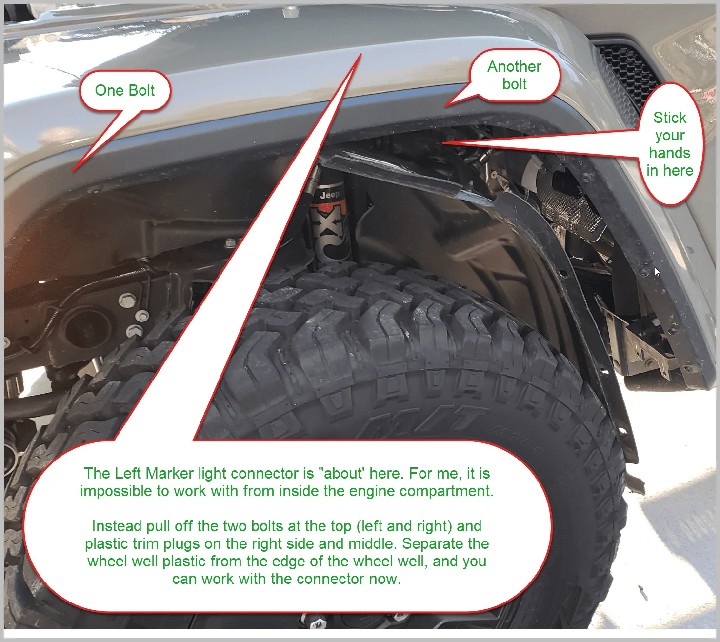

I used your pictures to find mine. It was near im[popssible to get to as mine is installed horizontal to the ground not vertical. I took pictures in case anyone else wants to see what it was lie on my Mojave. I'll post them in reply farther down the thread. Thank-YOu DMXRacing!

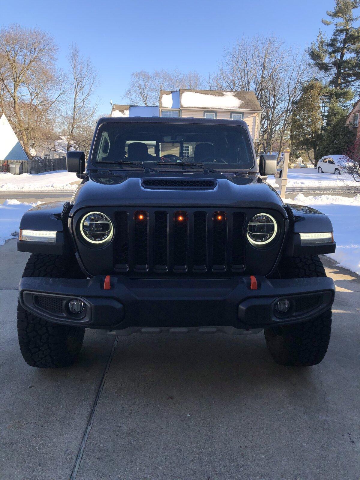

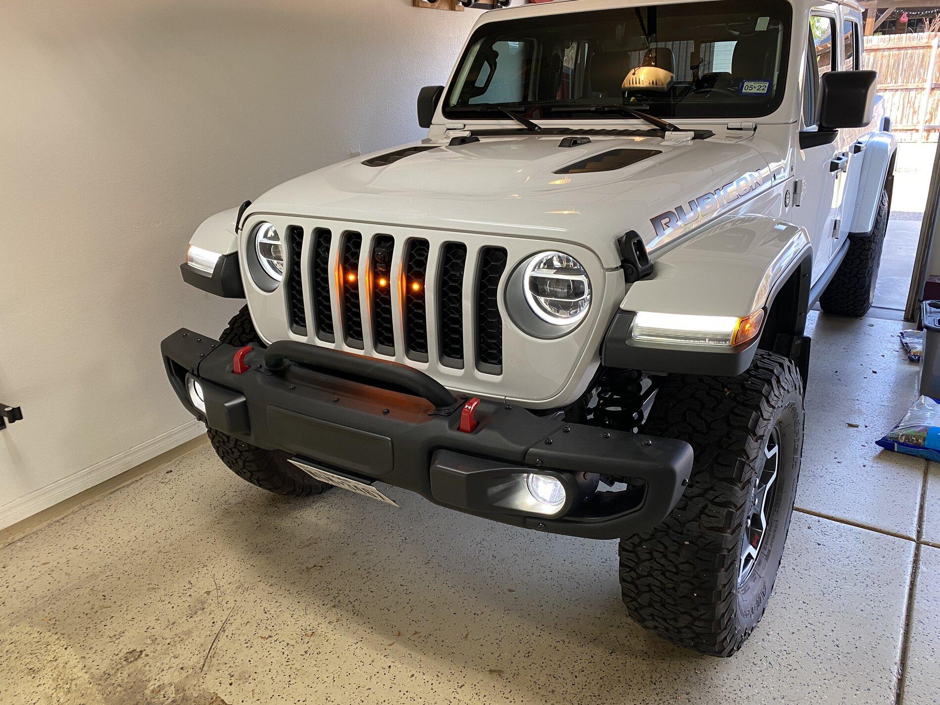

I want to do a 4 light version- adjust the spacing to skip the center where the trail cam is installed. Quadratec said they didn’t have plans to offer a 4 light kit any time soon. Ignoring the cost of buying 2 sets- how hard do y’all think it would be to splice in a 4th light to the set up? And would the lights fit in the outside grille slots?

If I were to do this, I would put three attached to the left side marker lights, and tie the other three into the right side marker lights. The connectors are seperate. Disconnecting the left side marker lights did not disconnect the right side. I checked. Now you'll have a 6 light setup!

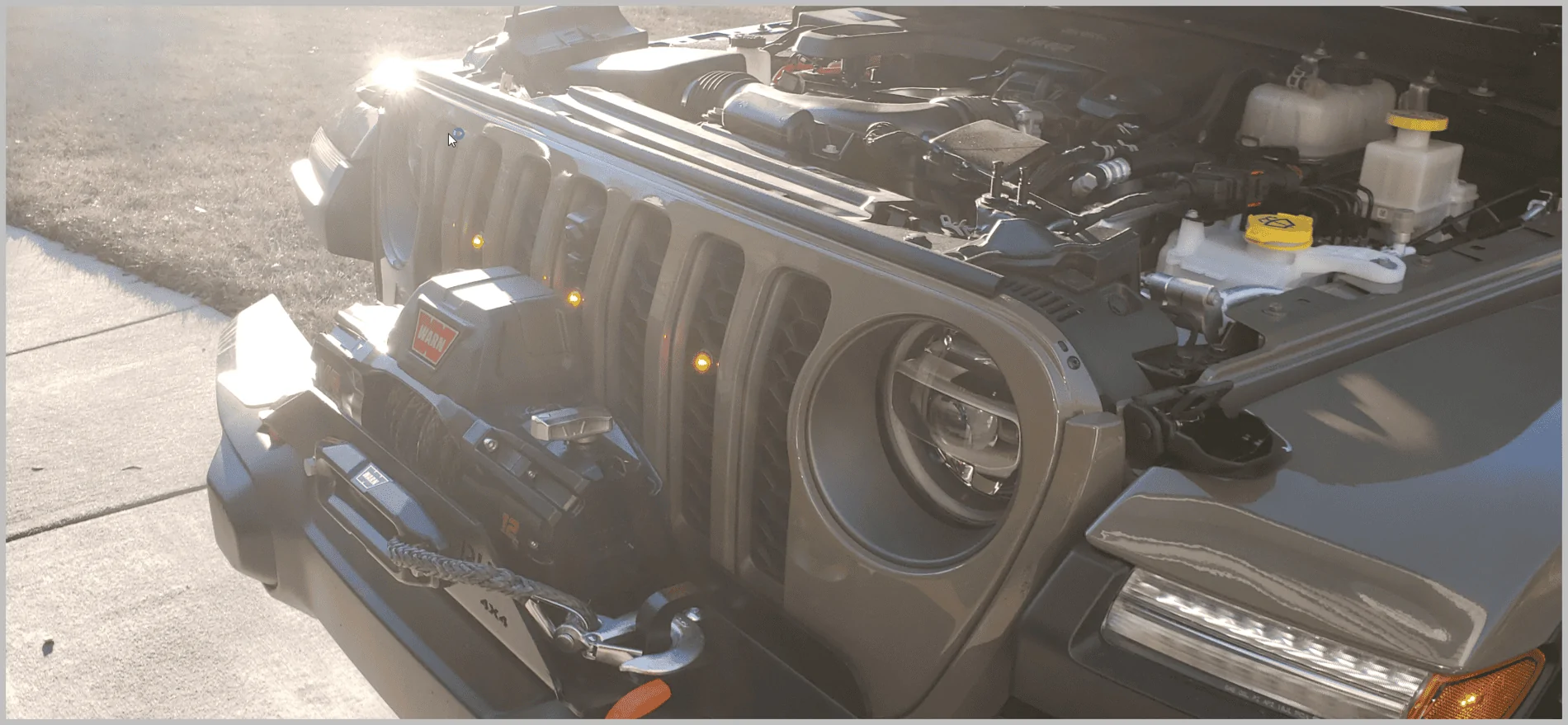

Where it was on my Mojave. Follows are some pictures for anyone it might help.
Jeep Gladiator Anyone install Quadratec pre-runner lighting? SideView

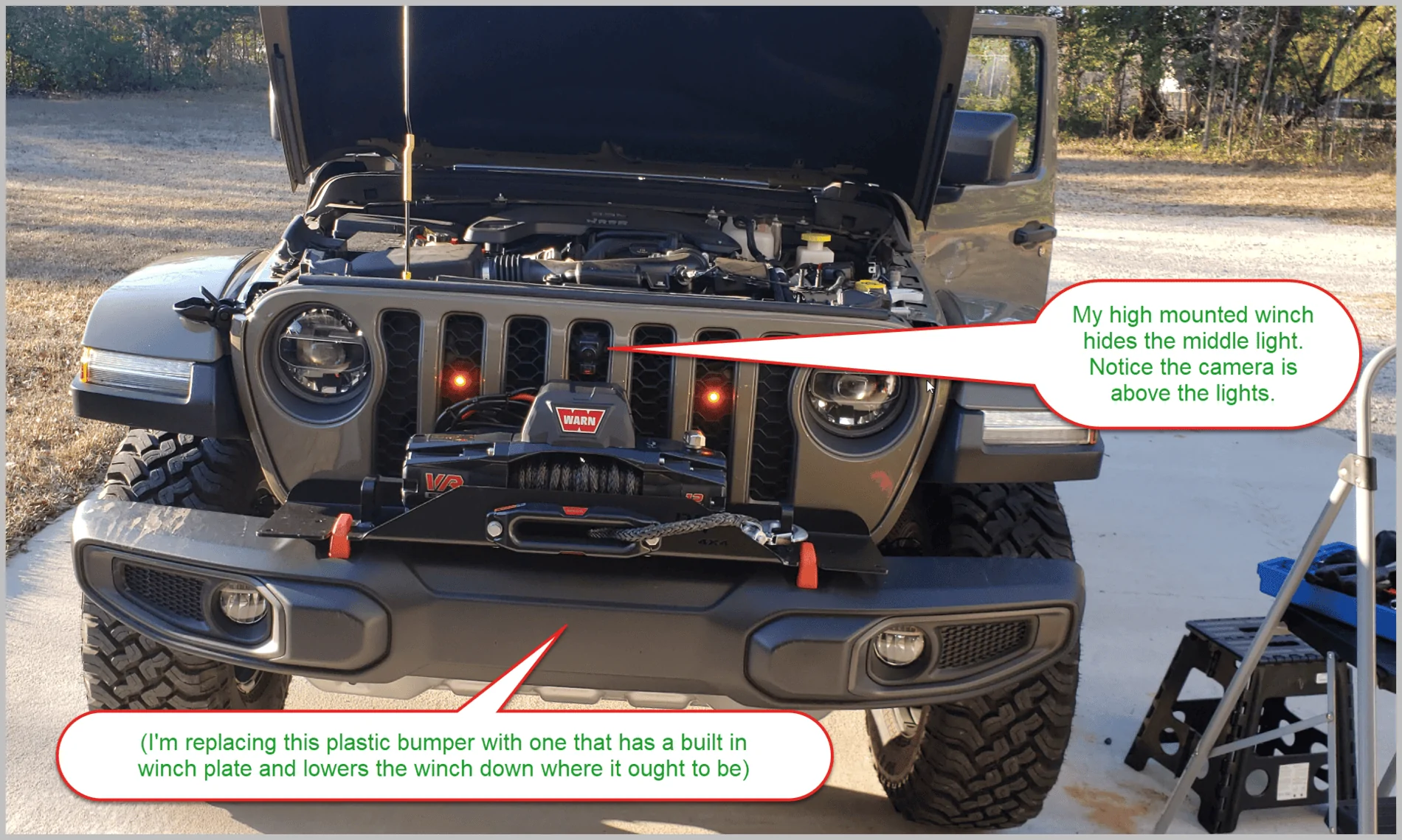

Thanks everyone who guided me through this journey.

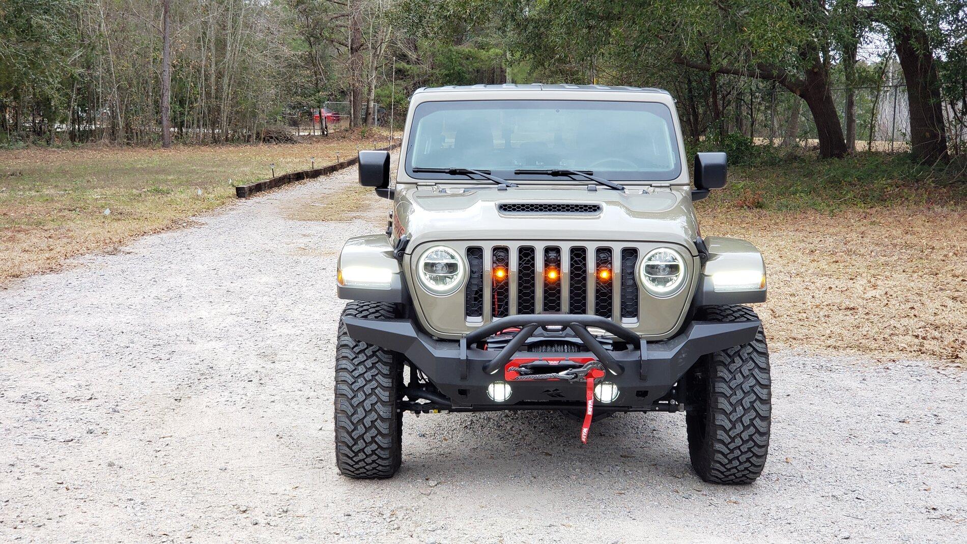

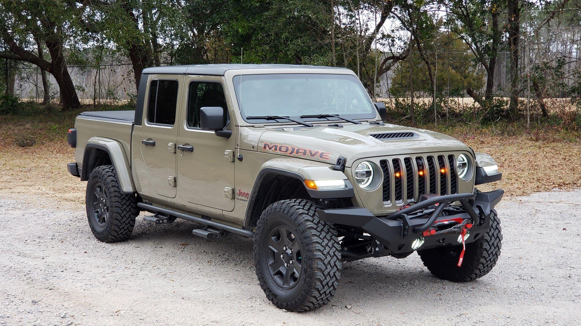

UPDATE: I didn't like how high the Winch sat when mounted on a Winch Plate on top of the factory bumper. I replaced it with the Rugged Ridge HD Full Width. (Which was a good install) Here are updated pix with all three pre-runners visible now.
Jeep Gladiator Anyone install Quadratec pre-runner lighting? 20210124_165044
Looks great, want to sell the steel factory bumper? I’m in Ohio,

It was the plastic factory bumper. It did have the steel skid plate (a silver-ish color) and will be getting rid to the RockHard WInch Plate. The winch plate would make some good bullet proof armor though. That thing is built like a battleship.

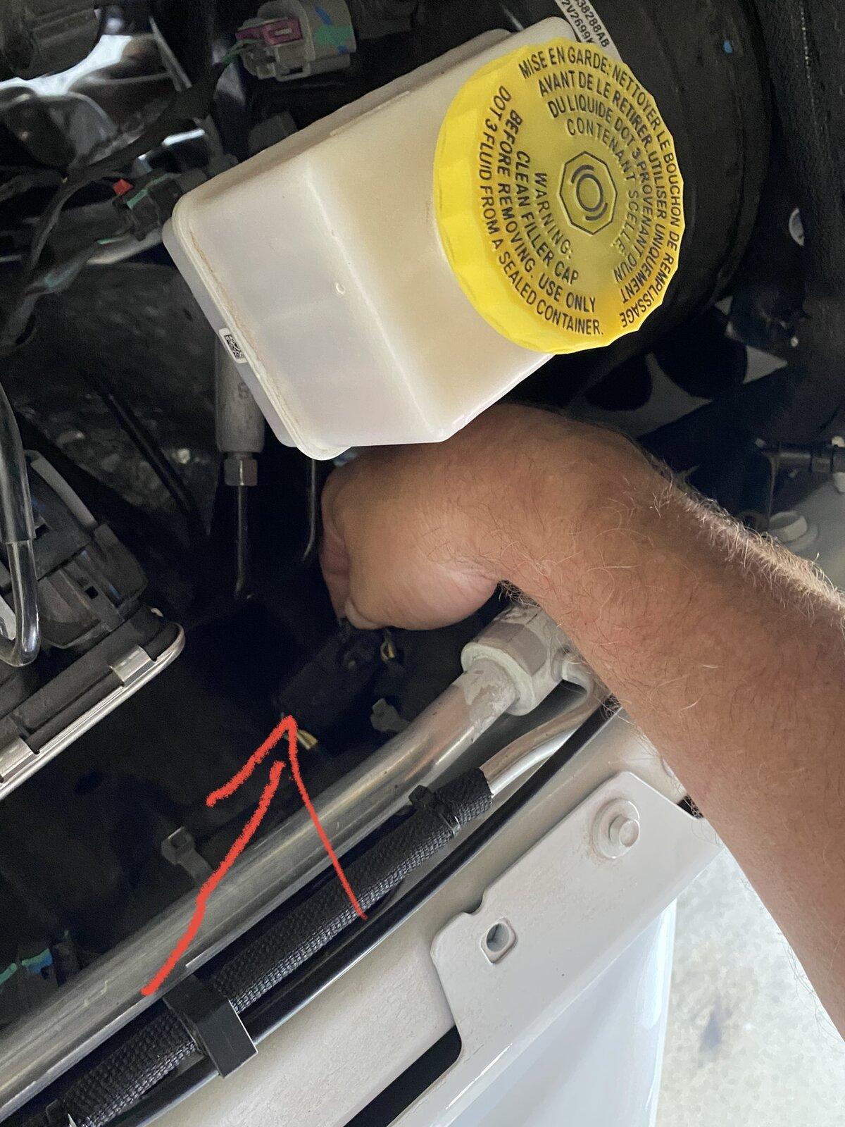

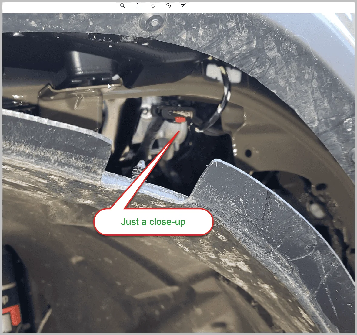

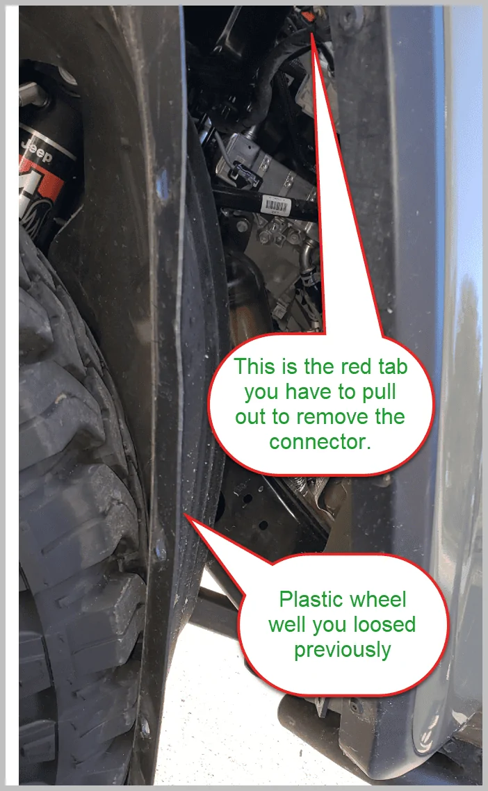

I was able to get to connection from under the hood on my 2020. I started to remove the fender liner and then fingered out you can reach the connector from under hood. There is a plastic fastener that secures the connector to fender. I pried the connector loose and you can disconnect it easier.
