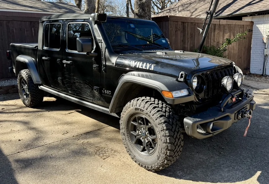

If so, please post pictures and specs. Three years in and I think it's time to give her a lift and some new shoes. Thanks!
Current setup:
Tereflex 1.5" level up front
Rubicon front fenders
Factory Willys wheels with 33" Rubicon tires (Wild Peak M/T's)
Rubicon front bumper w/factory Warn winch
AFE DAS snorkel
Factory '24 grille

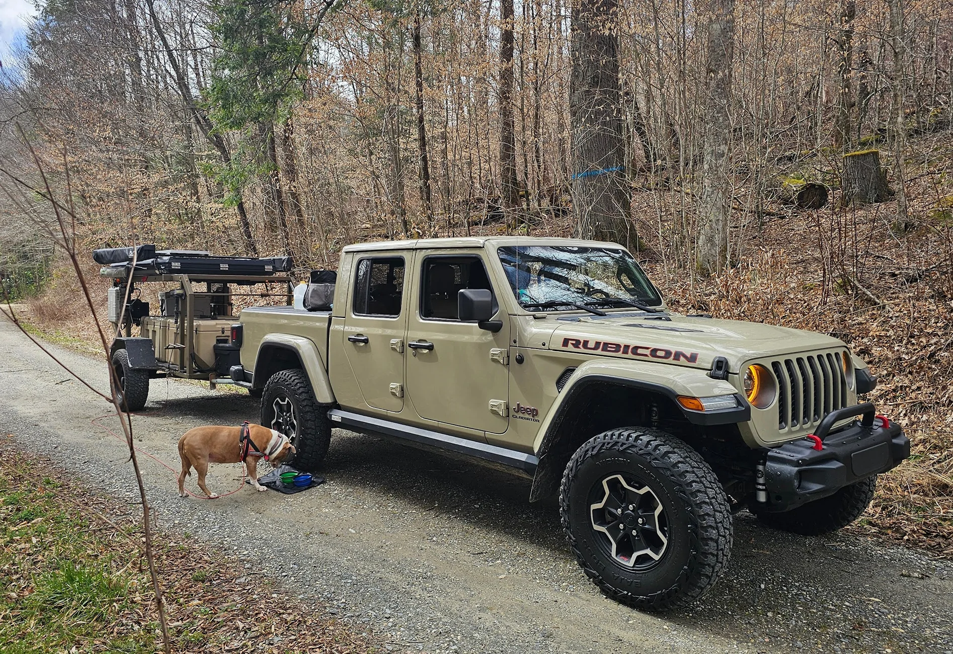

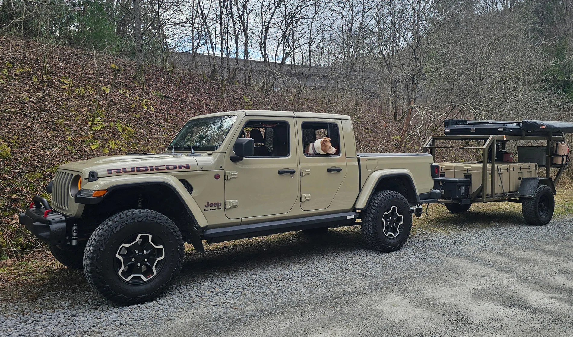

These were both taken right after I installed the 2" Mopar lift. I believe those were 255/85r17 Baja Boss tires on the stock Rubicon wheels.

That is the look I'm going for! And it looks like the Mickey's are the only option for that size right now, at least at Discount Tire.

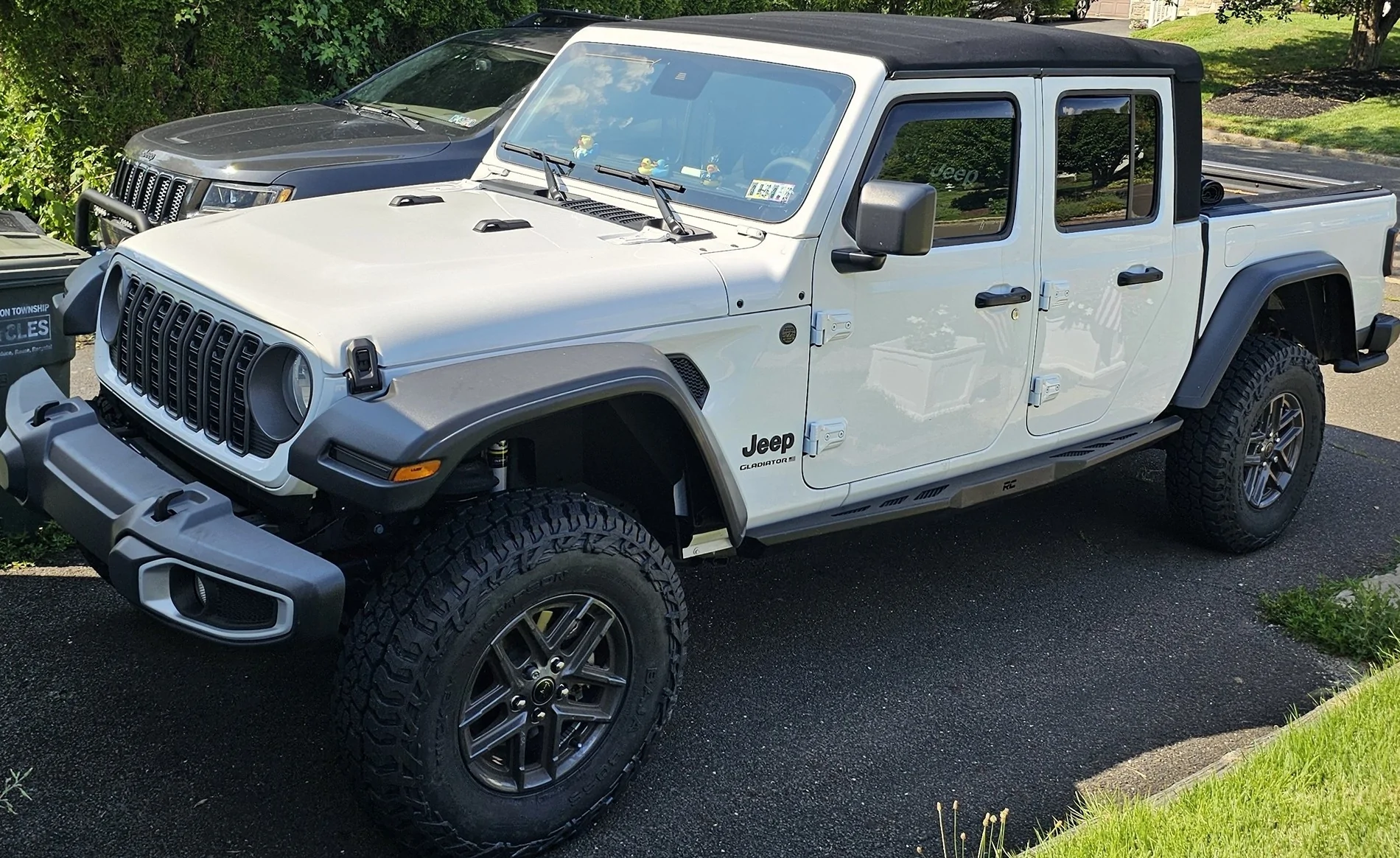

2 inch mopar lift and Mickey Thompson baja boss tires 255/85R17. Very happy with everything.

That looks great. And on factory wheels too. Did you have to use any spacers, or any rubbing issues?

No rubbing issues and no spacers. I like the factory wheels so thats why I went with the skinny tires. I think you can go as wide as 11.5 inches on the factory wheels. My fender flares are aftermarket flares that are high arched like the rubicon flares. I could fit 37 inch tires if I wanted to but I will be sticking with the 35's.
