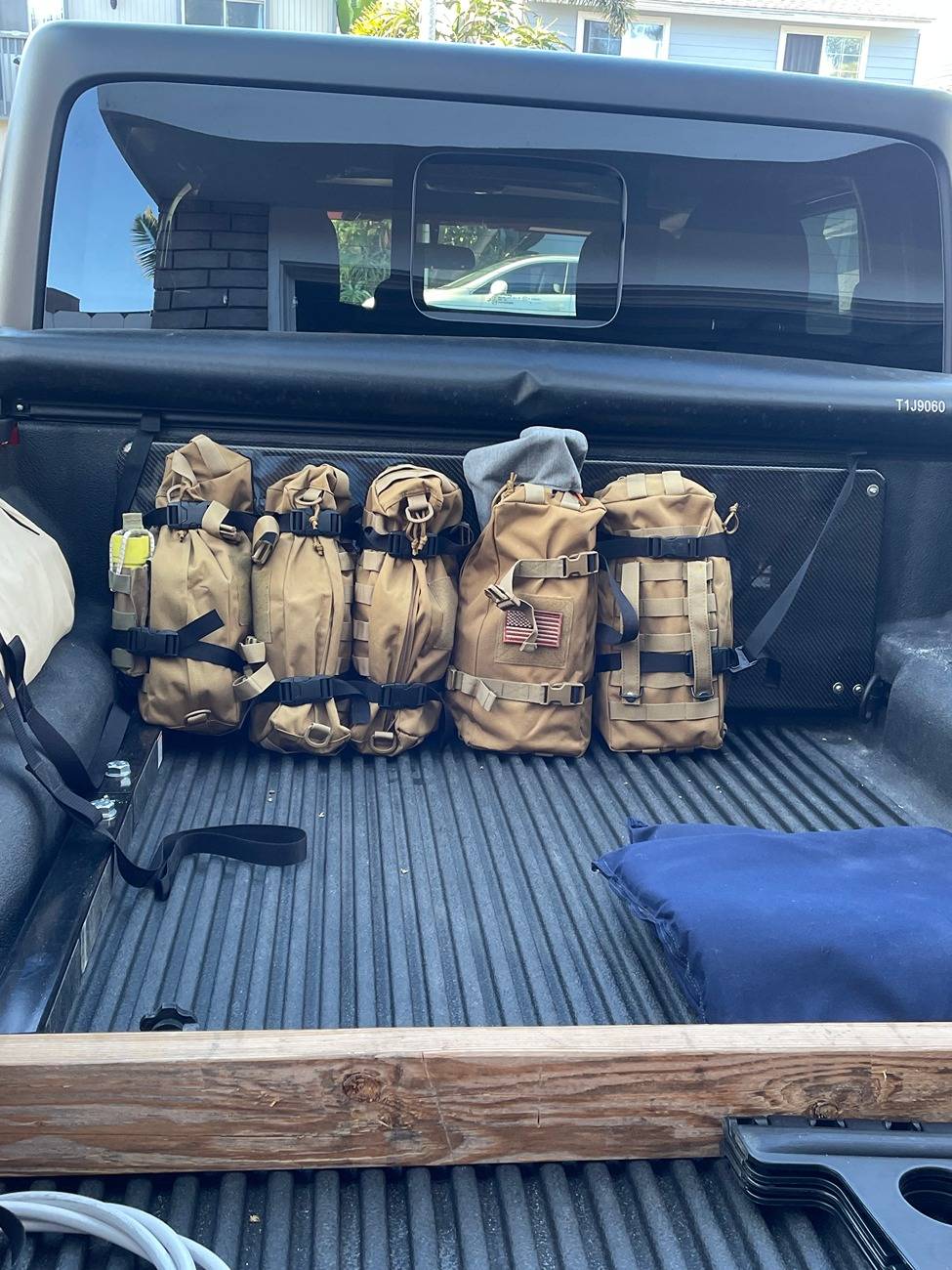

I made a carbon fiber panel and used trail rail threaded holes and tiedown bolts at D rings to mount it. ( i have bedliner too) then mount whatever you want.
Jeep Gladiator Anyone storing traction boards on back bed wall? IMG_2221
s a lot lighter than steel molle racks. I cut slots for straps and have modular storage bags from Amazon. Tiedowns, water, tow rope, the bag with grey top is CO2 tank,, and first aid. I have since added small backpacker stove and Stanley french press in another bag as the wife needs a pick me up in the afternoon. panel is strong and light. prob about 5# max

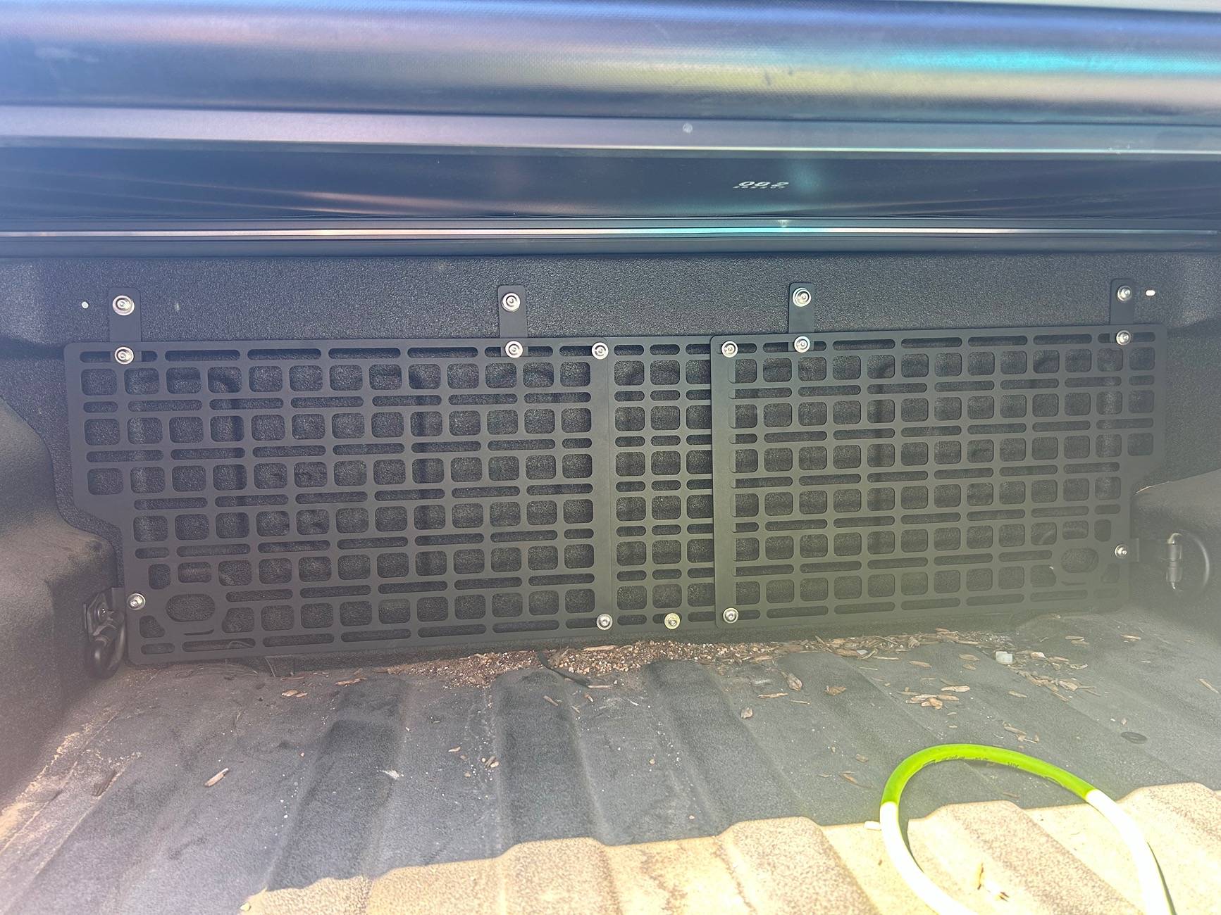

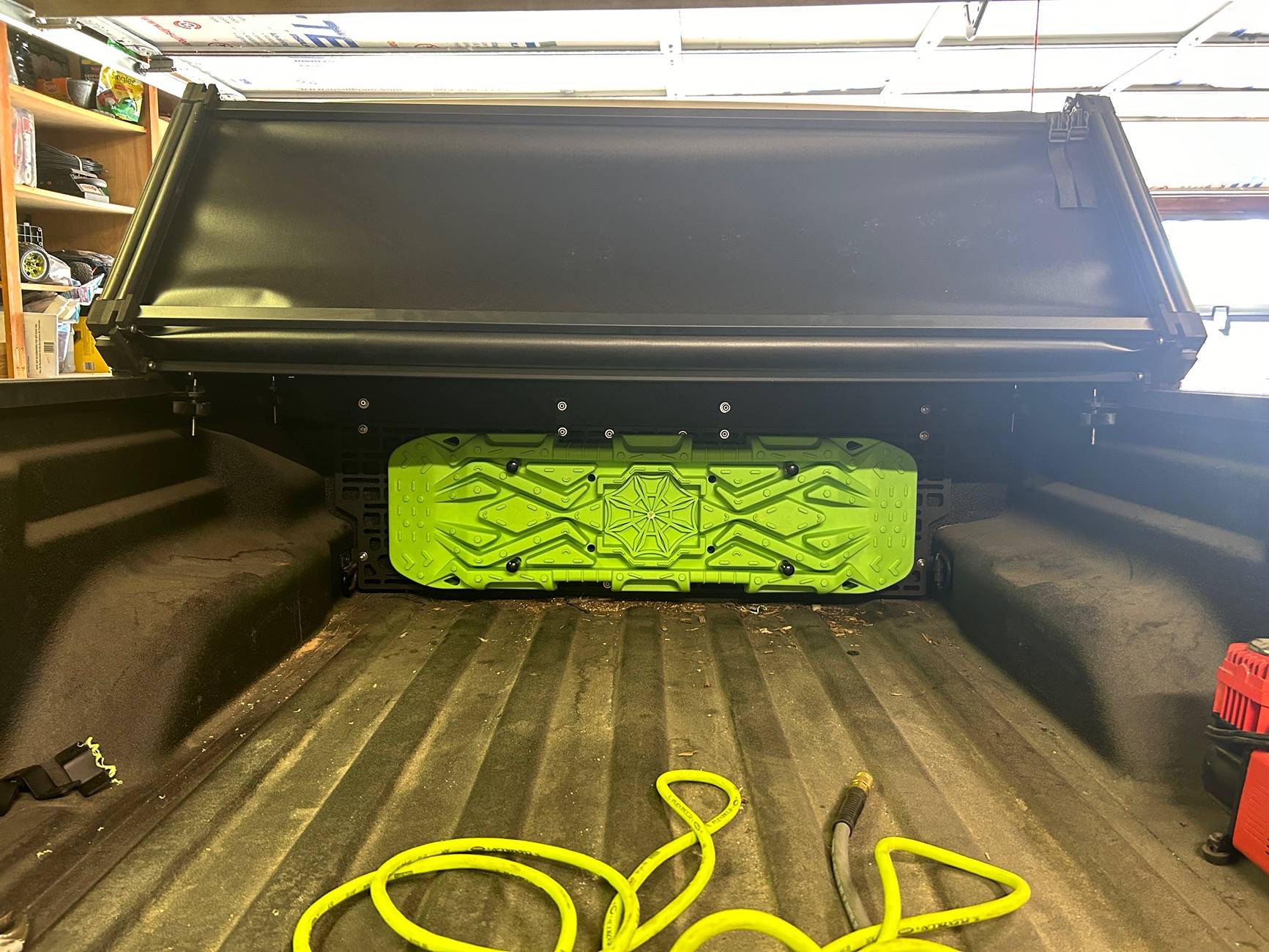

I used some HomeDepot hardware and secured it to existing mount points on the bed wall.

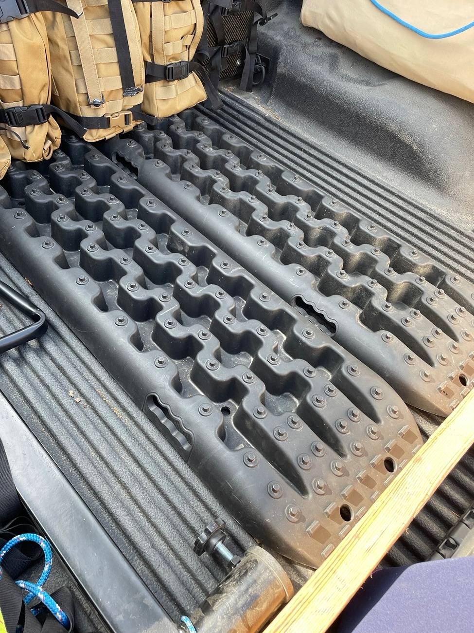

mine fit
Jeep Gladiator Anyone storing traction boards on back bed wall? IMG_2359 (1)
t wedged between cab and 2x4 bed strut.
