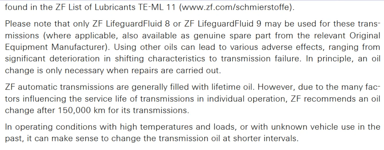

But here's my experience with the 3.6. The oil filter housings all crack around the 80-120k mark, dorman make an aluminum replacement, it sucks to do, since it's an oily mess, but there is a fix. From the factory the front and rear diffs were pretty much dry, mine was bought used at 13k miles, i checked all the fluids as soon as it got home and filled what was low, the 8-speed automatic transmission fluid is lifetime, according to ZF lifetime fluid is good for 60k miles on the highway or 40k in heavy stop go situations, I'll do mine at 50k. The Transfer case was also low, so i did both axles and the transfer case at 15k miles, Jeep calls for one fluid while Dana calls for another, i follow Dana's recommendation.. I did the fluid again at 36k miles. The 3.6 i do oil every 3k miles with 5w30 and zddp zinc additive to help with the top end. I don't use start stop, because in my last JL i had the manual and the aux battery died at an intersection and left me stranded in a left turn area.

Jeep Gladiator Anyone with over 100k miles on their 3.6 yet ? ZF fluid recommendation
