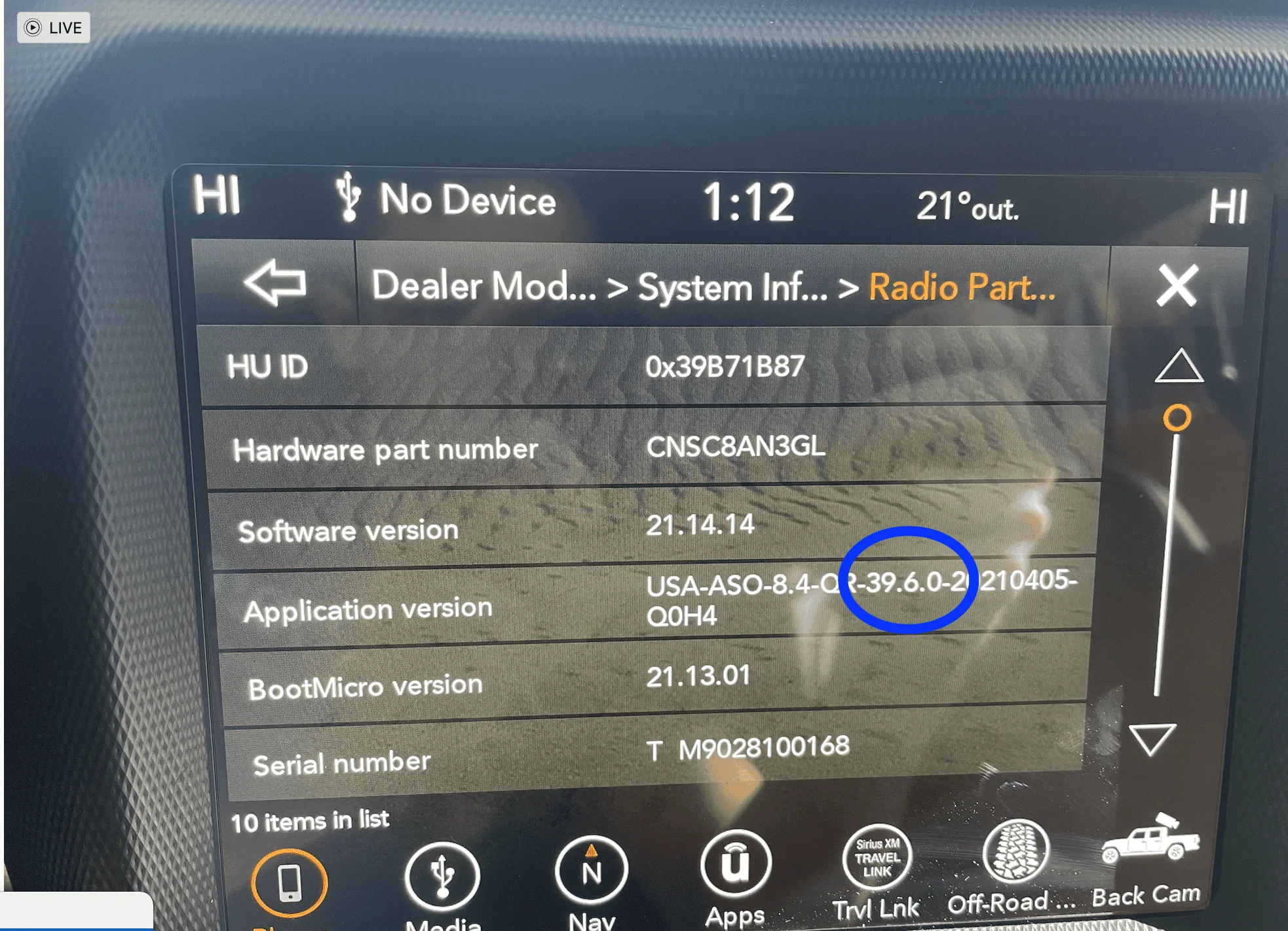

Might help if we compare radio versions also.
Went in a few weeks ago and was upgrades from 22.6 to 39.6 per TSB 08-113-21 I
I upgraded phone and will try it over the next few days. 12 Pro
You can get your radio version by holding the UP and DOWN temp button and the FRONT DEFROST buttons at the same time for about 7secs. Then there is a row called "Software Version" and in the middle will show version. If needed I can get some example photos.
I had a few more menus to poke through before I found the software version. If I found the right thing, my version is only 21.14.14. You are on 39.6!? UConnect site says my software is up to date but that doesn't seem accurate. I can't download an update from the site because it thinks I'm up to date. Do I need to head to a dealer?
Sorry - I did miss a menu and misspoke for software vs application version. That's what I get for trying to go off memory....
The version location is not where many would guess. Go into "Dealer Mode" with the button presses > System Information > Radio Part > Application version > #######. The center number of that is your version. I've attached a photo with it circled.
Yes - you will need a dealer to get this update. Should be free if you're in warranty. I called in mentioning freezing in CarPlay and my dealer knew it was a reported problem and scheduled me for an update. 39.6 was the latest.
My assumption is that the online Uconnect tool is the "Software Version". The dealer updates the "Application version".
