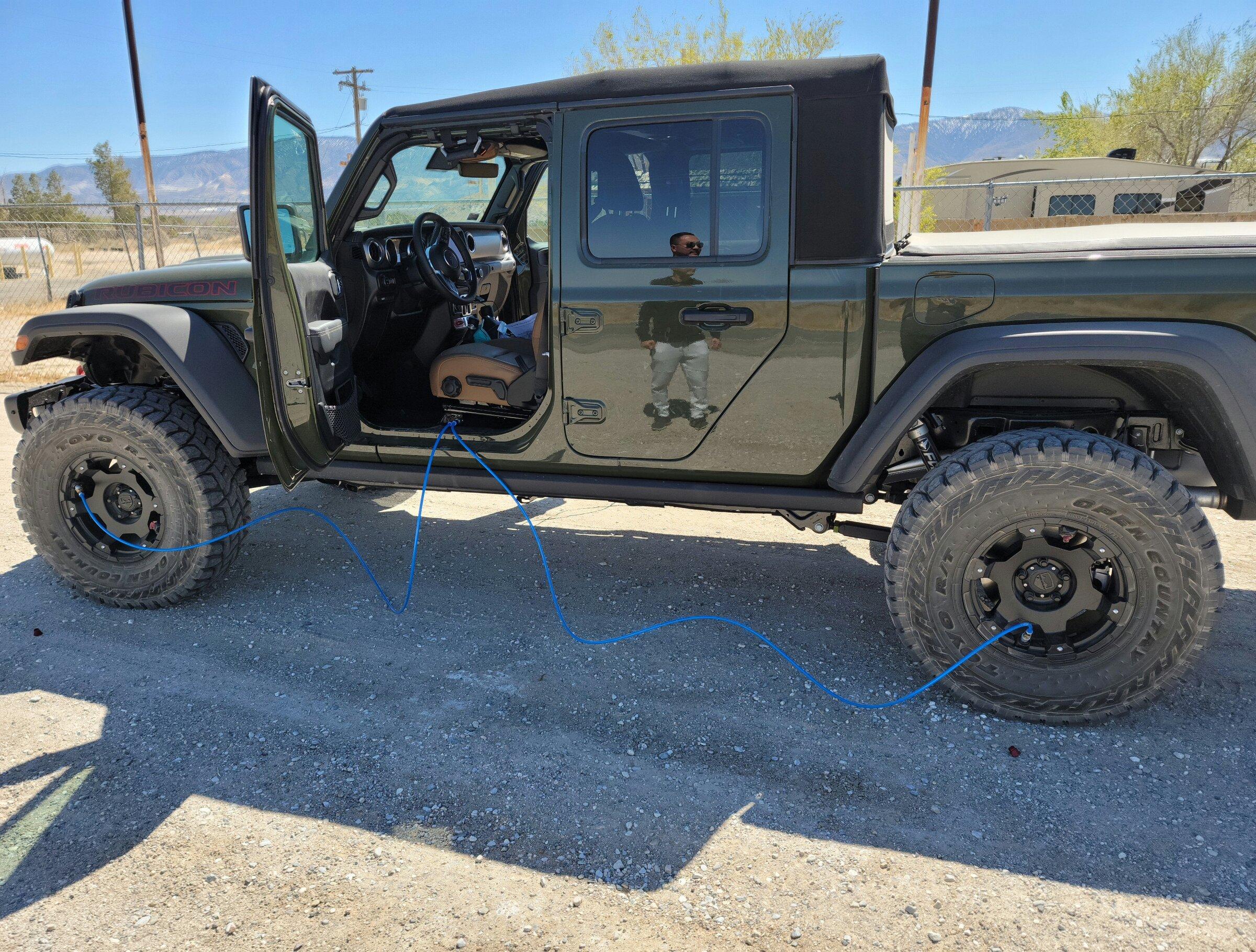

I went with the ARB single and used the ACM bracket and installation guide.
