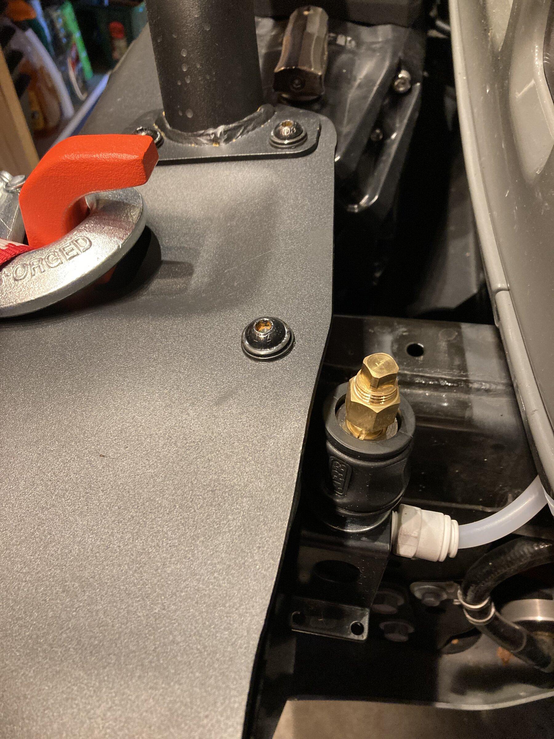

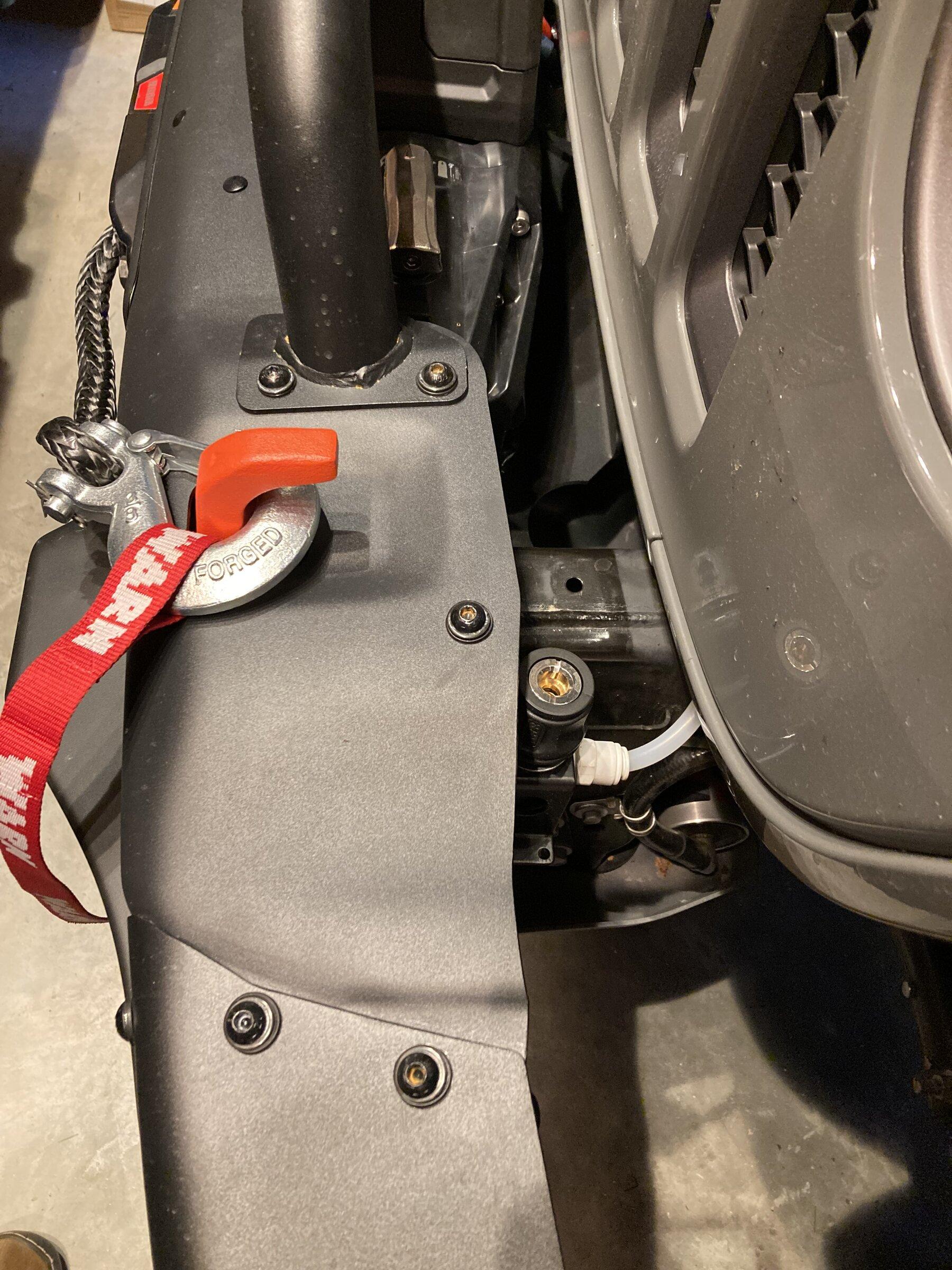

I mounted my ARB compressor to the fire wall on the drivers side of the engine bay. I snaked the tubing up to the front bumper and used an ARB 171314 Remote Hose Coupling kit that I attached to the bumper mount. It was really simple to do. Note that I used simple teflon tubing to connect the compressor to the quick disconnect - which I'm not thrilled with. I have since ordered stainless steel braided PTFE hose that I will use to replace the teflon tubing (sometime this week). I also made a little plug that I put into the quick disconnect to keep dirt and sand out of it.
