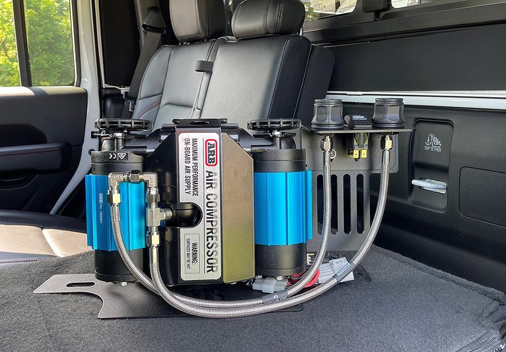

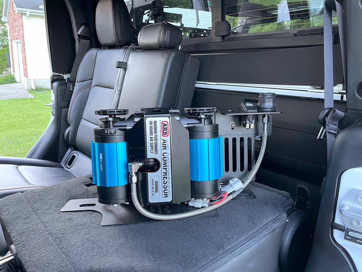

Mike.....my ARB twin came in a few weeks ago after a long wait. I have been researching and thinking where to mount mine for months. I am going to go under the driver side back seat. I just do not want to expose it to the elements. I have a real big project, a garage, to finish then hope to get the ARB installed. Good luck!
I went this route also as you probably remember. Let me know if you have any questions!

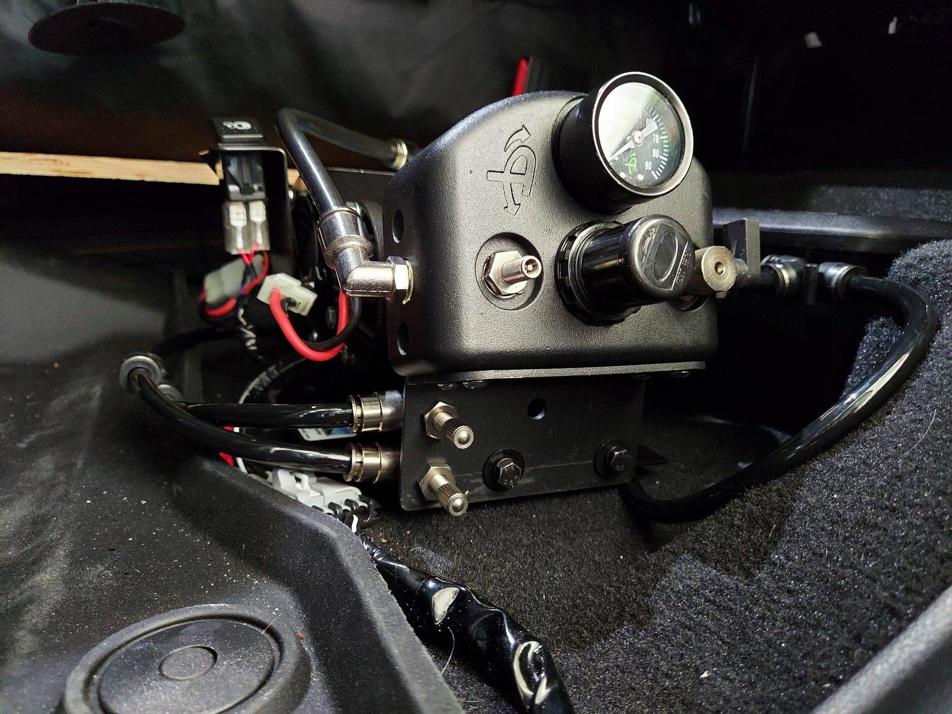

UpDown Air system is also a good way to handle the air. They seem a little clueless about tubing however. I got the "universal" to mount at the compressor, and all the tubing was pre-cut, WTF? Anyway, the kit has 3/8" tubing, and most of it was cut to useless lengths for me since I wasn't running airlines through my Jeep. So I ordered their "replacement tire whip" tubing, and it is 10x6.5mm. Again WTF?? I had some email interaction with them and they seemed completely unwilling to address it, but whatever. It's close enough I guess and hopefully doesn't fail. Idiots :headbang:

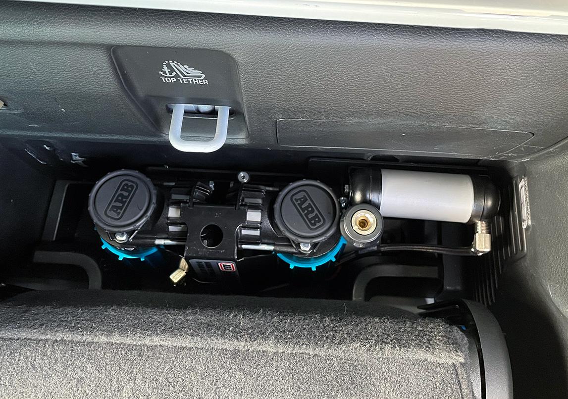

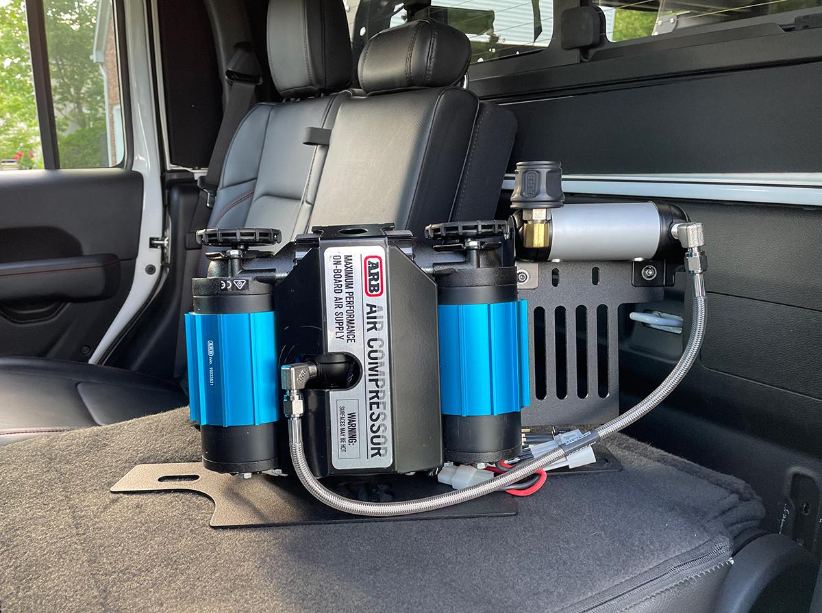

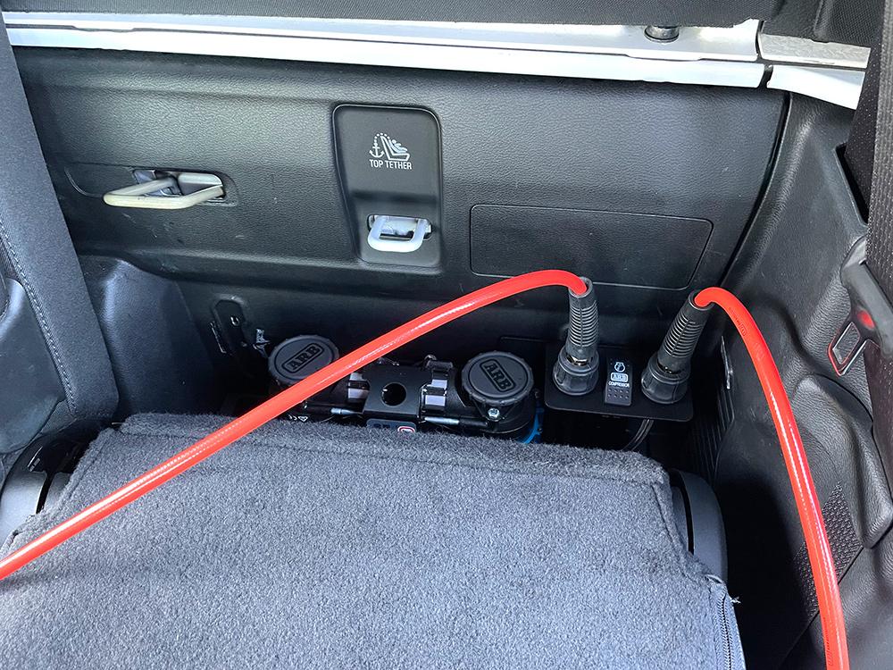

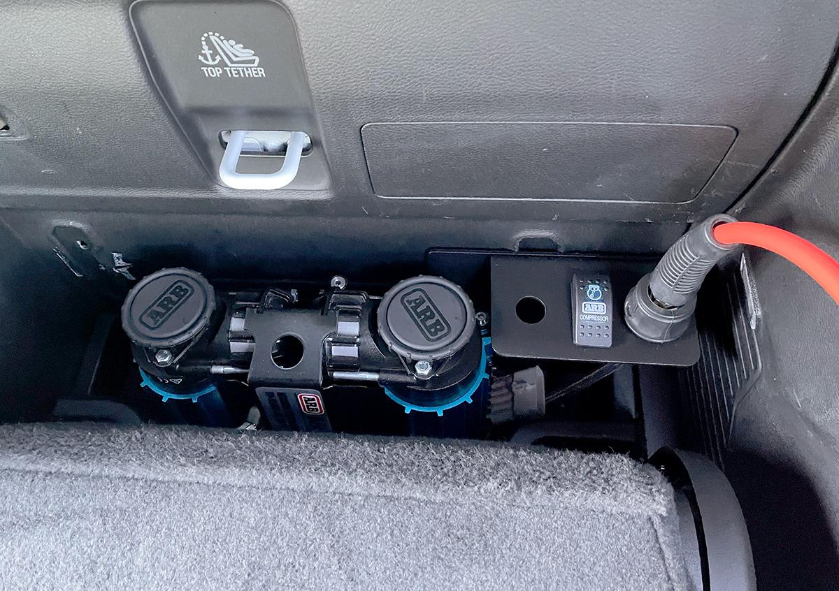

I'd assume then I need this: https://www.813fabrication.com/product-page/arb-twin-single-behind-the-rear-seat-compressor-mount
And This: https://www.813fabrication.com/prod...fold-add-on-kit-for-our-behind-the-seat-mount
Plus This: https://www.813fabrication.com/product-page/arb-switch-air-chuck-combo-mount-semi-boxed
Then I would have onboard air and the ability to expand to a rear locker when I was ready.
All I would need is a hose kit and my twin to arrive. Correct?
Correct! You can also have the ARB Air Coupler that comes with the compressor mounted directly on the Manifold, so you only need the semi-boxed mount if you want that out beside the seat.

I ordered also! Got the behind the rear driver's seat mount and a single ARB air coupler/switch mount. Looking forward to getting this ARB twin installed before the next beach trip.

Ideal placement is a mater of opinion.
I like Jeremy's behind the seat set up, but don't want the heat and noise in the cab.
He offers another choice that I also like, under the hood on the passenger side of engine. I have a Rubicon and he has stated in the install video I will have a rub on the heat shield on the hood, so I have to decide if I can live with that.

Hey, I don't think it is anything to worry about. When I said "rub", it barely touches one corner of the black casing on the compressor. You may even be able to adjust the placement on the mounting plate a little more to not have the rub. I did some chalk tests to see how it was touching and it was just enough to transfer chalk from the corner of the compressor to the hood liner. I have a few bed mounting solutions also if you are interested. Let me know if you have any questions!
