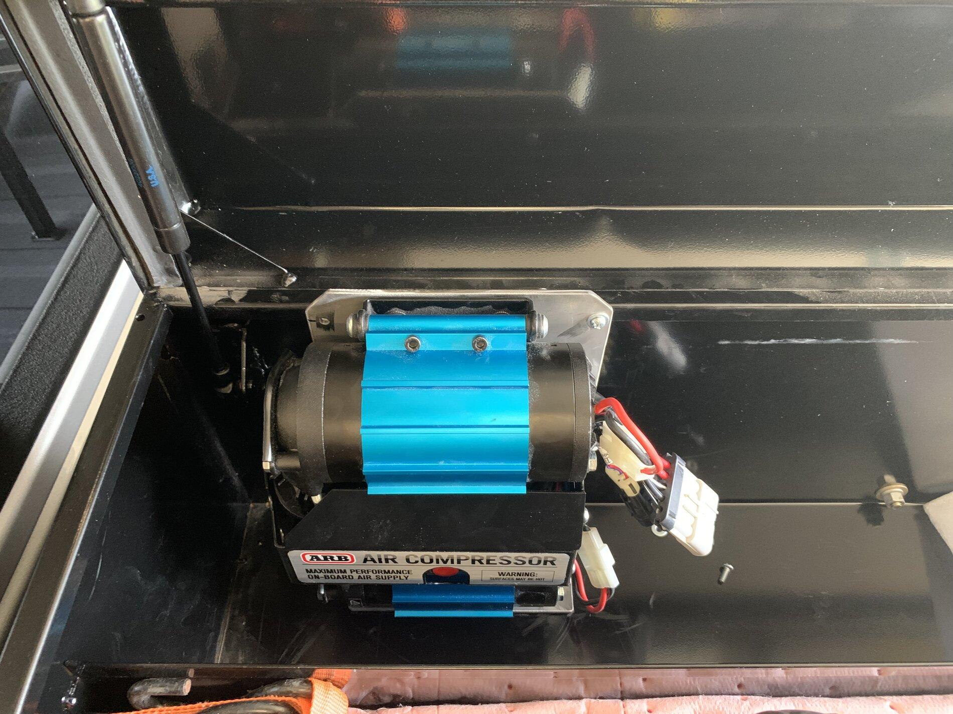

Looks like maybe the up down kit? But they jacked up the hoses. Anyone else using a different hose option for behind the rear seat, drivers side?

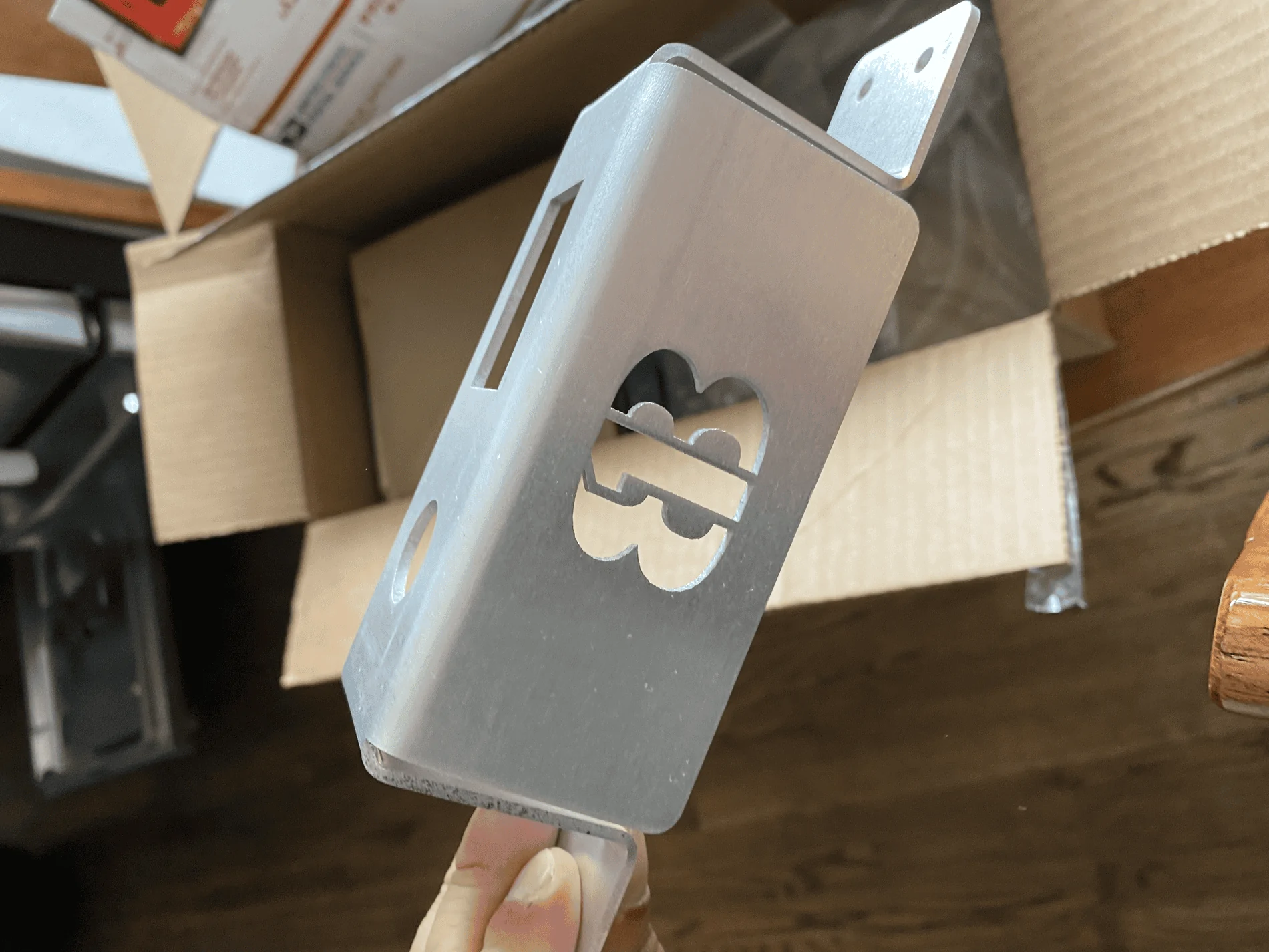

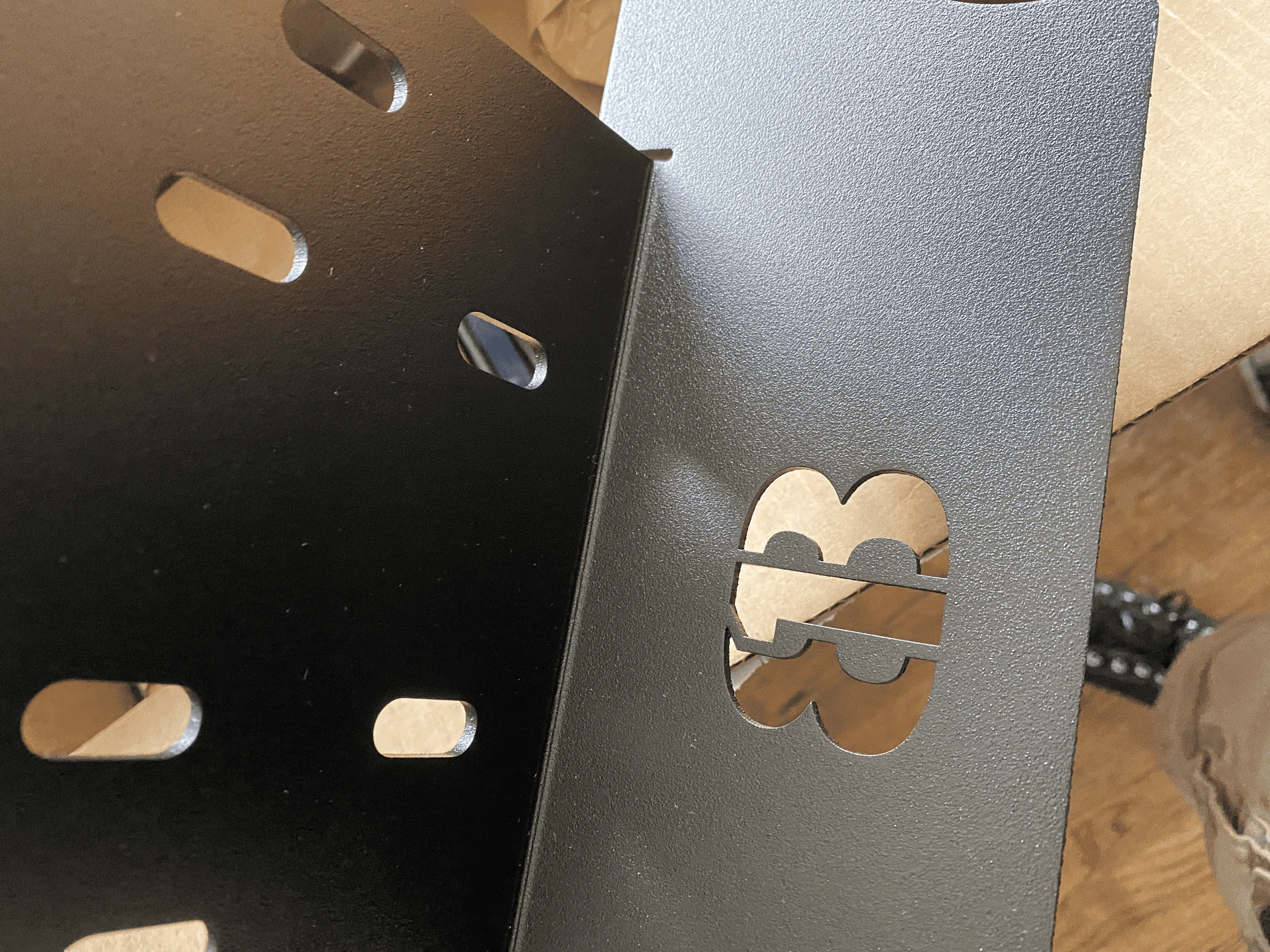

813 shipment arrived. Packed well and note from the owner.
Happy with the quality. Very nice aluminum. Low weight but not flimsy. The powder coating is excellent.

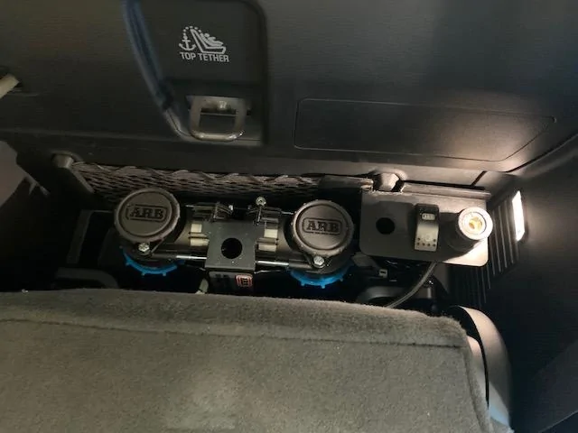

Just got back from Florida yesterday, Gonna start install soon
Mike, got mine installed. Real happy with all my 813 stuff. Good luck on your install.

Question, for those using aux switches. Is the purple wire the only wire you need besides the main power and ground wires? By that i mean what wires do i need to connect on the 3 prong harness? Just the purple to the switch? Or do i need to connect the red and black wires also?
I have not wired up my twin compressor, I move it around so much for prototyping. But, I have the ARB Single wired in the bed. I believe they are similar. I think I wired my smaller black and red into the larger ones to the battery but don't remember for sure. Hopefully someone with the twin wired will chime in.

Not the main fused and ground leads, theres a 3 prong harness with only 2 wires. A black and purple, i know the purple goes to the aux switch but what is the black? Im assuming ground, but since the aux switch is already grounded does that have to be used or can i just tape it up?
The black on the 3-pin connector is the return for the switch (and LED) so it needs to be grounded.

But im using the aux switch? Its already grounded? Im not using the arb switch.
