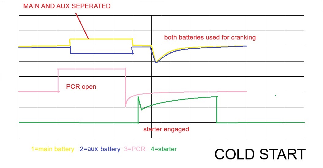

Late model Jeeps with batteries have 2 starting regimes. Let's call the first one "Cold Start." This does not mean that the engine (or weather) is cold. :) For our purpose, a cold start is one where the vehicle ignition was in the "off" position when you start. When pressing the start button on a cold start, the first thing that happens is that the Power Control Relay separates the 2 batteries. This is for the purposes of testing the auxiliary battery to determine the suitably for a future ESS start. The relay rejoins the 2 batteries in a very short time (~40ms). Once rejoined, both batteries are used to start and run the Jeep.
Actual oscilloscope test for cold start:
Simplified illustration for a cold start:

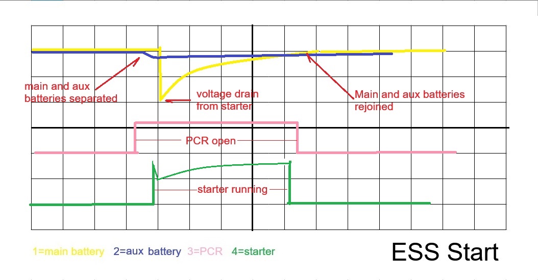

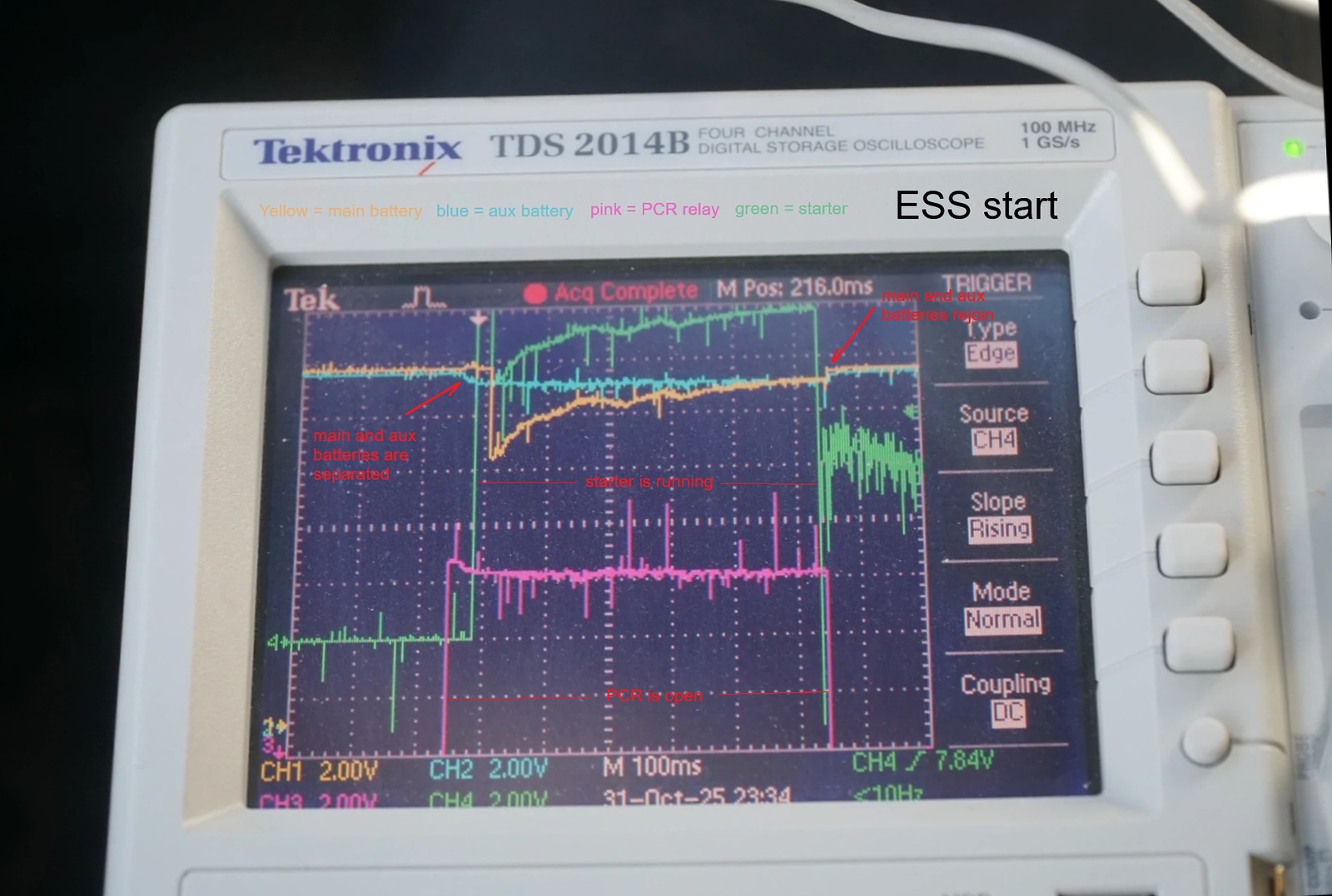

The second starting regime is an ESS start. The is where you are driving, you stop for a light, sign, or traffic, and the Jeep turns off (when you reach a full stop with the brake depressed). When you are ready to resume your drive, you let off the brake and the Jeep automatically restarts. When you make a stop with the ESS system turned on, and the engine shuts down, the 2 batteries remain connected together until you release the brake. Both batteries are keeping the electronics in the cab going. When the brake is released, the Power Control Relay separates the batteries. When the batteries are separated, the auxiliary battery powers the electronics in the cab, keeping things like the radio and AC on while you wait. Next the starter is energized solely on the power of the main battery. The batteries remain separated until the engine is started, and the starter turns off. Once the starter turns off, the Power Control Relay rejoins the batteries.
Actual test for ESS start:
Simplified illustration for ESS Start test:
Revelations?
For the purpose of a cold start, the 2 batteries function as one.
In an ESS Start, the auxiliary battery powers the cab electronics while the main battery starts the engine. The time that the batteries are separated on an ESS Start is decided by the time it takes to start the Jeep.
If you are running your Jeep as delivered (with 2 batteries), and you get an ESS Stop/Start message or the infamous Avengers warning light, this might be your first signal that your batteries are nearing end of life.
If you are running your Jeep with the auxiliary battery removed, then you should disable ESS Stop/Start. The reason for this is that when you experience a low battery condition (old or discharged battery drawn down by the power needed to run the starter) you might get a Powertrain Control Module (PCM) reset and error code. You could also damage some of the sensitive electronic in the cab.

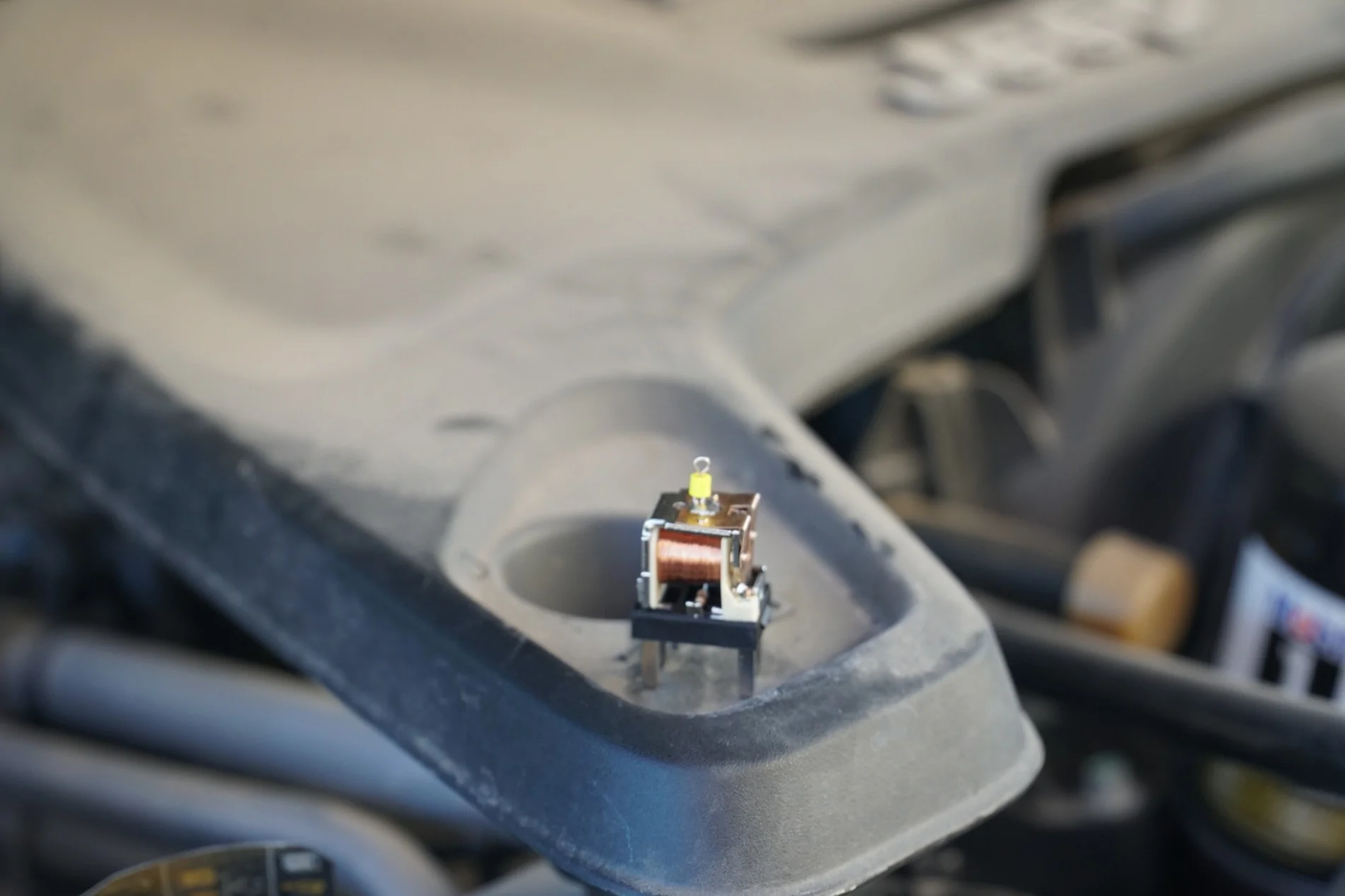

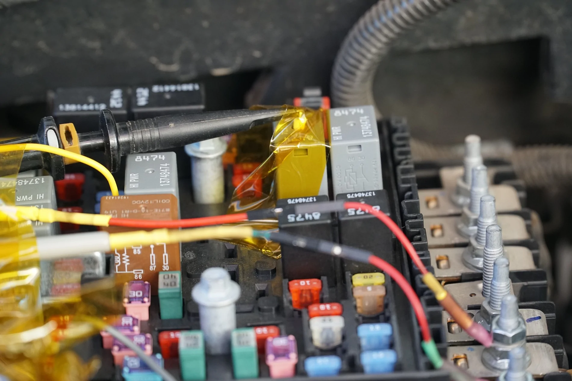

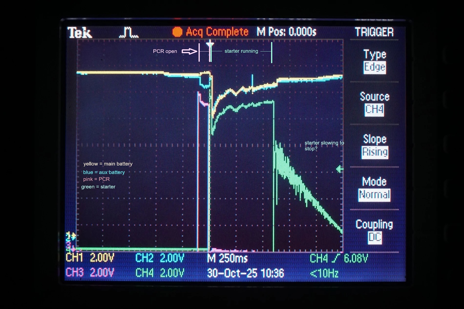

I made a relay with a test point, it is green trace. The probe is connected to the output of the stater relay. Trigger near 7.8V rise. The test point measures less than 1 ohm to GND. It is the coil of the starter solenoid. Main battery ground.
I've never heard of making a relay with a test point, any details on how you did it?
