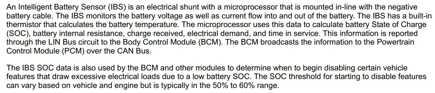

About that thermistor..... if the factory literature is correct, and the IBS uses the temperature to calculate battery(s) state of charge, then why charge levels always high when it is cold? I could understand high charge on the first crank up on a cold morning. The starts after that, the under-hood temps should be very warm. Yet, charging levels continue to reflect atmospheric temperature.

Perhaps I can be a little help on the IBS sensor. Their purpose is to give the computer a little more in-depth picture of the battery so it can be managed with more accuracy than just pushing whatever voltage the alternator is regulated to to it constantly.
Most of them can sense battery voltage, current draw, and temperature. They will have the designed capacity of the OEM battery(s) plus expected charge and discharge profiles at various amperages and temperatures wrote into the sensor as a set of tables it works from. Think of it like a VE table inside a fuel injection computer. These tables are adaptable once they get some real world data, but if they see anything too out of whack, they will report a problem to the computer that will set a check engine light and/or go into a safe mode to keep from damaging the battery or the vehicles electrical system.
I'm guessing that this is why the charging system will force the alternator to constant 14v output when the batteries are not charging like the vehicle expects.
I don't make the Jeep sensors, so there could be some Stellantis-specific things going on, but this is how they work in other vehicles.

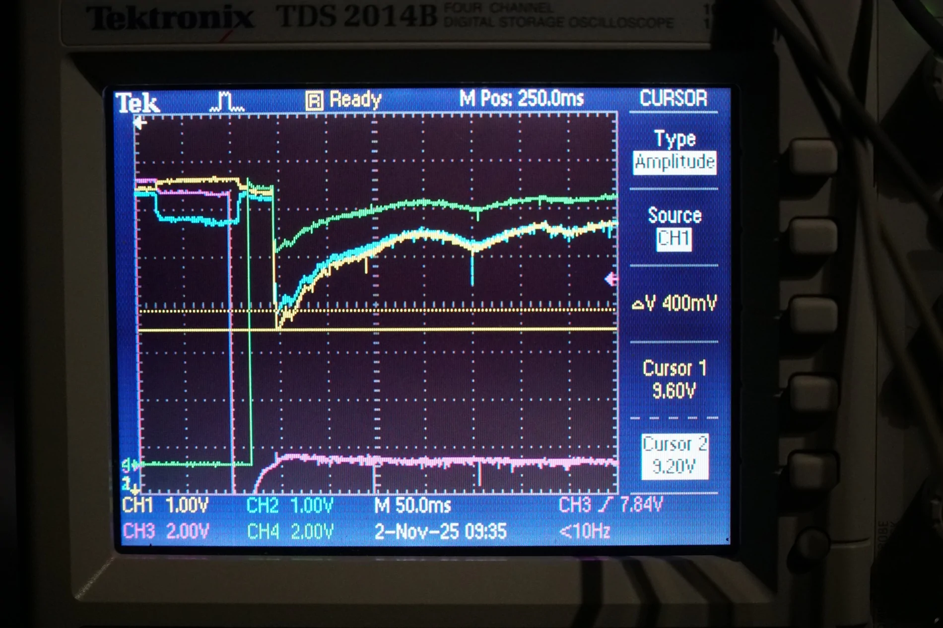

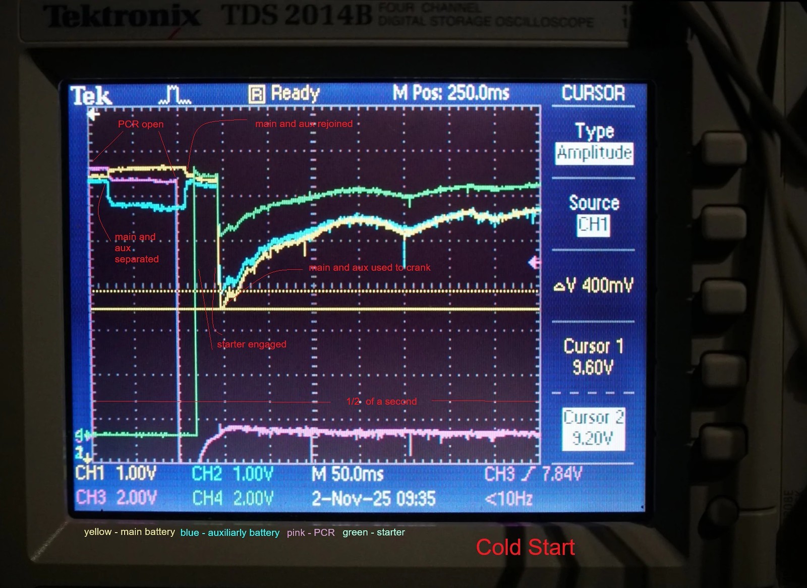

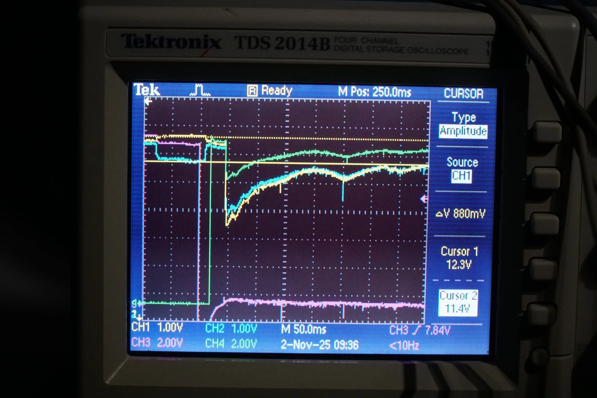

N1 and N2 voltage, cold start.
Jeep Gladiator Are the batteries really isolated during ESS stops? DSC05506
Jeep Gladiator Are the batteries really isolated during ESS stops? DSC05505
Andy29847
Andy
Oct 25, 2020
552
934
South Carolina
2020 Wrangler Rubicon, 2020 Gladiator Rubicon
You are having too much fun. :) The total time shown here is 1/2 of a second. The starter is still cranking.

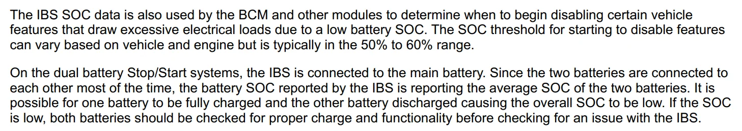

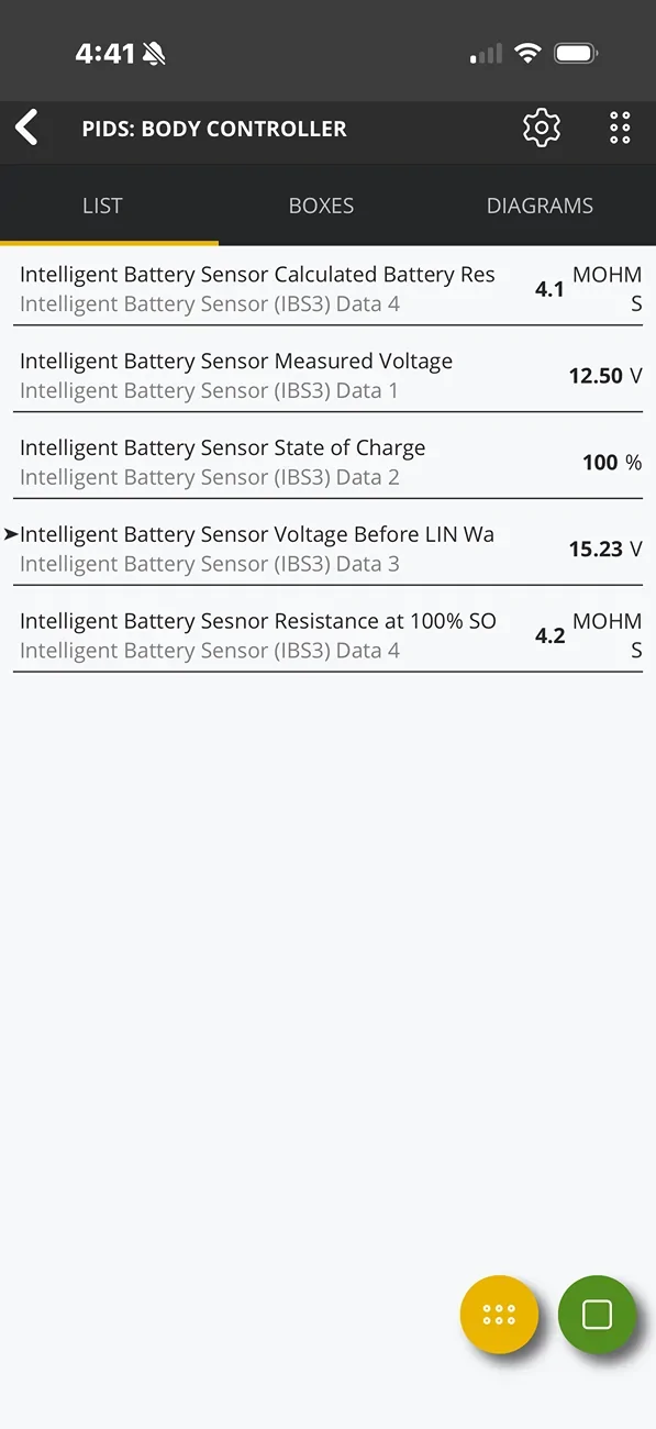

I think that IBS information is specific to the battery it's connected to. Here's an image of other information available from jscan https://www.jlwranglerforums.com/forum/threads/new-twist-on-aux-unavailable.158752/post-3270587
No, the voltage is the average of both batteries.
And -

The above also addresses the aux switches not available message where someone in another thread insisted it's the aux battery that causes that message. Bluntly, bull crap. It's the combined voltage of the batteries and you get down below ~12.4 volts you are approaching the 50% charge state, and that's were it will start to warn you about the aux switches and disables them.

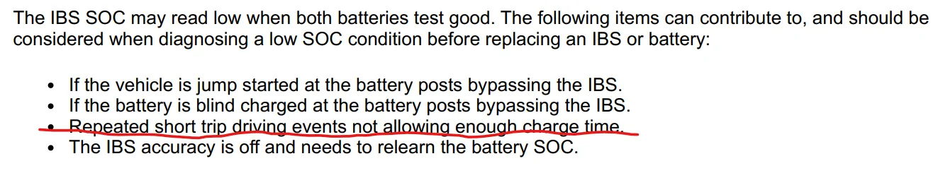

And this is why I had to remove the IBS to reset it, charge each independently to make sure BOTH were properly charged through all 4(four) phases of AGM battery charging with a proper charger (not a tender or trickle charger on my 2020 and it relearned and was fine for months after.
Too many short trips -
Jeep Gladiator Are the batteries really isolated during ESS stops? 1762053478349-u
There's more, of course, but unless we want to make this a college course on electronic engineering, hours of battery learning and more.................
