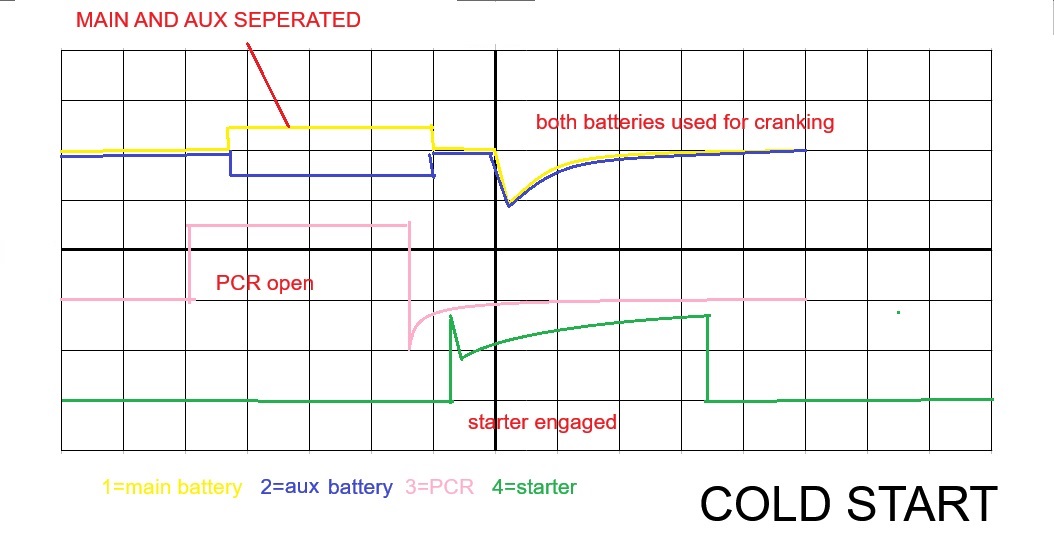

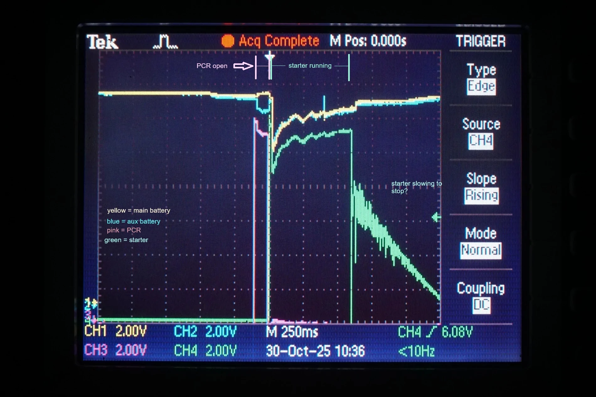

The cold start trace keeps getting posted, modified, and posted again. It's really about all we have short of someone actually capturing a FULL ESS restart - including PCR closing, and the trace showing the PCR being activated and then deactivated.
So far, I don't believe we have that. We are assuming because the images don't show the PCR trigger itself.
The initial cold start test were 2 channels, N1 and N2. Then someone added in the PCR circuit - 3 channels. The someone added in the starter circuit - 4 channels. All but one of the tests were cold start test. Below is a 4-channel test I accept as valid. I added some labels on J Serria's photo that show my interpretation of events. This seems to match the conclusion that most of us have arrived at regarding cold starts.
Jeep Gladiator Are the batteries really isolated during ESS stops? cold restart

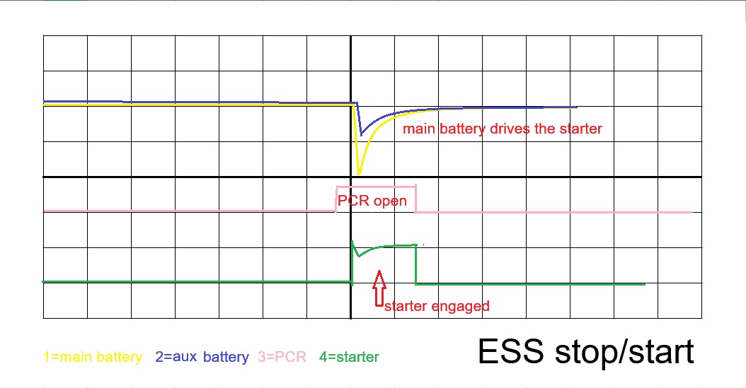

Next is the one test we have for ESS stop/start. It only shows 2 channels, N1 and N2. I added the green line (should have been pink to match the actual PCR traces) to predict PCR behavior. The period of time in question is at the end of the test - the last 100ms. Note that the lines do not rejoin.
Jeep Gladiator Are the batteries really isolated during ESS stops? ess restart 1
Also note that the time scales on the 2 tests are significantly different. It would be good if the criteria for the test were the same. Per documentation that Jerry shared earlier in the thread, I would expect N1 and N2 to rejoin in 20-40ms. I deduce that the aux battery is carrying the cab load for this time and that the ESS stop/start is initially on the main battery (not on both batteries as is for the cold start).
Jeep Gladiator Are the batteries really isolated during ESS stops? 1761861034423-

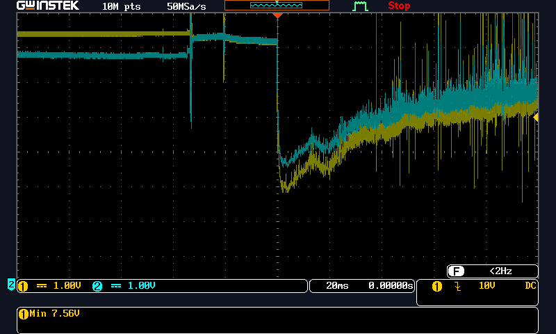

I'm an old, retired guy temporarily stuck at home. This thread has been fun for me. I've had a JT since 2020 and a JLU since 2022. I love my Jeeps, but sometimes I have wished the tech was more like my 2004 TJ. This is especially true about the battery system. As I read through this thread (5 times), I see where there has been some mistakes and a lot of learning. It remains to be seen what we can do with this info, but it is good to know.
The tests we have seen on this thread using an oscilloscope have eliminated a lot of the fog about how the Jeep battery system works. From those tests, we know that a cold start is different than an ESS start. We know that the batteries separate for milliseconds for a test of the aux battery on a cold start, prior to starter engagement. We know that after the test, the batteries are rejoined and both batteries together to power the starter for a cold start. It is suspected that the main battery provides the power for an ESS start, but we do not know yet when the main and the aux are rejoined. We know that the batteries are separated just before starter engagement. I am hoping that J Serria will soon be able to share an oscilloscope reading of an ESS start.
My career was with the telephone company. I'm more comfortable discussing voice and data than figuring out what is going on with my Jeep. One of my philosophies about running tests on telcom equipment was that the tester needed to have an expectation of the possible test results to make the actual test meaningful. Using that thought here, I've been guessing at what the scope readings would look like. Of the 2 below, the cold start scope is not a guess but reflects what has actually been measured. The ESS start is a guess.
Jeep Gladiator Are the batteries really isolated during ESS stops? i-NG62Ln9
Jeep Gladiator Are the batteries really isolated during ESS stops? i-xSxxfRn

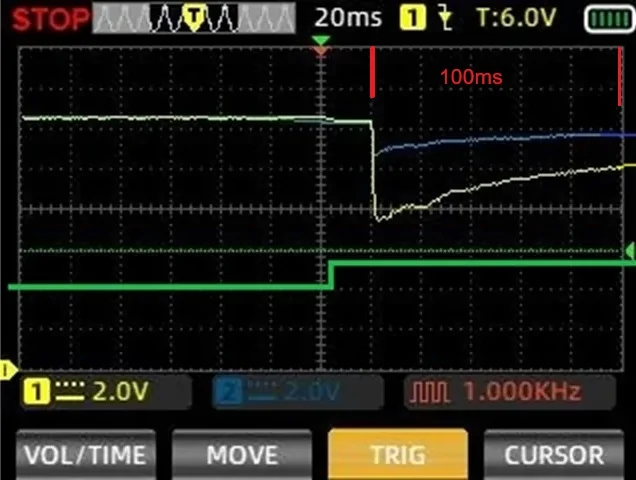

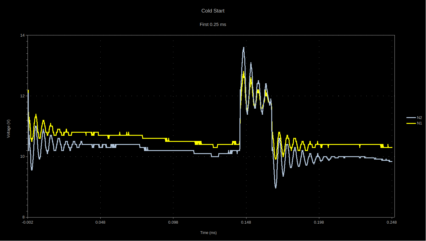

Here's a chart showing the first 250 microseconds from the first cold start trace I posted last year. It shows detail that was not visible in the trace.
Jeep Gladiator Are the batteries really isolated during ESS stops? cold_start_025
This is less than one pixel in the original trace below, right when both voltages drop sharply.
Jeep Gladiator Are the batteries really isolated during ESS stops? DS0011.PNG
I think the initial load that pulls it down from 12.2V is the starter solenoid. The spike over 13.5V at 0.145ms is inductive kickback. Then current starts flowing again.

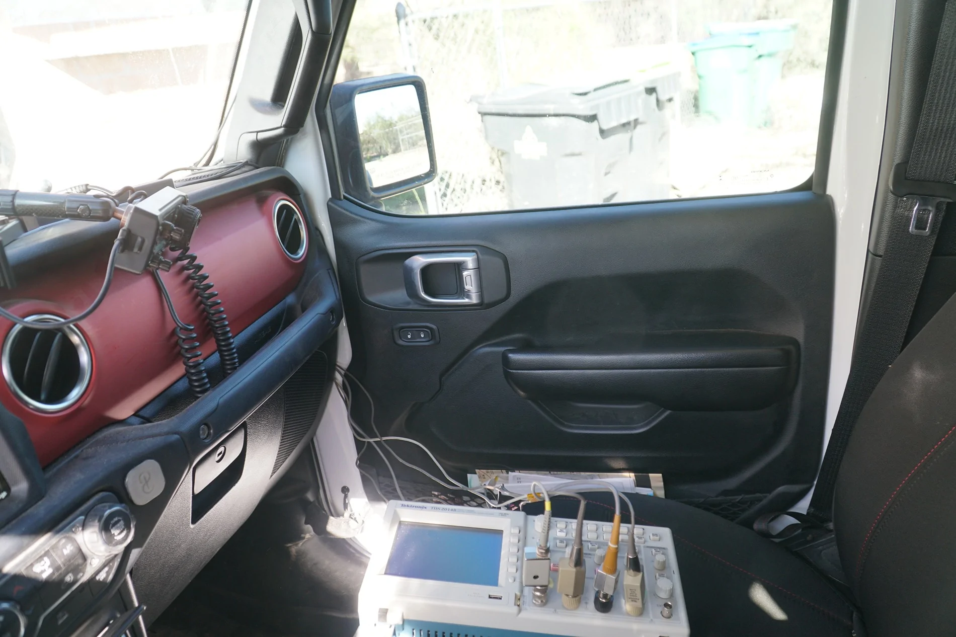

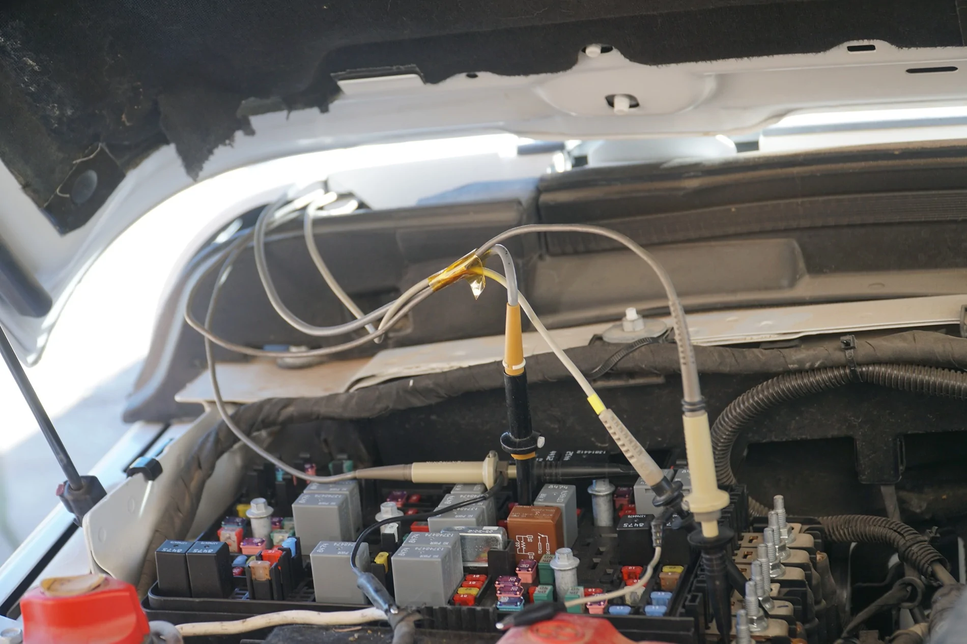

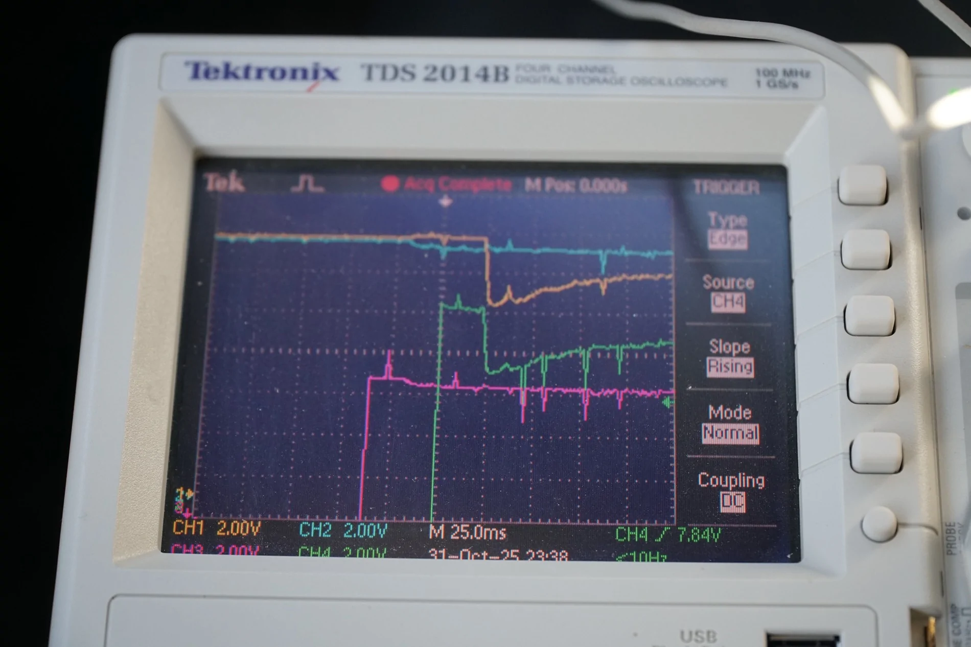

Ess hot start. Ignore the spikes they are from the inverter. The pcr and starter signals are moved down. Last image I moved green up.
Jeep Gladiator Are the batteries really isolated during ESS stops? DSC05484
Jeep Gladiator Are the batteries really isolated during ESS stops? DSC05483
Jeep Gladiator Are the batteries really isolated during ESS stops? DSC05482
Jeep Gladiator Are the batteries really isolated during ESS stops? DSC05472

PCR is open during ess start. Trigger is starter relay green.
Jeep Gladiator Are the batteries really isolated during ESS stops? DSC05481
