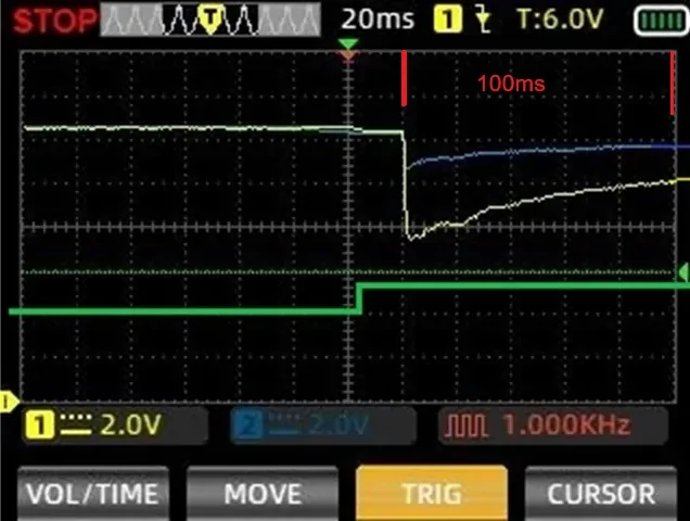

Not to discourage new life in this old thread, but what are you guys hoping to discover?
I measured the resistance between N1 and N2 at less than 3 milliohms in post 136.
The trace of an ESS restart shows a sizeable voltage drop from N1 to N2, more than 2V for 100ms.
If the PCR is conducting, it's carrying more than 2V / 3 milliohms = 667A for 100ms from the AUX side to the MAIN side and the starter.
Where do you suppose that current comes from? Detroit?
I'm curious about what happens on an ESS stop/start.
Does the aux battery carry the cab electronics for the stop or just for the start?
When are the batteries separated and then combined?
Regarding your calculations, you are seeing current flow between N1 and N2 in the 100ms period pictured below. My thoughts are that the N1 and N2 are separated here.

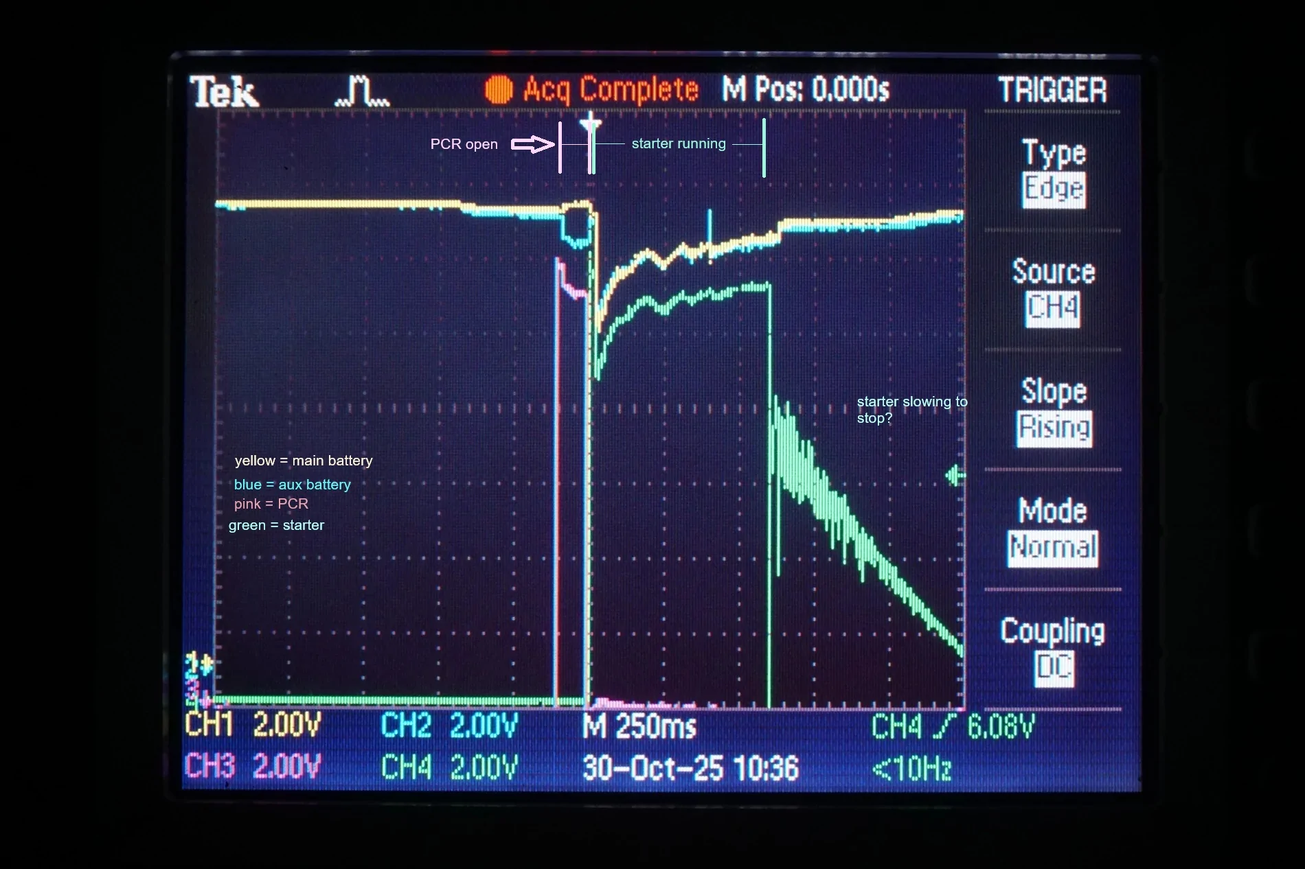

Now I have a good trigger. See all the ringing in the green trace.
I believe that this is a cold start. Thanks for putting everything together. I put some labels on your photo. Let me know if I got something wrong. I'll fix it.

The batteries are connected during the ESS stop. We've proven that. Both carry the load of the stopped vehicle. They are not separated at any time during the stop itself - not until the restart sequence is initiated.
The batteries only disconnect for the first milliseconds of the starter engagement.
It's documented and I've shown they are connected during the stop. Further, the schematic show that if they were disconnected during the stop, there would be no reason at all for the voltage of the crank battery to drop, and yet it drops exactly the same as the aux battery voltage drops.
It's that simple.
Just the restart. The issue it is mitigating is voltage drop during starter engagement.
Combined at all times except for the moment of starter engagement during an ESS restart (and the initial startup test on a cold start, obviously).
Feels like I could just copy and paste this over and over, we're literally talking in circles with everyone here.
"I see the documentation, but I don't trust the documentation. I also see a oscilloscope image showing the documentation is accurate, but I don't believe it is being interpreted correctly. I also see wiring diagrams that support both the documentation and the oscilloscope interpretation, but I still need to verify how it works. I must continue to create new questions until I convince everyone else they're wrong."
Someone needs to explain how this thought process hasn't ended yet.

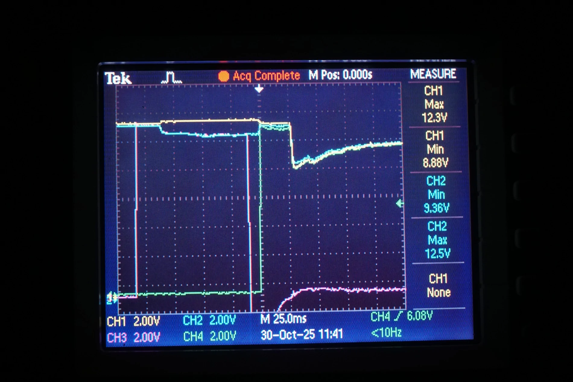

That trace shows a difference in voltage between N1 and N2 after the start is initiated. The 2 traces do not get back together on the test. Logically, the PCR is open.
That shows a difference after the start because yes, the PCR opens at the moment the start is initiated.
Main handles the starter, aux handles the electronics, then it reconnects.
But until the start is initiated, the two batteries are connected.
I used volt meters connected to my main and to N1 and found the voltage to be the same the entirety of the time the engine was stopped for an ESS stop.
It would only be the same if the batteries were connected while the engine was off - there's nothing connected to the main itself except through the PCR.
On the cold start trace, the lines merge after the PCR is closed. The lines are not merging on the ESS start trace.
He needs a new check on the ESS stop/start events. There's hardly any time shown there.
The PCR opens at first starter initialization, and then closes after - and it's going to take some time for the lines to merge - it's not showing the full sequence up to the point of the engine firing and running.
They are going to merge fast because it only opens for a moment before cranking, so there's nothing taken out of either battery - PCR opens for voltage check, then closes, then starter engages.
There's really nothing to merge as there would be little difference unless one battery wasn't really healthy. If both were at 12.6, the PCR opens, check made, PCR closes, unless one battery is weak, they are going to merge again pretty quickly.
But with the start sequence, there's two different loads applied to the two batteries, it will take more to equalize again
Your last 2 posts have said the same thing. I feel like you are not understanding what I am asking about. Let me try again: On all the cold start traces, N1 and N2 merge together immediately after the PCR closes. On the one ESS stop/Start trace that we have, the N1 and N2 lines do not merge while the test is running. My logic from the info at hand is that the PCR separated N1 and N2 for the ESS start. Then the PCR remains open for an undetermined period of time. I'd guess that it stays open until N1 and N2 are almost the same (volts). I'd also guess this happens fairly fast because the aux battery is discharging on the cab load and the main battery is charging from the alternator. This is all just supposition from an idle mind. As it stands, we don't seem to KNOW.

This is before I moved the PCR and starter traces down a bit.
Thanks for the info you are providing. I'd like to point out that the traces look different from photo to photo because the scale setti9ng of the meter is changing.
