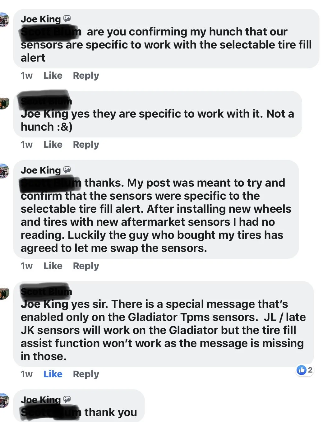

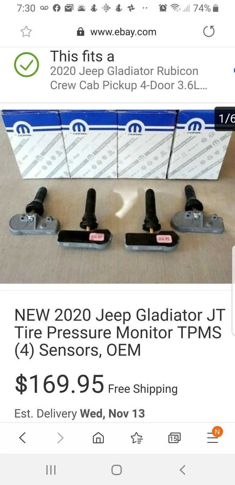

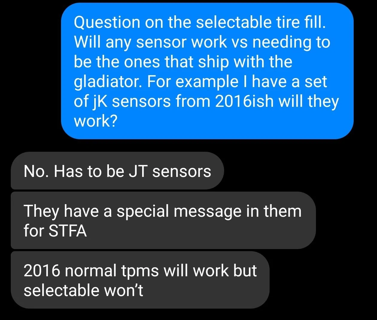

I bought these ones on E bay and they claim they are for Gladiators. Part number listed was 68464656AA. Will these work for STFA? Do all JT's have STFA?
Sorry not knowing but I have not received my gladiator yet and bought sensors to swap tires & wheels when it arrives.

This is the part number I was given by Jeep and it was cross referenced to my vin#
68464665AA, I can’t confirm if the ones you have listed will work with STFA. It’s my understanding (subject to change) the Rubicon receives STFA as a standard option.

Ok.. I'll have to send these back. The part # is very similar so wondering if its represented wrong on the Ebay listing. I'll need to cross check with the box they came in. Thanks for the info
I would suggest contacting your Jeep parts dealer with that part number from eBay and/or give them your vin# if you have it but it’s my understanding there is only one part number that works with STFA
