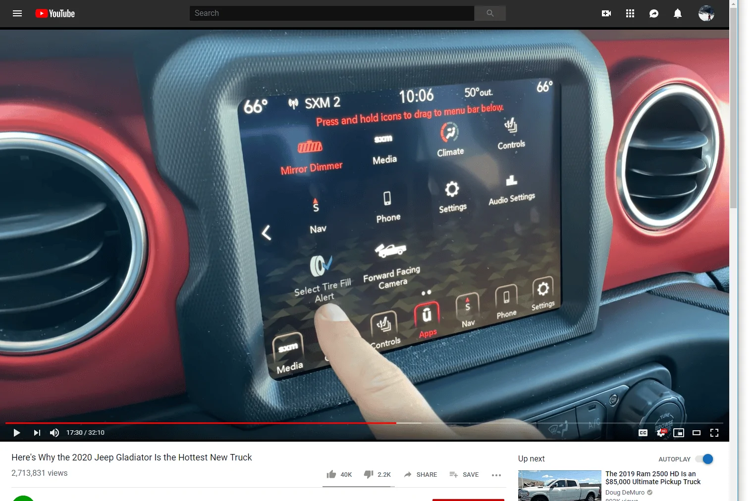

I get another call that it’s all done. I go to pick up my truck and the STFA is not on the Uconnect. I tell the service advisor and they tell me there is no icon for it. I am now talking to two service advisors and they are both trying to convince me that it’s done. They pull up the full service bulletin and they tell me to watch a YouTube video.... in the video it shows the icon. I show them the picture and they start back tracking saying that the Uconnect takes 24 hours to update and it will be there tomorrow.
The second service advisor tells me they can call the corporate service center (I don’t remember the exact term) about it if it would make me feel better. I say that’s fine and I go take a seat. I text other one of the forum members here to see if his issue with got figured out and he tells me to not leave the deal ship until the icon is there, his is still not working. 20 minutes later the service advisors comes over and tells me that corporate service center had rejected the service request and that’s why it didn’t work. They say they will redo it and it will be done in two hours.
I get a call that it’s ready 2 hours later, but it would take an hour for it to work once I pick it up. I tell them that I will wait an hour before I show up, so it should be working. An hour later I show up and it’s still greyed out, but the icon is there. I was going to leave the truck at the dealership for them to figure it out, but figured it was no hope.
I take the truck home and start reading more about it and figure out that I have to enable it in setting. The next morning I try that and it works, kind of.

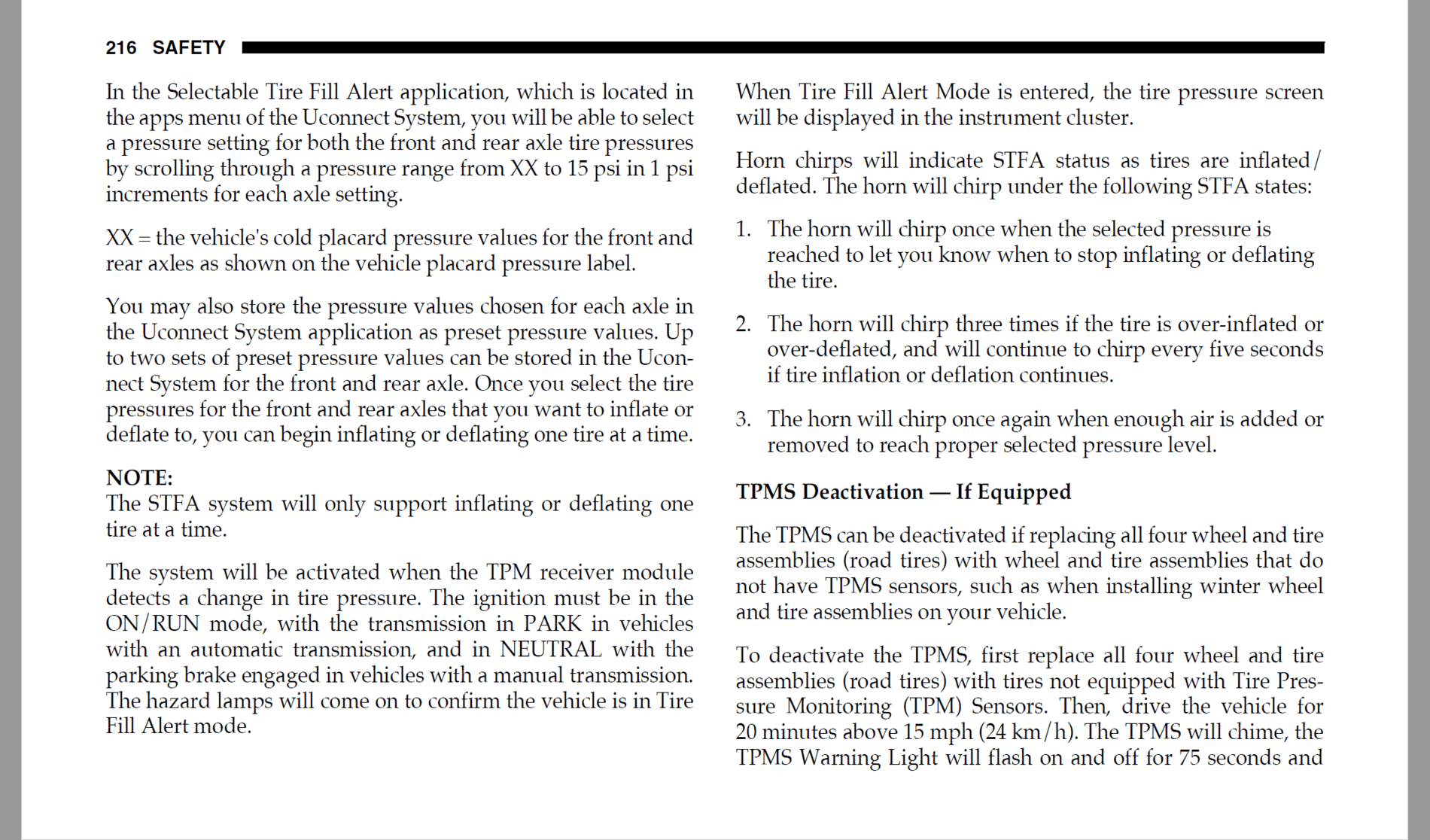

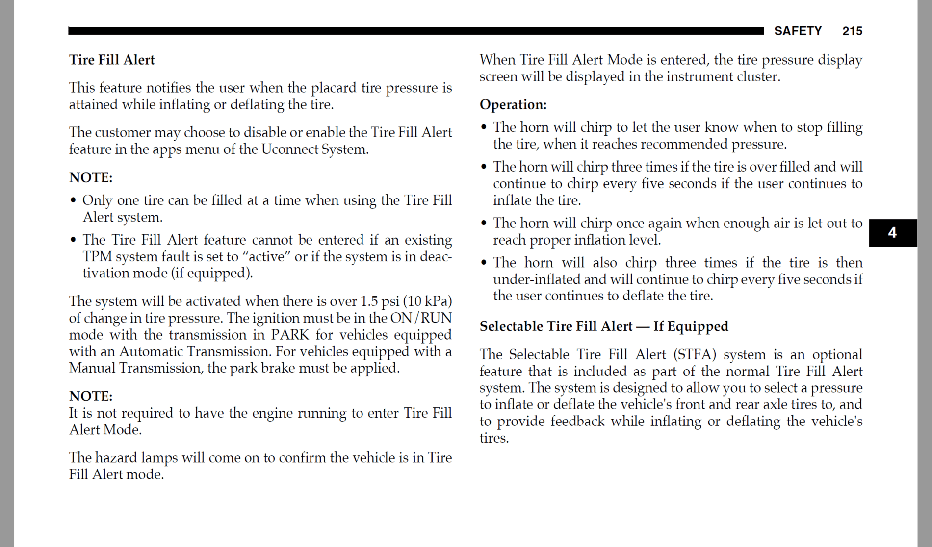

At this point it’s either user error or the program stinks....yet to be determined. I am able to set the desired pressure, but I am not sure how to get it to turn on... I programmed one of the presets to 36psi and the other to 15psi. Since my tires we’re all aired up to 39-42psi from the dealership (thanks), I click my preset for 36psi. I start to air down and I get down to 32psi and nothing. I grab my compressor and start pumping back up and now the hazard lights come on and it honked when I got up to 36psi. I attempt the same thing on the other 3 tires and nothing.
Am I doing something wrong?
