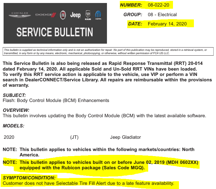

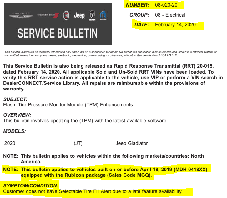

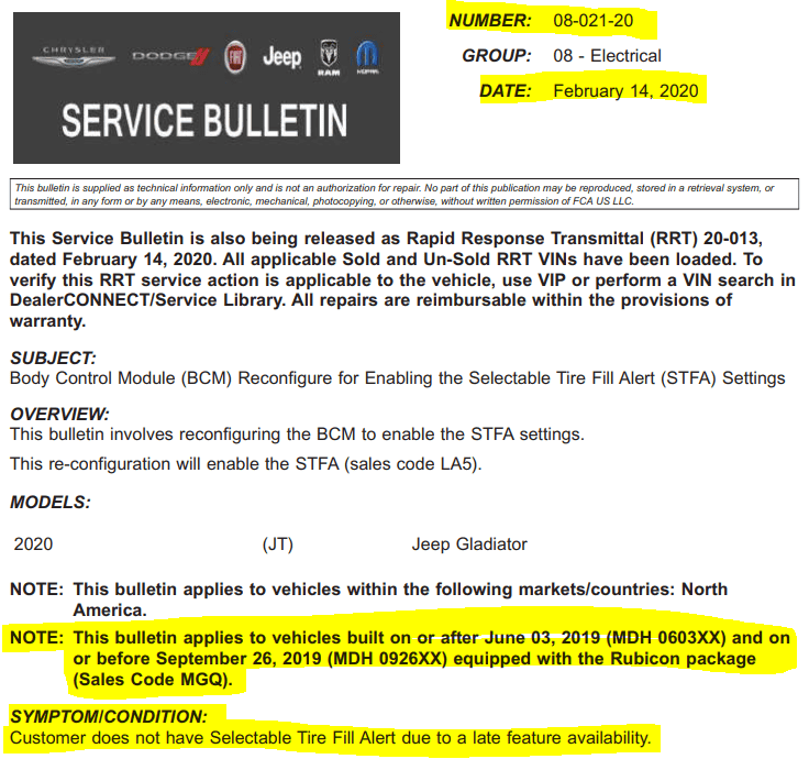

Good news! A Technical Service Bulletin was released this morning regarding Selectable Tire Fill Alert.
To ensure this TSB applies, please visit the dealer to have a qualified technician review the details of the TSB and specifics of your vehicle. Once reviewed, the technician can then perform the repair procedure that best matches the symptoms and diagnosis of your vehicle.
There are three TSBs listed here. Each one depends on the build date of your vehicle. Please see below:
Jeep Gladiator Tire Fill Alert and Selectable Tire Fill Alert upload_2020-2-14_8-35-5-
Jeep Gladiator Tire Fill Alert and Selectable Tire Fill Alert upload_2020-2-14_8-32-40-
Jeep Gladiator Tire Fill Alert and Selectable Tire Fill Alert upload_2020-2-14_8-29-56-
As always, please let us know if you are in need of additional support while in service.

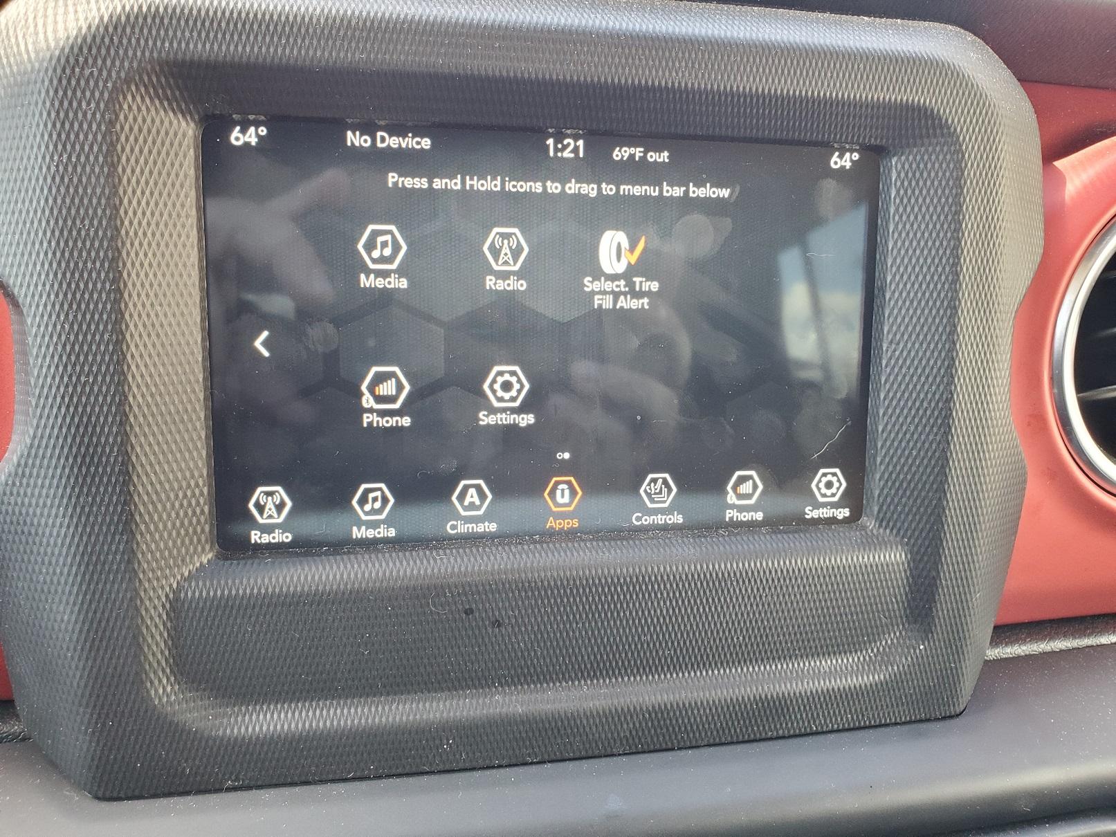

Had the Service Bulletin applied to my Rubicon Gladiator with the Uconnect 7.0 system and it was somewhat of a gaggle to get it done. I was the first one who requested this at my local dealership and they were somewhat confused as to what it was all about. I talked it through with the service adviser and he finally caught on and took it back for the techs to deal with it.
Received it back with it invoiced out as being performed. Went out to my Gladiator to check it out before leaving and the Selectable Tire Fill Alert icon would not appear on the apps page. Went and got the service adviser and showed him the icon not being there and got a tap dance about having to drive and blah, blah other things coming out his mouth. Walked back in with him and asked him to pull up the full service bulletin instructions and there was a step for them to verify the icon which they obviously did not.
They took back in the service bay the adviser came back in about 20 minute and told me they were calling FCA engineering help line to get assistance. Adviser came back once again and stated FCA engineering told them to either put or let the vehicle go into sleep mode for over and hour so all the modules on the bus power down and once brought back up, the icon should appear. Waited almost and hour and half and the icon eventually appeared as FCA engineering said it would and all functions work.
This "sleep mode" is not on the service bulletin instructions so I am putting that info out there in case anybody else has the same issue when they get their BCM flashed.

How do you do the sleep mode? I had mine done but the icon does not appear....
Hootbro
Apr 13, 2019
10,196
19,975
2025 Gladiator Sport
I could not really tell you with any certainty what they exactly meant by "sleep mode" in regard to this. I never talked or directly seen the tech who was doing the work and imagine some things and details got lost when it was explained to me by the service adviser.
I do know with most modern vehicle with multiple computer modules, there is a normal sleep mode that usually happens within a hour or so after being turned off and then there is a "Deep Sleep Mode" that a vehicle enters in when it has not been operated in like two weeks or more that powers down even farther.
I suspect the tech probably forced it with a scan tool to go into Deep Sleep Mode but once again, that is speculation.
