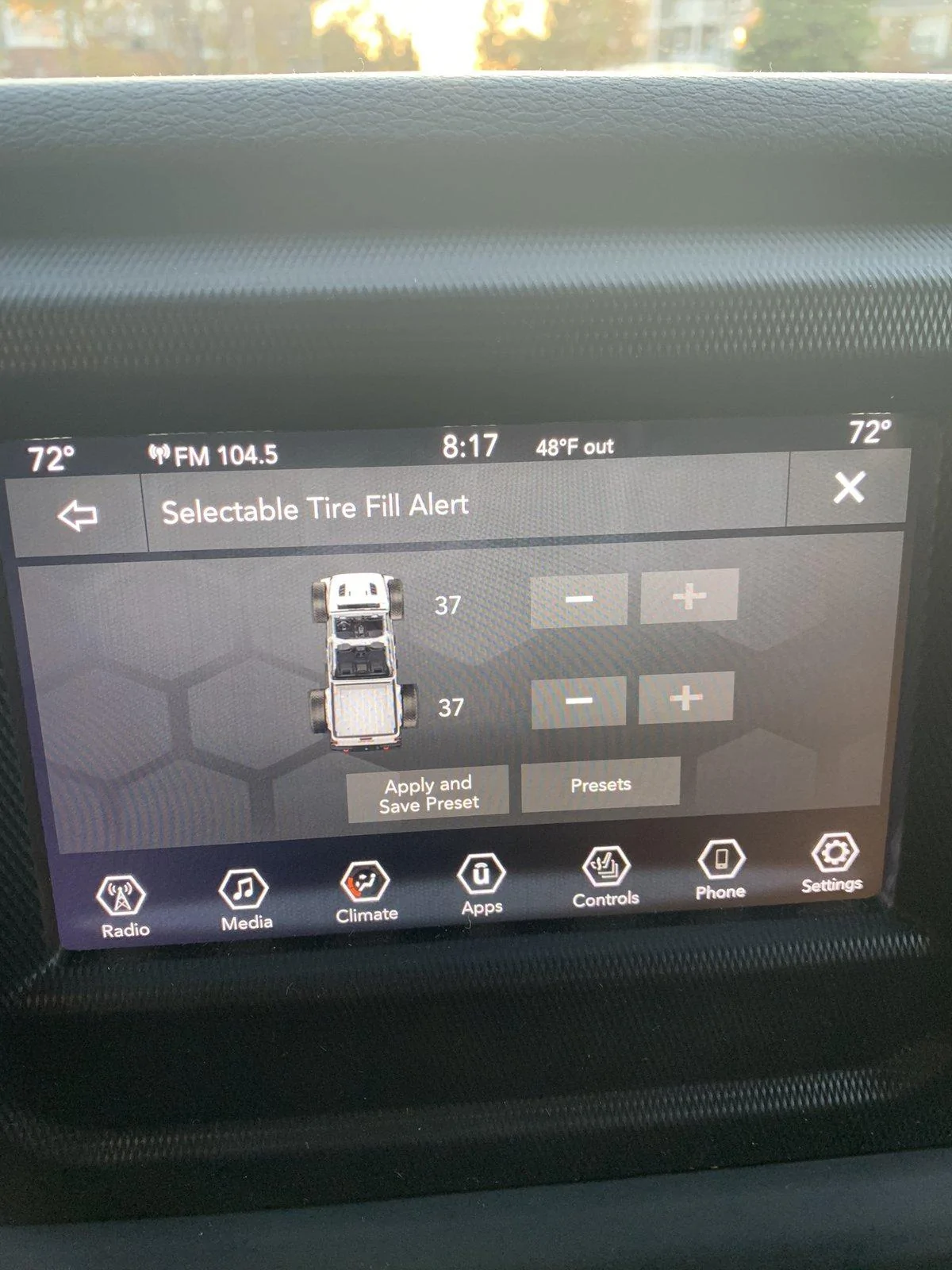

Had that happen the other day; after a few (a lot) tries I got a msg saying it wasn't available with vehicle in motion. I was parked but may have had the engine running. So maybe it only works with truck not running?
and @spazzyfry123 thank you guys! Just an update I tried this again last night but this time I had the engine off but battery on (hit the push button twice but don't turn on the engine) and went into the settings. This time the check didn't go away and then I proceeded to open the Tire Fill Alert App and I was able to setup the PSI! I didn't test the honk but at this point everything was working so I'm sure it's fully functional. I did not have Tire Fill Alert on my sticker but now confirmed I do

I know you didn't ask me but I pushed my guy at Jeep and he answered pretty quickly back.
My question
Question on the selectable tire fill. Will any sensor work vs needing to be the ones that ship with the gladiator. For example I have a set of jK sensors from 2016ish will they work?
His answer
No. Has to be JT sensors
They have a special message in them for STFA
2016 normal tpms will work but selectable wonā€™t

Wheel choice won't matter just move your sensors. Im glad I asked cause I assumed the same. Which also means I will have to insist on oem sensors if one breaks.

Ok, Iā€™ll take the ā€œDumb Assā€ award. After reading through this post realized I had to turn it back on.
So you must use the OEM sensors and no problems with aftermarket wheels and tires.
If it weren't a new feature that isn't at all documented, I'd award you that Dumb Ass award. For this, we'll categorize it as "learning." But yeah, I remember it has to be turned on each time.
