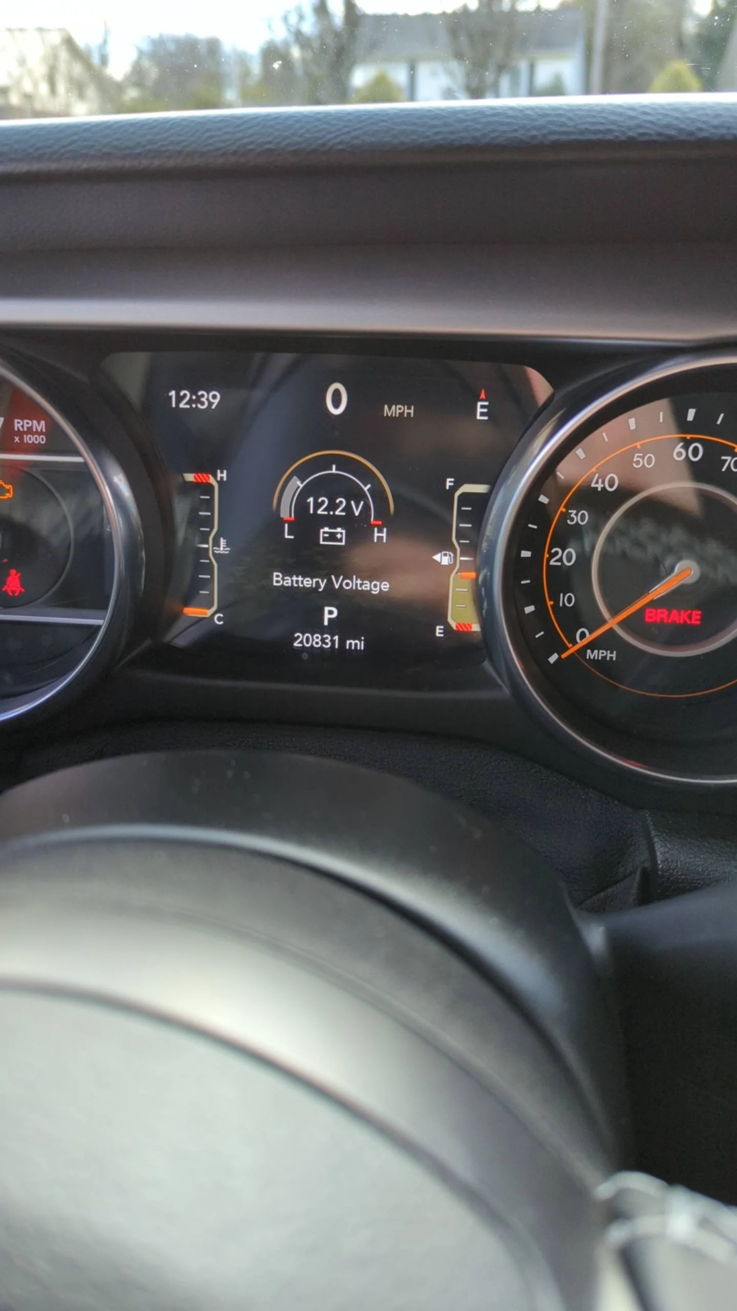

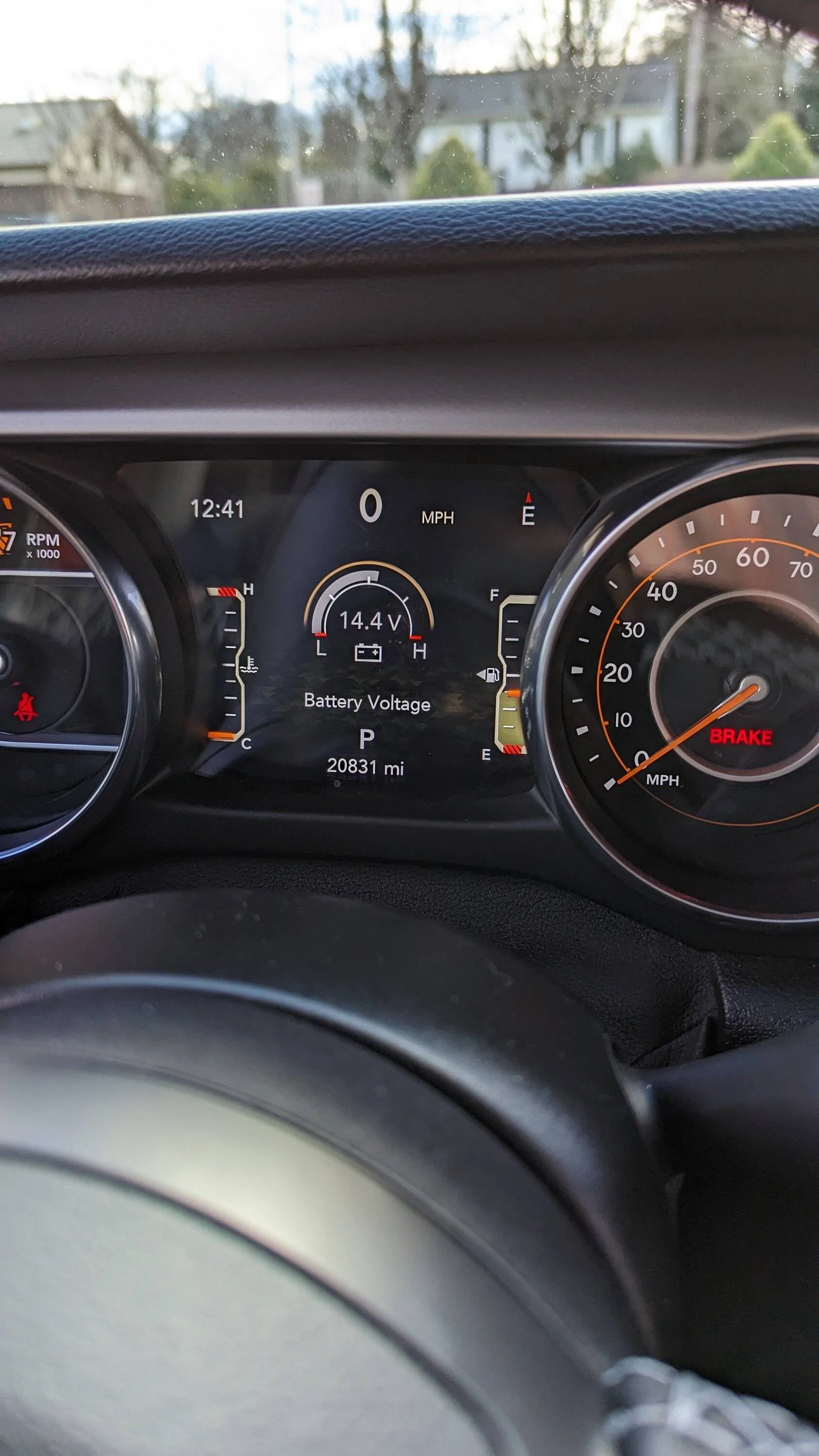

Voltages on and off. Drove 3 hours on highway yesterday and no start/stop ever. Always says not ready. No reason. Might take to dealer to check battery. Will reset the ESS today when I get home by unplugging the harness and reattaching. Tried everything else

12.2 VDC at rest, one or both of the batteries is getting tired. Like mentioned, most likely the AUX battery.
Not sure what you mean by that.
Do you mean IBS? If so, only do that with both batteries fully charged.
Best to remove it from the battery negative post to do that, not just "unplug it".
12.2 volts is way low for the driving you've done.
Gotta disagree a bit and say - Not necessarily.
That's the lore out there, but multiple members have found it to be the main battery after ASSUMING and replacing the aux battery.
More than one has replaced the aux and gone back and bought a main battery.
I've observed at least 3 forum members state that the main battery was either the culprit, or as bad as the aux.
Sadly the internet has made the aux battery a bad guy.
Since batteries lose capacity over time, especially in the type of use many of these see (occasional use, short drives) I can't see putting a new battery in with one that has diminished capacity.

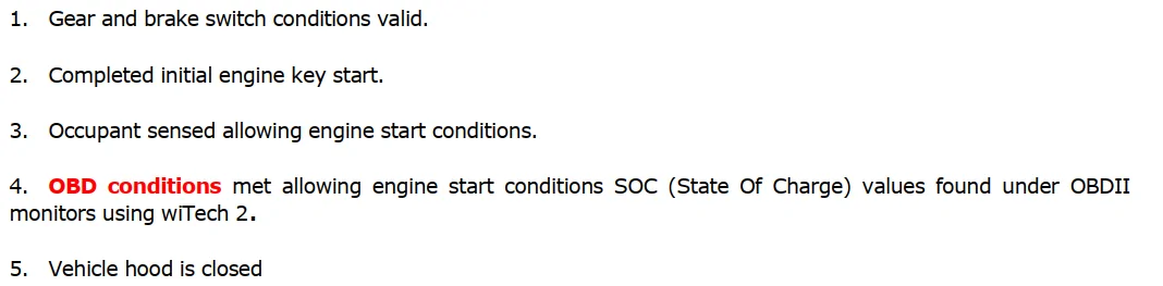

bad and misleading info, a lot rooted in annoyance and hate of what's not understood.
Anyway, the dealer can follow procedures to determine if all is in order for ESS to operate - besides the batteries being up to snuff -
Besides the chart I posted on page 2, there's apparently a process they can follow to determine what's going on.
Are the techs at your dealership smart enough and willing to actually think?
