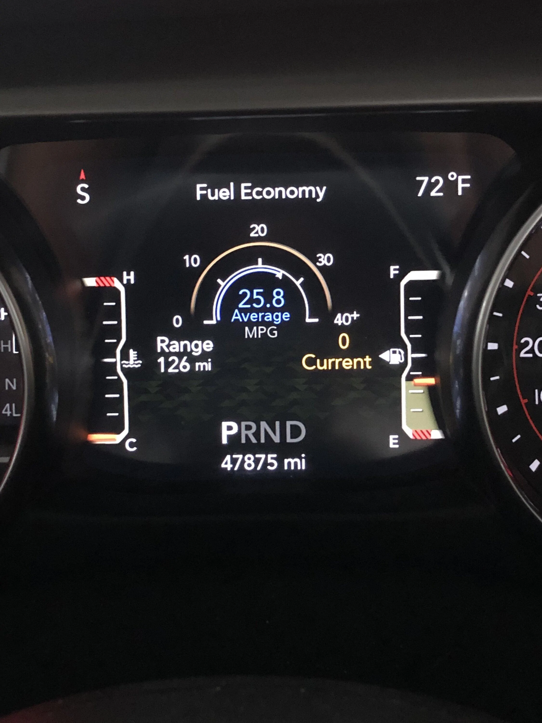

Here we go, the past week’s average. I turned the ESS back on. I will fill the tank today and report back next Sunday.
That MPG Average isn’t the one to use: it’s a rolling average calculated over the previous 100 miles or so.
You’ll want to use the number from the Trip Odometer page.

I reset both every time I fill the tank. Does that not give me the tank average?
250
40,617
54,331
If I reset trip A at each tank, it matches to the exact number what the average on the screen shows when I scroll down to reset A.
If I don't reset trip B each time, say I leave it for 5 fills, it gives me the average over those 5 tanks.
I used it on our recent trip.
A always matched the cluster display as long as I reset trip A when I filled.
B worked out mathematically the same as my figures taking the total miles driven and the gallons put in.
So I use B to figure how many mpg we got over that trip and those xx number of tanks
And as long as I reset A when I fill the tank, it matches the cluster.
If it used a rolling average, it would be pretty worthless as an indicator of how well you did on that tank over-all.
I can't prove or disprove it either way, but if it's a rolling average, I find it interesting that it matches the trip A numbers.
Now I'm going to have to go start the truck and take a look LOL
If I do a relatively long trip, say 1,000 miles, and towards the end of that trip I do a long (20 miles) 10mpg pull (like up a mountain pass,) the Average MPG on the Fuel Economy screen will start to drop, whereas the fuel economy on, say, Trip A, won't move, as I would expect for some (20) miles at 10mpg at the end of a 1,000-mile trip. I haven't done rigorous comparisons of Trip A, Trip B, and the Fuel Economy screen, but I have seen them be different on frequent occasions.
I wouldn't use the Fuel Economy screen, but use Trip A or Trip B for an extended comparison.
Just sayin'.
