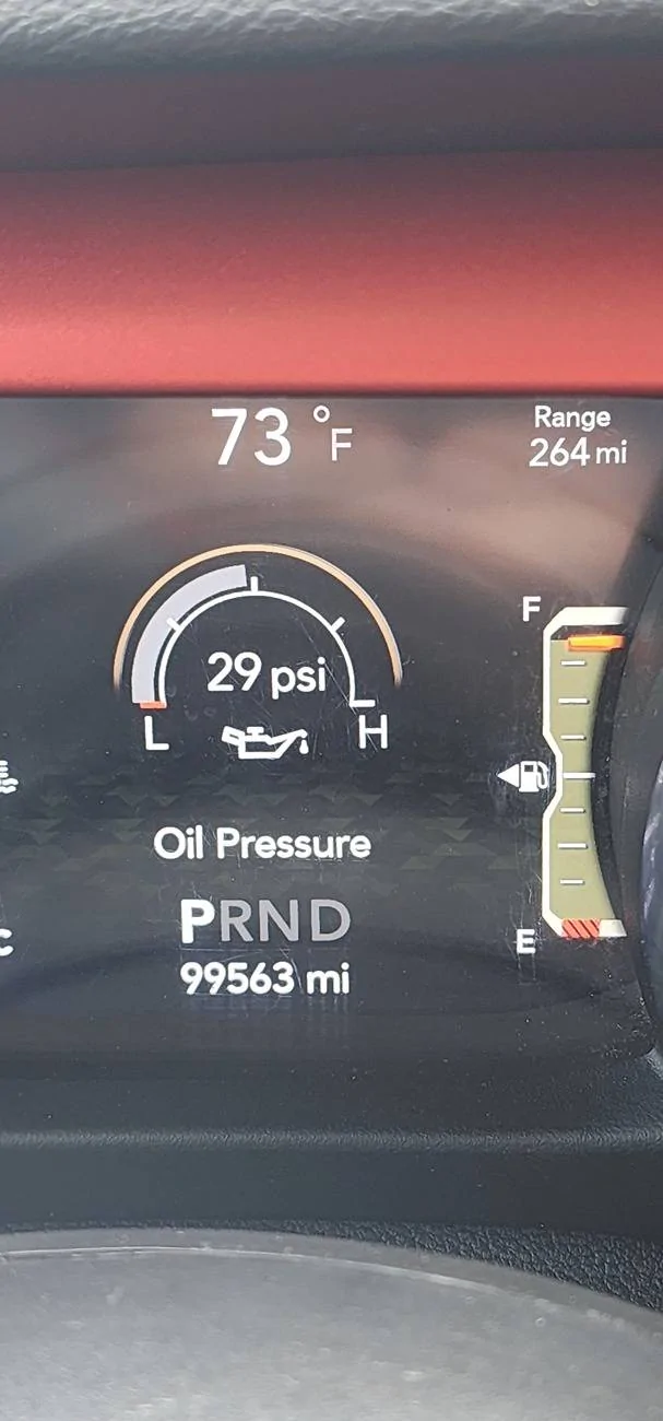

Mine will hold a gear going up a hill . If I let up a little it will shift up if it was enough torque. It is in the computer programming . Mine as it aged started shifting wonky in 234 . I now let it run for at least 10 min. In the morning and shift manually 1-4 after I do that the first time it shifts correctly the rest of the day. It's weird. I have adjusted the tire size and have changed the transmission oil. So I chalk it up to age . Mine has 99,563 miles it locks up solid in every gear still. When it is cold in the morning it tries to shift too fast . So I shift into 2nd at 2k and 3rd and 4th at 3k and then back k into drive and it does fine the rest of the day.. whats your theory on that ?
