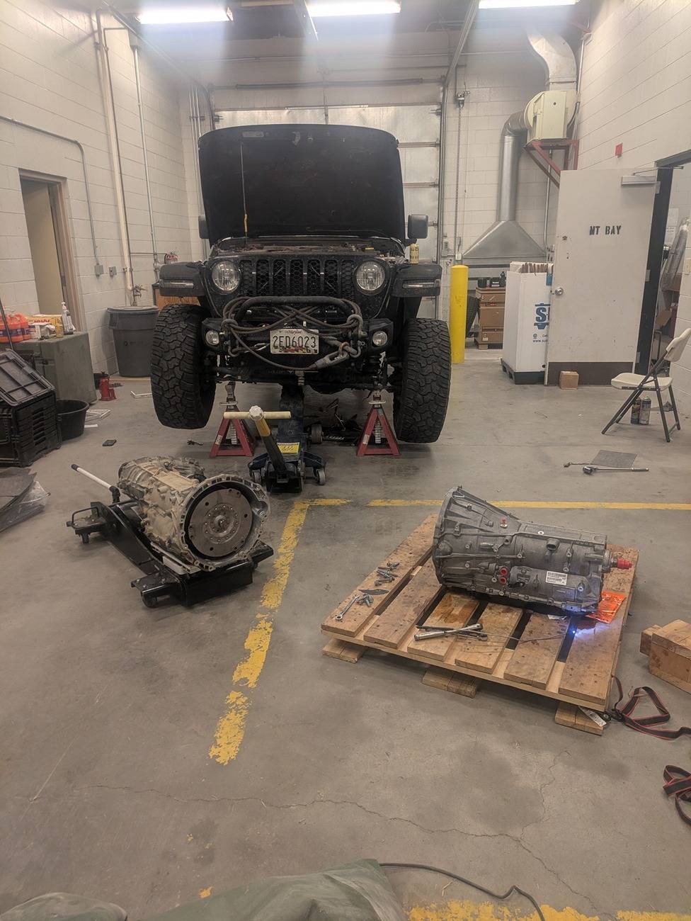

Gentlemen it is my pleasure to report that hitting the ole switcharoo with the transmission has resolved all of my issues and it was indeed just as plug and play as everyone made it sound.
They just called said it was done ..✔ lol ..but I cant tell ya anything till I get it picked up later this evening . So excited 😊 🤗

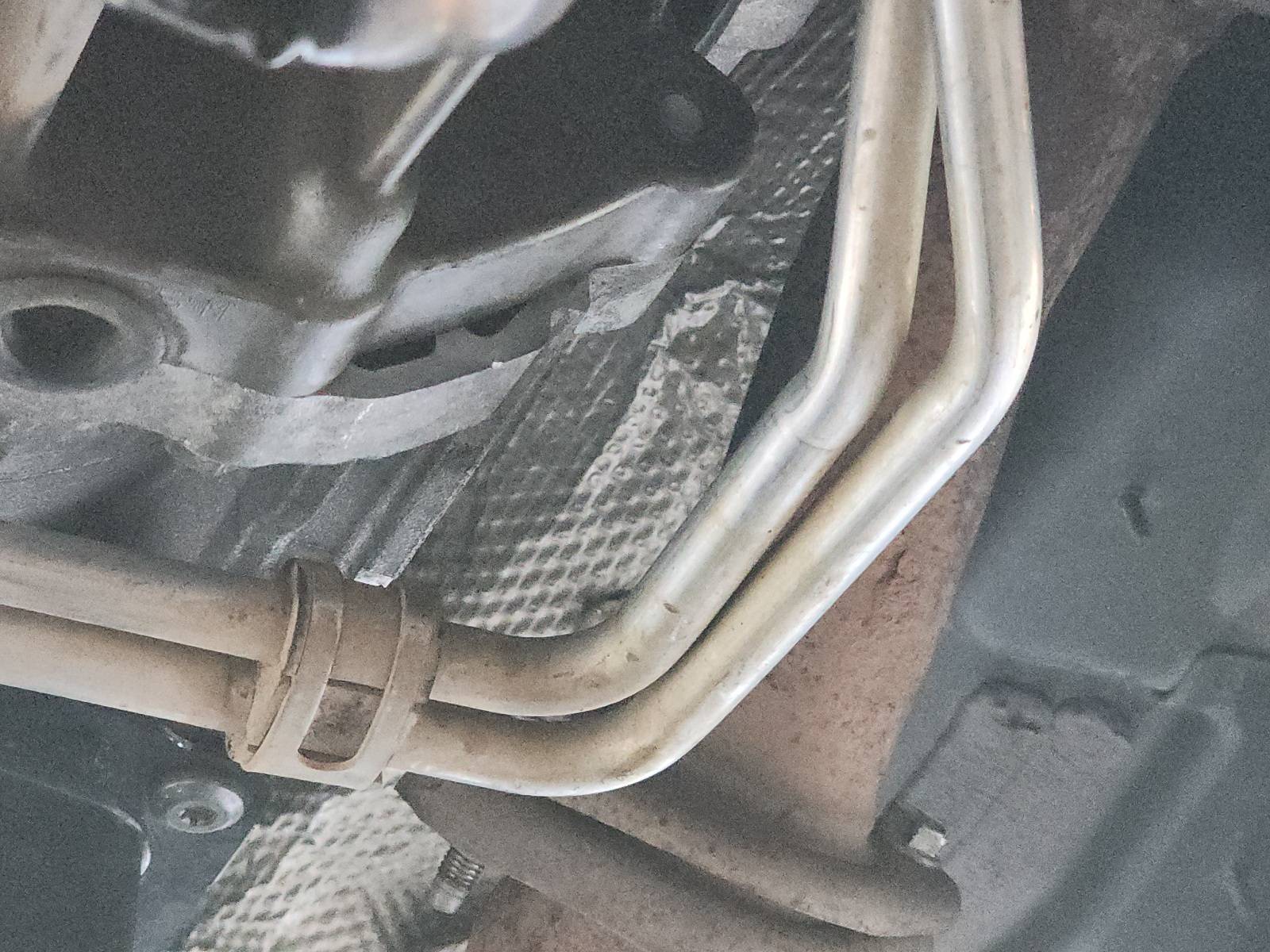

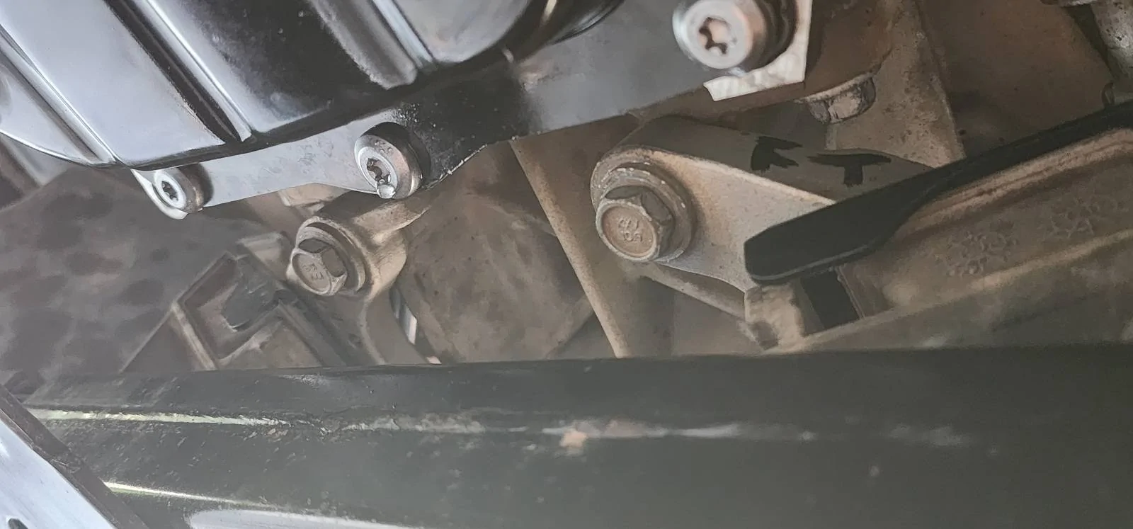

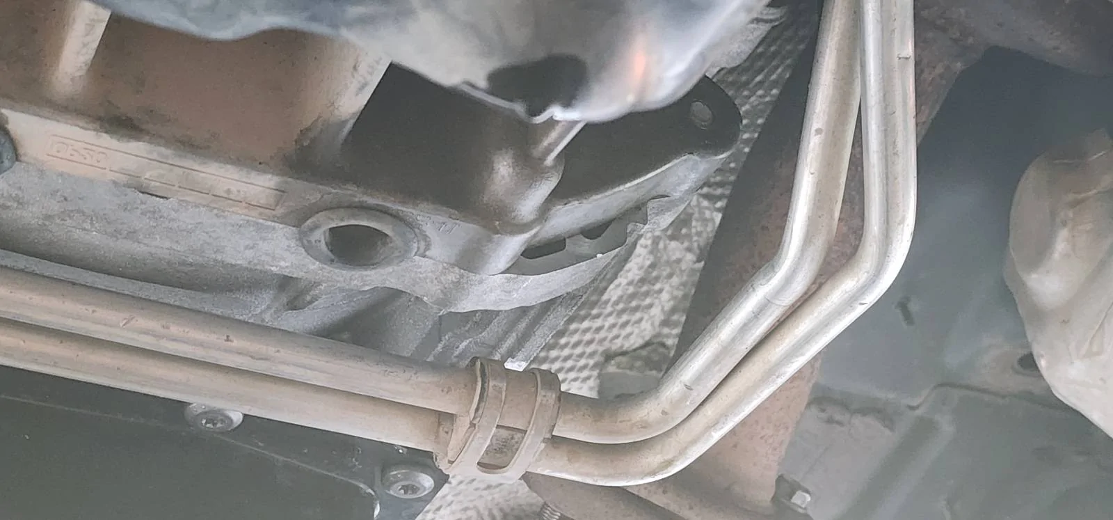

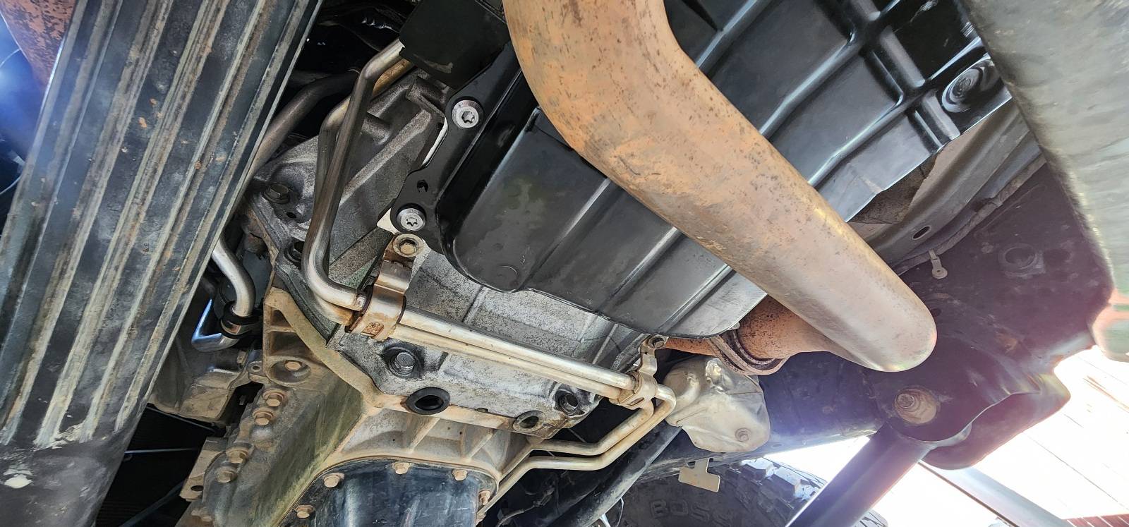

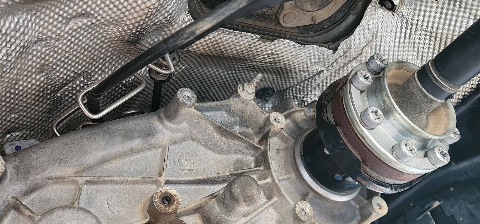

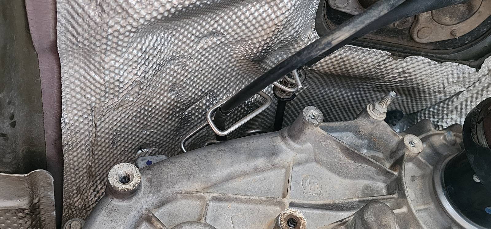

So I supplied all the fluid ,Filter and transcooler , and it looked as though they only used 4 quarts of it 😑 I am gonna call and ask why they didn't use what I supplied . But they seemed to have replaced several brackets and said the gasket I supplied wasn't very thick so they used their's 🤷 🤔

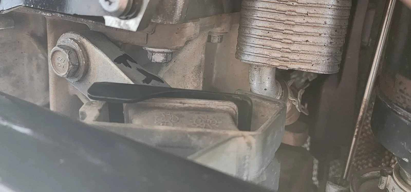

Also the 24 seems to have a slightly different shape on the case . Leaving 2 small holes . Wonder if these should be Silicined to prevent water and dust intrusion? Or will this allow it to cool off some 😂🤷

Okay checked the fluid level after running the gears did it twice and then let it idle temp was 120 and when I took the plug out it came out the hole with the engine idling
