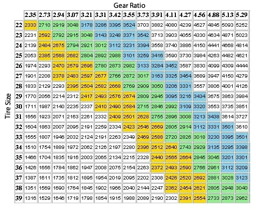

Re-gear. It makes all the difference. I roll on 35s with 4:88s and it's fun to drive.

with 37s you need 4.88 min . i would go 5.13 WOW with the right axle gears your mileage will improve to 20+ . 20 plus years in jeeps 4.10 are for 33s 4.56 for 35s and min 4.88 for 37s for max efficiency . The 3.6 has so much more power than the old 4.0s
What would you recommend regearing with a 6 spd for someone who hardly ever drives highway. I don't really ever need 5th or 6th unless I go on vacation hitting the interstates.

Stock stick rubi gears, should be 4.10. I’m on 37s which obviously doesn’t help. Reverse is way too tall for towing, and 5/6th have no purpose anywhere with hills. Towing or not. I usually get the same ~16mpg just staying in 4th as I do going up to 5th and at least in 4th it can maintain speed uphill.
lmao...the one mod you should do before you consider the swap you haven't done yet, the gears, you need to be 4.88 minimum or 5.13's on the max end
i ran 37's on my 3.73 sport gears for awhile and it truly sucked, now i have 4.88's and it's a stump pulling little beast, the difference is staggering, on a steep driveway before, or bumping my trailer up onto curb in reverse, or getting started in 8" of crusted snow....basically any challenge to the traction of the tires and you almost needed 4-low for all of that with the stock gearing, but now with 4.88's my rig will chirp both rear tires from a dig on a steep driveway and just go...night and day difference, i didn't realized just how important or effective the right gearing can be, now i don't even need to touch the gas for just idling around a parking lot or in the alley or a drive through...just let clutch out slowly and away you go on idle alone
anyway, put your money there then sell it if you don't like it and get the auto, and do the damn gears with it also
you won't need a supercharger if you do the gears, i did magnaflow street exhaust so i can hear the engine better with the manual and it's like driving a sports car now with the gearing correct, i holeshot people all the time, it snorts, it will chirp hard going into 2nd if you jump on it in a hurry, anyway, it's faster and zippier than when it was stock now that i've done 4.88's and it changed the driving dynamics, i've now got a full hunting season behind me and it was fantastic offroad to retrieve animals and also cruising some new areas in forestry, haven't needed 4-low yet since the gear swap
further to this i now can use cruise control on the highway and hold most hills in 6th at 75-80 mph no issues, couldn't even consider that with before gear swap, in 6th at 75 mph i'm a little over 2500 rpm at 80 mph a little over 2700 rpm. All gears very useable now. 1st gear is so short you're only part way into an intersection before you're shifting into 2nd. Anyway...get the gears done ;)

When I change to 35s I may end up having to regear to 4.56s if I can't stand it. For now my street tires are 33s and my wheeling tires are 37s. I'm getting them mounted tomorrow, so I can't speak for how shitty it will be on the street or the trail, but I can't wait!
