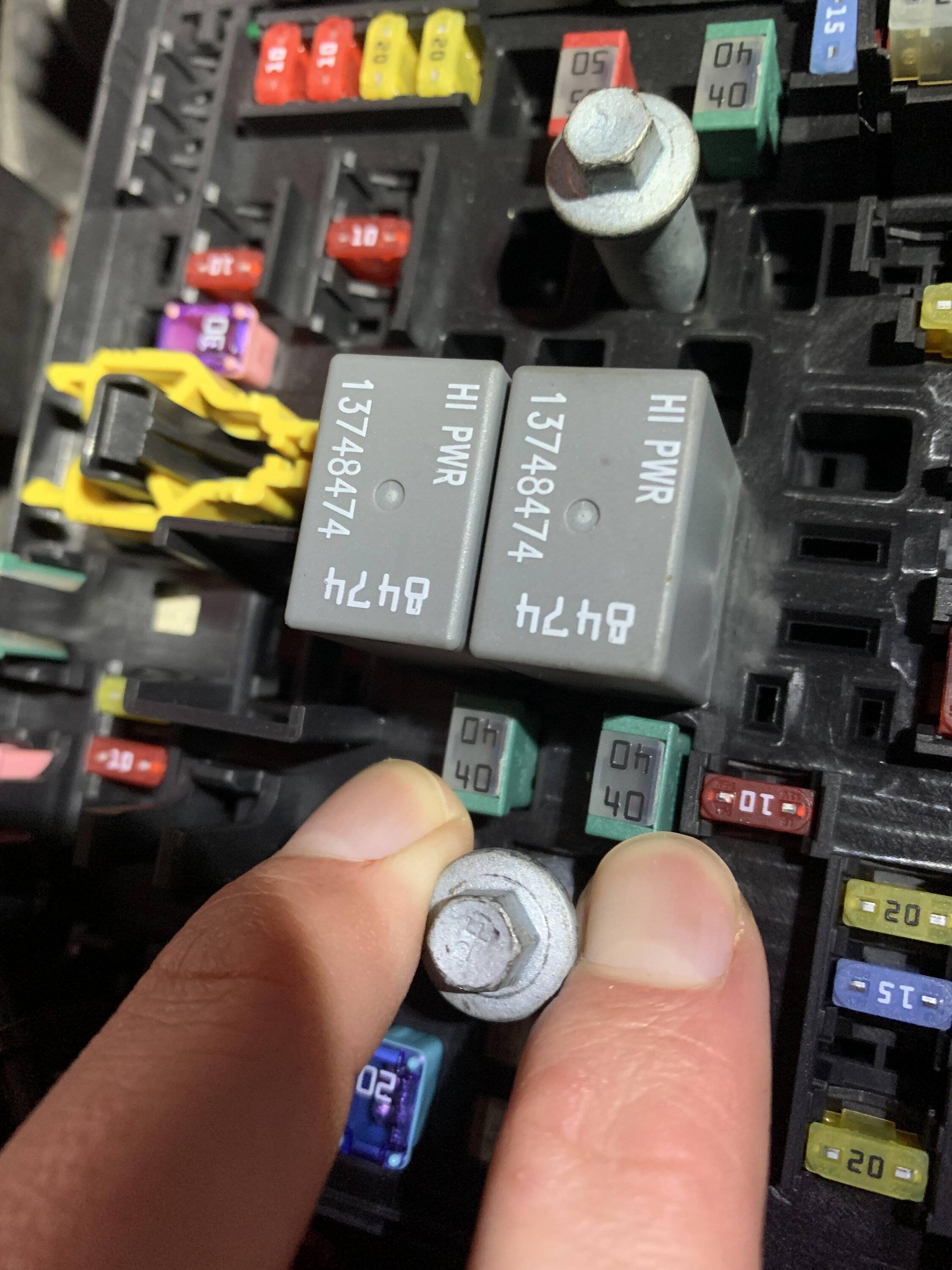

Reviving this thread since I just recently had the same problem with factory installed aux panel - My aux 3 and 4 buttons had no power to the leads under the hood in the wire loom, so needed to find the two 15A fuse locations, and had a hell of a time, even with all the the links, and the fuse box lid chart isn't labeled simply "Aux 1", etc..... My local dealers parts guy was a champ and then I verified with the ol multimeter under the hood:
F- 92 = 40A
F- 93 = 40A
F-103 = 15A
F-108 = 15A
Jeep Gladiator aux switch fuse location 15a fuses
